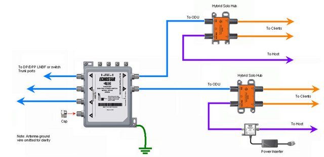

I found this digram but not very clear when zoomed in and not sure how accurate it is.
would perfer a digram with clear labels of the hw and swtich the need, I think it DHP42, 2 hybrid solo hubs and power inserter? that would be needed for #1 hopper 3 + 4k jeoy , #2 hopper 3 +4k Joey if i reading the digram right and it is correct
Im thinking if that is the stuff needed they gona need to put bigger junction box on side house to accommodate all this, it not all gona fix in that junction box.
Would really like have as much info as possible on how this done and what is needed, before the tech comes 10/15/2018 cause I really think they gona send someone that never done let alone with correct stuff needed. Dish has horrid habit of not give needed notes to there tech which what cause my last issue that took me 3+ months to resolve them not wanting to credit me for month of no serices at the new house cause they didnt want give notes
See Posts #255 and #287 in this thread. It may help you.
Thanks I have bookmarked all that, and when this guy comes I point him to those posts if he has no clue, I just need to fiqure out where i gona put this 2nd hopper 3 I kind out places :coco
