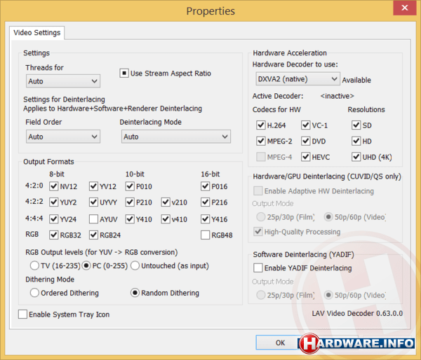

Well, i have never been able to play the UHD video without it playing in slowmo with some herky jerky.
I pulled the trigger on a new video card that was supposed to support the HEVC H.265 codec. I found the settings before i ordered it. I just installed it, and am happy to report i can watch all the HEVC UHD channels on 103w and 105w. They play PERFECTLY. I still don't have a UHD TV, but still, the picture is quite crisp and remarkable, even on my 1080i. I am playing it through DVBdream and my USB TBS 5922.
I will eventually make the upgrade to UHD on my TV, but i know i also would have to upgrade my A/V receiver which also doesn't support UHD.
Radeon Rx 460
With DVBdream and the following settings :
