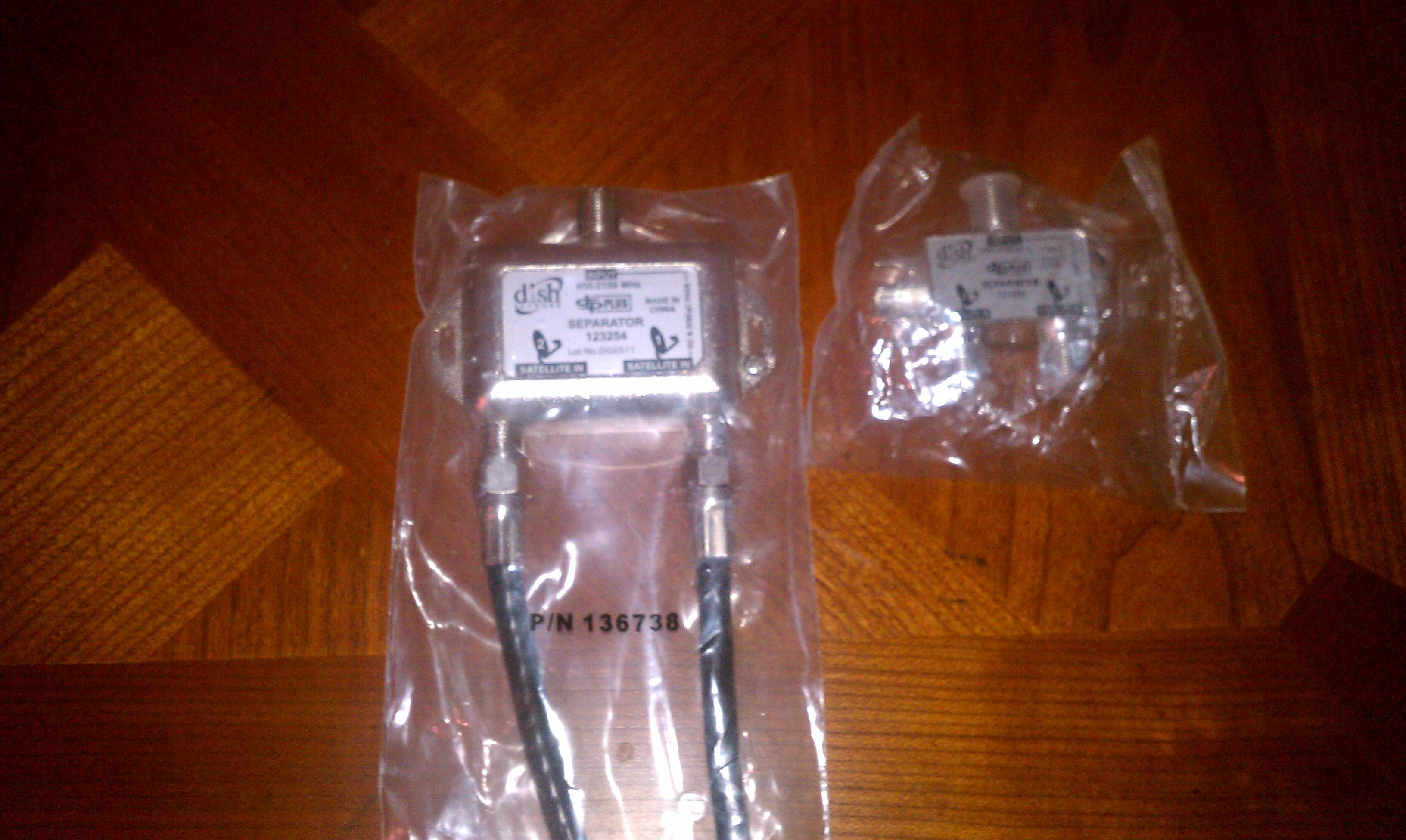

I have two DPP Separator types (see photo) Both types were received with my 622s. It's been a while, but I seem to recall Dish stopped using one because they had problems. Not sure if this was true or not. Somewhat odd is they both appear to have the same part number "123254" although one is twice the size of the other.
Anyway, which one should I use?
Thanks!

They built the separators in two sizes. No functional difference.
Emphasis on using a separator not diplexor.

They are both 123254...do you use the one on the left or right?
Sent from my HTC EVO using SatelliteGuys App
I can't see the mounting ears on the right one, but mine is not the one on the left. The mounting lugs on mine are heavy cast parts of the frame.
