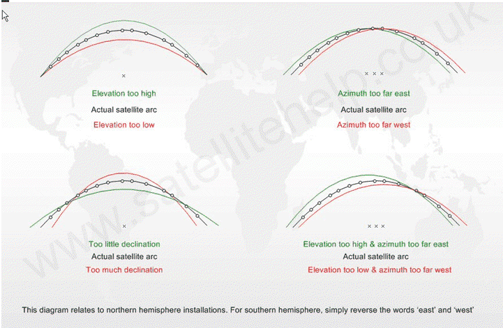

Turbo,
Sounds like some very positive progress! Maybe just a little off on azimuth or a little too high or low on elevation. With most of the sats coming in at 90%+ quality, you surely cannot be off too much. Just a little bit of tweaking can probably fix 72 and 129.
Maybe the image attached will help you in some way.
Gordy
Good luck

Thanks, I have that pic also, just a matter of getting back on it. More storms and rain coming tonite and Mon so I will wait a day or two. Discovered my 'shimming' of the motor's shaft to the pstar mount is not secure enough either, I found I could actually twist the dish/mount on the shaft using both hands and not much effort, but I already came up with a better way of doing that too. Right now, I'm resting, and happy that OUR Navy has rescued the merchant marine captain from the pirates!!!
