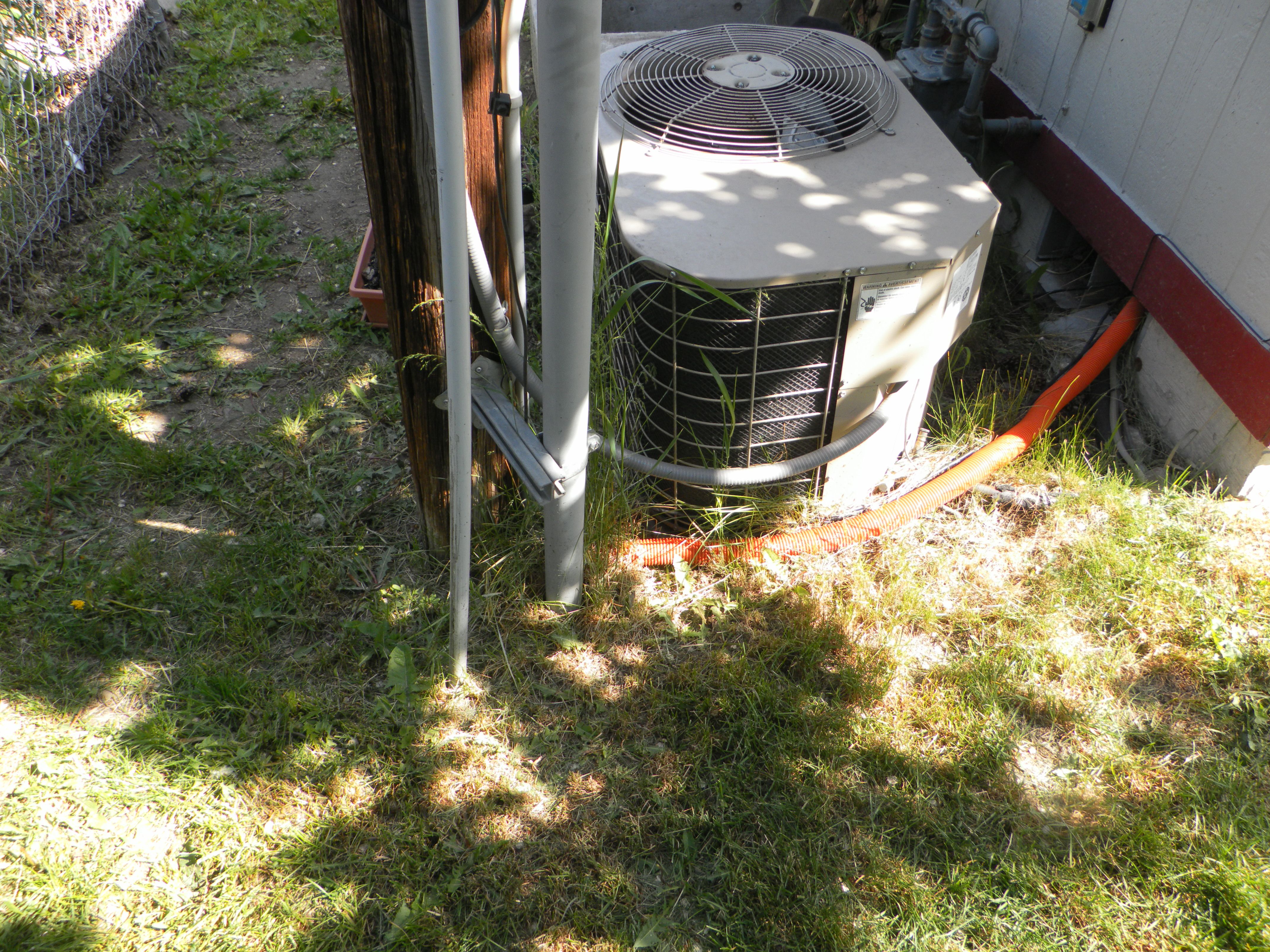

I discovered last week my need to replace my utility service pole is quite urgent. I have been talking to people about it for a couple of years. But I never heard anyone say anything about having it done or who does that. The job will be very hard labor. Because of all the things in the ground close to the pole it will need hand dug and the ground is insanely rocky right there and big rocks too. The original pole was installed by morons. I'm surprised it's standing this long,17+ years. Well you would think I could get a half dozen bids on the job with all the electrical contractors in the book, but after talking to the ones that answer the phone and those that returned my calls I got only two guys to look at it and not one bid yet. Yikes! This isn't going to be a happy ending, but I probably will pay for it. ;) I can't think of any other kind of business to call and get that kind of thing done. There was a time I would have done it myself but not anymore.

The way it gets done is the utility companies come out and take down their drops on the pole first. then the pole is replaced and then inspected and services reinstalled. There is electric, phone, and cable to the pole and the meter base is on it as well as the phone and cable terminal boxes. My AC condenser/compressor stands next to it too.

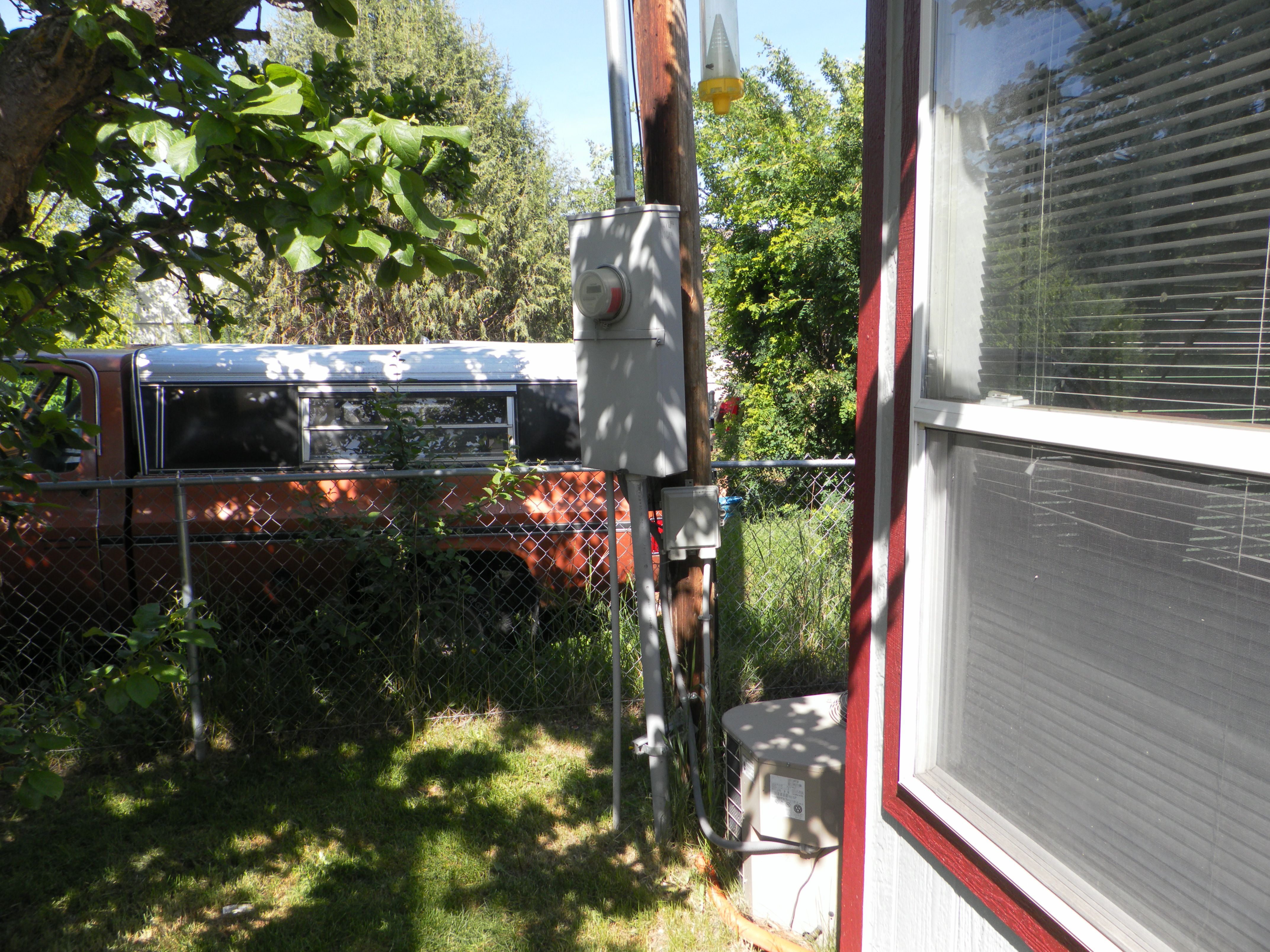

View attachment 116763 View attachment 116764
Sorry you might have to go to such expense. Whats wrong with that pole? I'm no expert but it doesn't look nearly as bad as some i've seen out in the countryside leaning at a 30 degree angle. To me it looks like the pole is definitely part of THEIR infrastructure so their cost. I disagree that their point of demarc should be the top of the pole .... It should be at the meter. Just my humble opinion.

There almost isn't any pole left underground. All rotted. The replacement has to go in the same spot or you have to change all the services from the pole into the house. The electrical stuff ain't cheap.

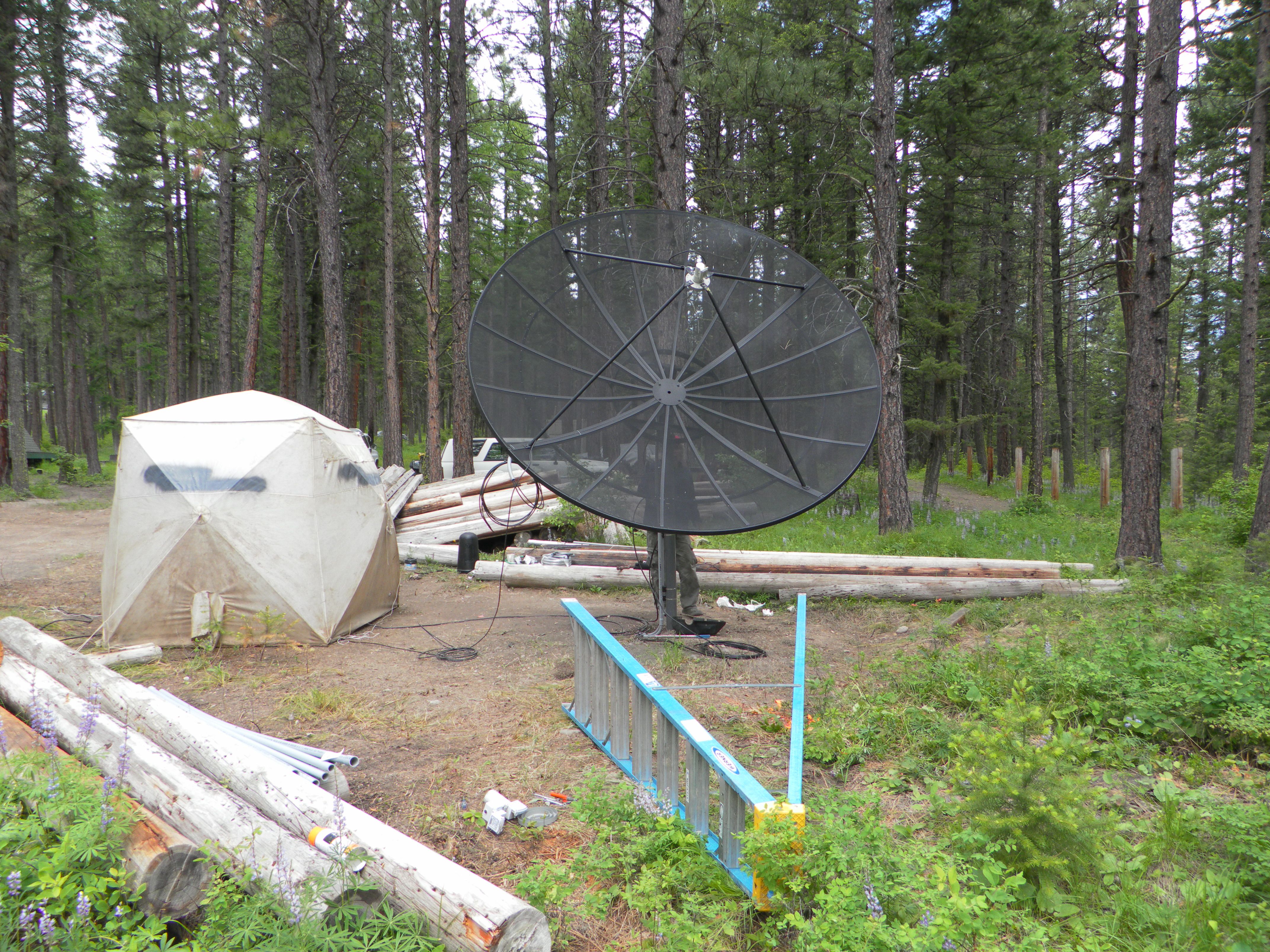

If that pole came down on its own, it would pull the drop across one of my C-Band dishes. Not what I want to see. I was hoping to get it done for $1500 including the pole. First bid includes a 24' 6"x 6" pressure treated green post.
After a little investigation on this job I found a real "gotcha" in here. My meter base and installation isn't up to code. It all needs replaced. No S**t Sherlock. I felt it needed replaced a day after the idiots put it up. What I can't figure is how they got the inspector to pass it. Of course nobody was going to tell me about this until the power company goes to hook me back up and it won't pass inspection. And then the bid just went up another $1500.
