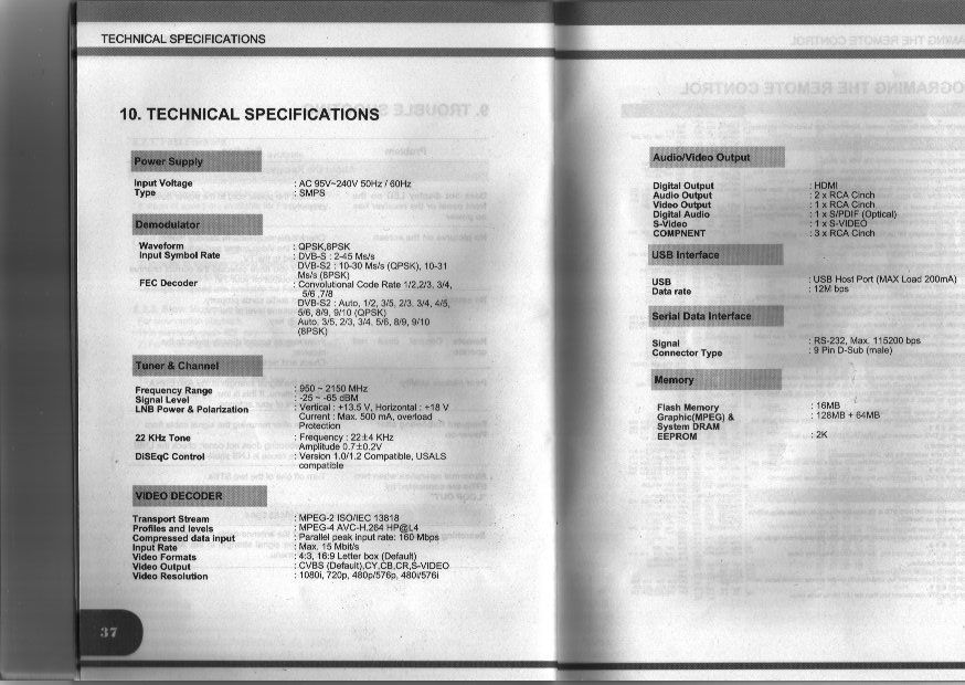

I would be much obliged to any of you kind people who would take a look at this spec sheet from my owners's manual (attachment) and advise me as to why I don't get DVB-S2?
Is the spec sheet wrong or is there more to this story?

Spec's say it should be able to tune it.
Which Sat/ TP are you testing it on?
You need to enter all the TP info for DVB-S2
In the Manual TP setup menu, do you have options to select:
DVB-S2 8PSK or DVB-S2 QPSK
Pilot: On / Off

It looks like the spec sheet and reality are in conflict. My receiver won't get Montana PBS any more and wasn't ever getting NBC on 103w.
I looked for options like 8psk and pilot but my receiver does not display them or allow them to be changed. The transponder menu just has frequency, signal rate, polarity and error correction mode.

There may be some hope! There is a plug in module called the SK200 8Psk that is used to get s2 on your Viewsat Max HD.It looks like its a option and yours came without it.I dont know how good these modules work but do a google on sk200 spsk for more info.

The maxhd will not do dvb-s2 with either the factory tuner or the aftermarket add on module.
