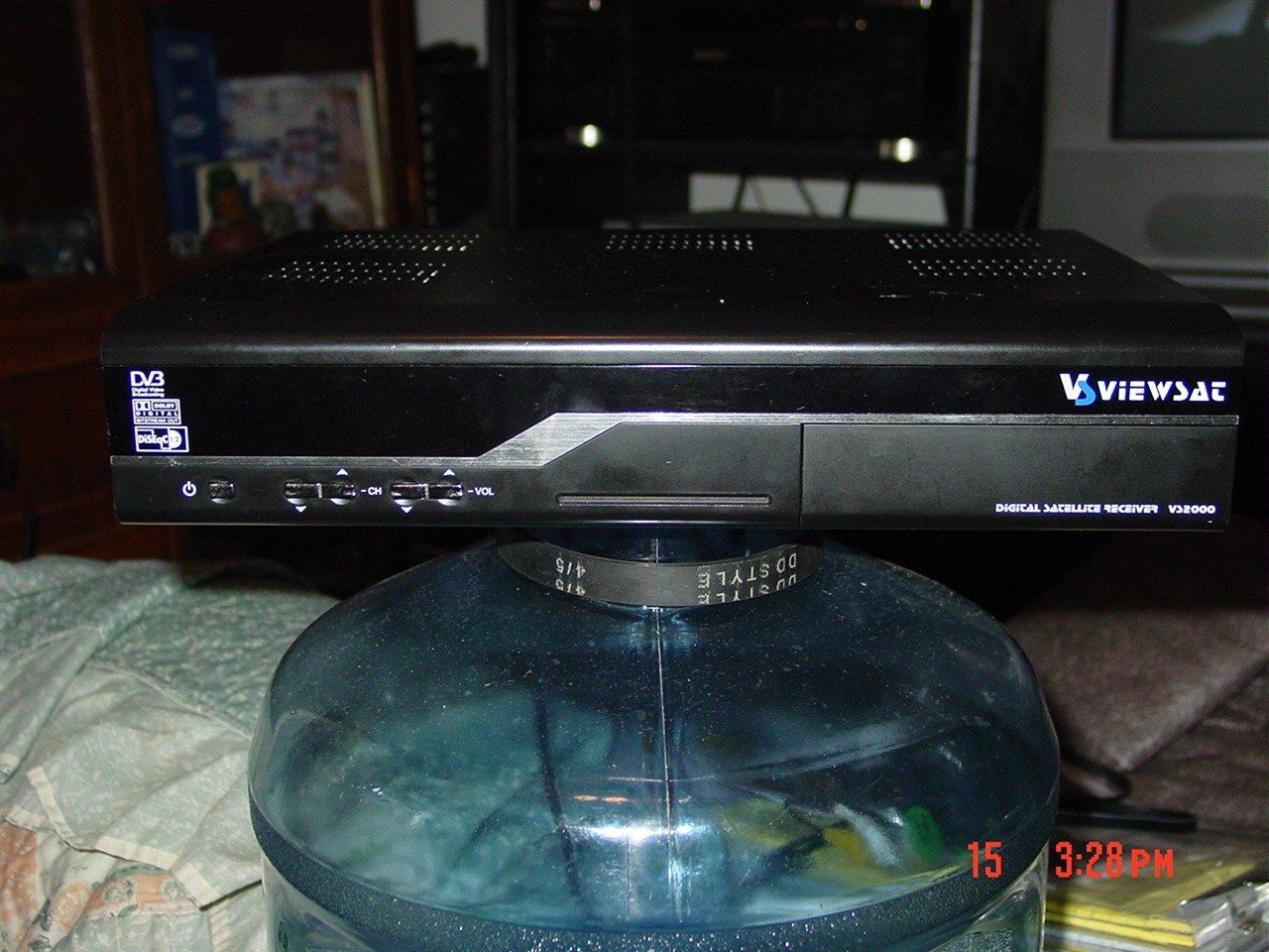

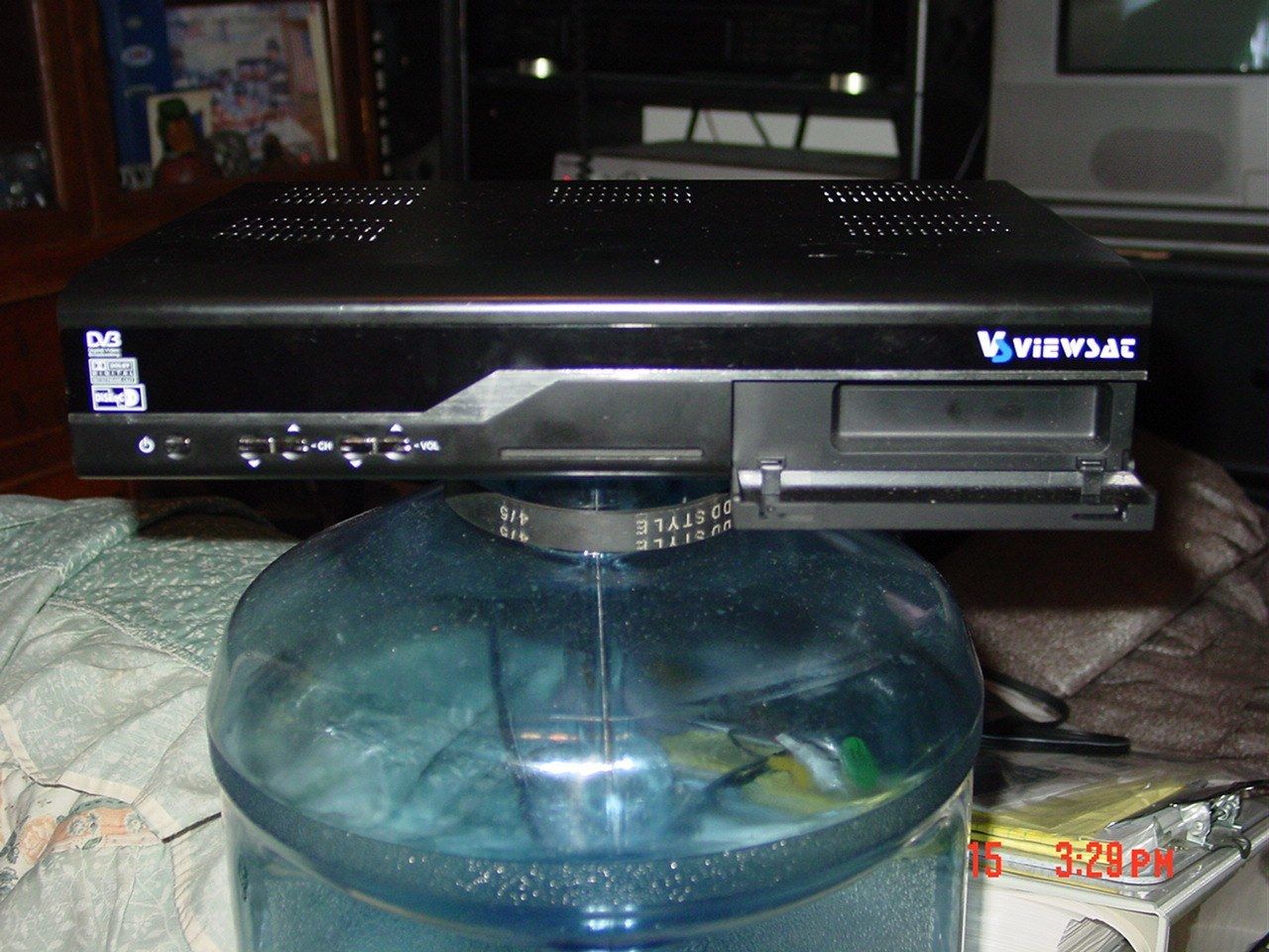

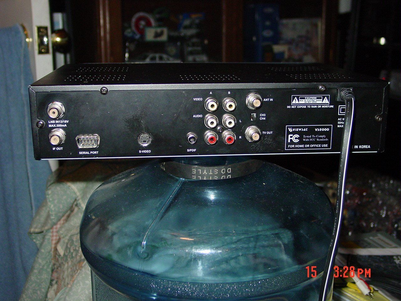

this is what is on the back left to right....
LNB in , IF Out
Serial Port
S Video
Two A/V outs
ant in tv out
no master power switch
hard wired AC cord
see pic's

I cant tell from Iceberg's pics if the original has a switch or is hardwired. That is not an Extreme, but could be the original, or possibly a clone of one. I am basing that on no component out or optical AC3 connection.
Either way it is not an Extreme so the FW I'd try would be the factory Platinum/Lite version. It is available on the Viewsat home page.
You may get lucky and it will boot to the rs232 scan routine. It is possible the previous owner confused it with an Extreme and tried to write that FW to it.
thats the original
the Original Viewsat had NO switch on back
