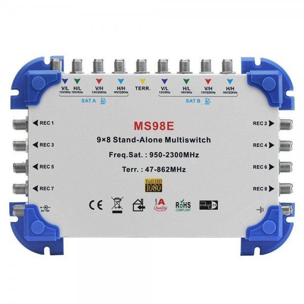

You could also get something like this:
This puts everything into one unit like what Fred did. I have never used a unit like this myself, but always wanted to. They are kind of pricey, but maybe easier.

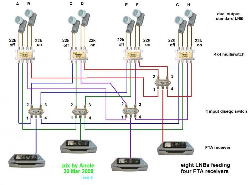

so i got some info and well i guess i only can do what i want only if i have dual output lnbs. which i dont want to buy. pic i have uploaded looks like the setup i want but need dual outputs.
hey that would work too. got 8 outputs and looks like i can hook up four lnbs. i really didnt want to buy dual output lnbs tho grrrrrrrr
Yes, you will have to replace your LNB's if you what more than one receiver.
i have two titanium c1-pll and one titanium dual. will soon have another dish with a dual. so in the end i will have two dual and two single
I'm running 4 Titanium dual output LNB's with 4 BUD's. I will use one output from each of the four dishes to a diseqc switch, and the other four to an additional switch for the 2nd receiver in the dining room. I will be receiving channels from 97, 99, 101 and 87 West for now. I locked down all the dishes except the dish pointing at 97W so I can look around on other satellites to see what's on them, or to watch programming on a different satellite without installing a 5th dish.
