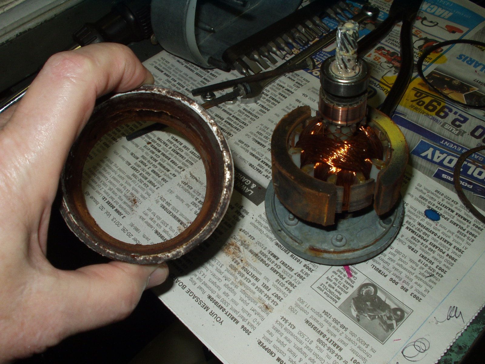

One of the two spare Von Weise dish movers I have developed a problem some time back when I tried to use it on that Unimesh dish. It was REAL slow and was making some noise I hadn't heard when I went through it a few years back?
Fast forward to today and I got that thing out, connected it up to the Vbox and ran it again and again it was REAL noisy. Hummm, didn't sound like a bearing and I know it wasn't making ANY noise like that when I went through it so on a long shot I pulled the motor apart and here is a picture of what I found, which I had suspected was wrong with it BTW.
I've got an idea about fixing this but I'm interested in hearing what others might have done that was successful for this type of repair?

The visible bearing and pinion gear look fine. If the hidden bearing (or bushing) is okay, it should be salvageable.
A good brushing of the rotor and stator should silence the scraping noise of rust-on-rust.
production of von weise motors has all been moved to other countries The laninating machnew I service use von weise
Wow. I never seen that one before. I think the hard part will be to determine where the magnets belong, so the timing of the motor commutator is correct. I suppose some good epoxy might hold them.
Delam of the Permanent magnets from the case. Seen that only once before many years ago.

Yeah there's some left over cement inside the housing that I can go by to put the magnets back in. Just a question of what to use and BTW, I've seen this before on another "spare parts only" Von Weise I have and also on an electric water pump on my race engine.

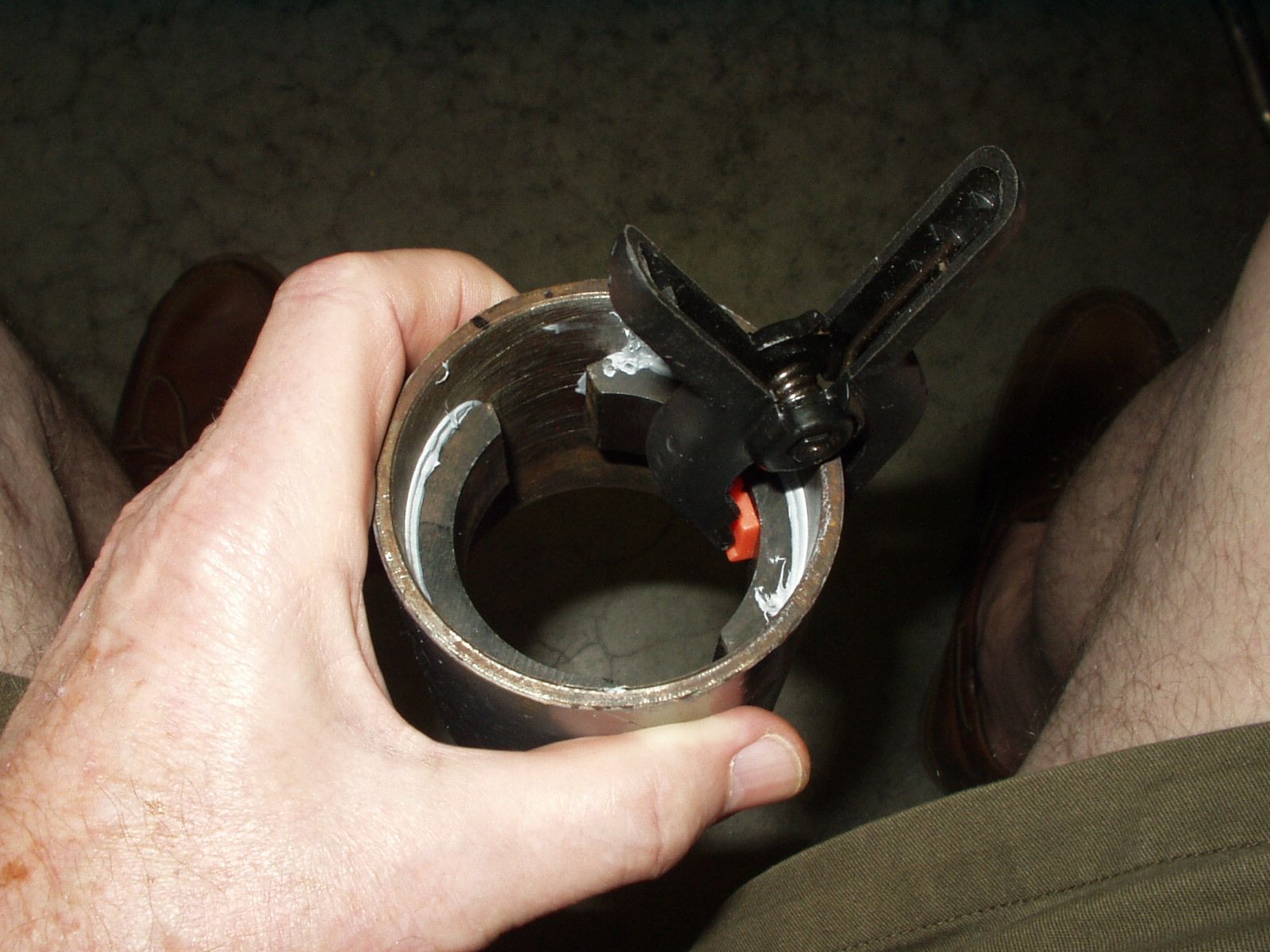

Well, after reading the comments here and thinking a bit I decided to try something off the wall. I've done all my auto repair forever and also build my own racing engines and transmissions and I've used different kinds of RTV over the years. When I overhauled the trannny in my Geo last year I got some of that gray stuff that's suppose to be a gasket maker and having used that stuff I've found it's tough as nails and twice as sticky.
Having said that, those magnets are re-glued inside that motor housing with that stuff right now and after I let it setup for another day or so I'm going to give it a try since I got nothing to loose but time and I already had the RTV in the tool box.
This dish mover will wind up on that 10.5ft Raydx dish I picked up a couple of weeks ago so it will be getting a workout soon since that dish is now on the temp mount and waiting for cooler weather before I do any testing with it.
Here's a pic of what that motor housing looks like now.
UPDATE: Put that motor together yesterday evening and it works like a charm!! Quite as t church mouse now. I spent about 20 minutes running it back and forth and it seems to be a keeper at this point. Of course time will tell whether those magnets stay in place or not but having used that RTV on other things and having to drive a screw driver between parts to break that seal I'm fairly confident it will work.

Yahkee that RTVd one is still mounted on my Raydx dish and working every day! Just remember though that "your mileage may vary":oldwink!
