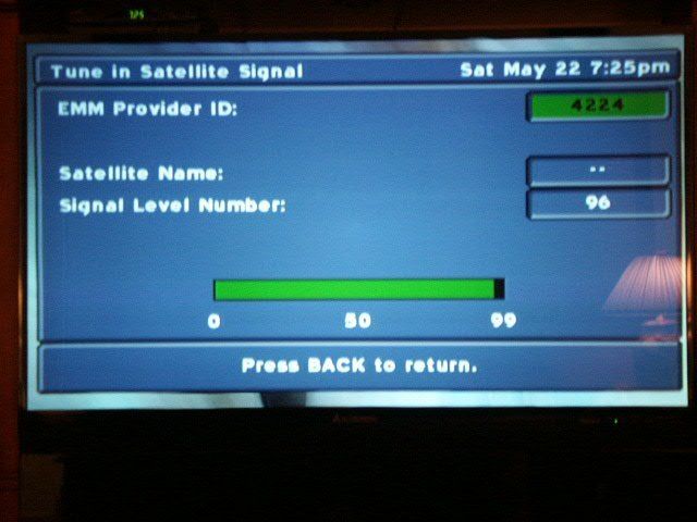

Signal came up after over night download ! 96 !
There is a BIG difference between the new software (5.68) and what we used to have. Now with an equipment shortage that is delaying installations for new subscribers, I would guess that new Motorola STB's would come pre-loaded with 5.68. That would be a good thing. Of course, I'm just guessing.
