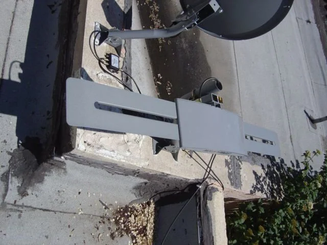

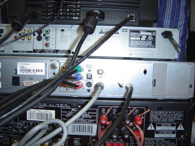

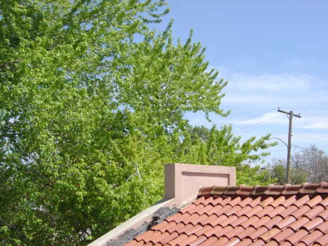

My Voom was Installed on Saturday May 1st. A company called Datcom installed it for me. This was the 10th dish this person has installed so i was really optamistic that the install would go smoothly. It took roughly 2.5 hours from start to finish. As a few of you know I've been really worried about line of sight well included is a picture of where my dish is pointing, it was CLOSE! At around 1:30 the installer calls voom to activate it. within 5 minutes i had tv! I noticed a few things weren't right but i knew I could fix them so i signed off and the installer was on his way. After he left i took the composite cables out and used the component and unplugged the antenna cord out from the tv and went to plug it into the voom box, nowhere to plug it! i'm 99% sure my reciever didn't come with the card. Check the pictures attached to verify for me? I called voom but they can't be there till next monday so no ota for me :( Also checking my antenna it isn't shaped like a "V" but is straight is this a stealth antenna? Now to my thoughts on Voom. It isn't as bad as I thought it would be. ESPNHD has been wierd but most of the other HD channels have been fine. SD channels on the other hand look terrible. The guide isn't that bad. IT seems after the update it got a lot better than in .06 All in all I'm super happy with Voom and i can't see what they have in the future
Yeah, you're missing the OTA RF module (or whatever it is called) on your STB. It plugs into where the plastic cover is.
Also, the antenna isn't the stealth antenna. Not sure which one it is, tho.
-John
Quincy,
your OTA module was not installed.
Update on my install. So the installer came back out today and replaced with a new receiver and this made no difference with my signal strength. So he walks out on the patio and looks at the dish and goes maybe its hitting that Palm Tree. He then gets an extension and adds like 1 ft height to the dish and boom signal jumps to 86.... So after the numerous calls this weekend to Voom I think I finally have it all working..Going to give this Voom service a try for a week or so and then I will cancel my cable..
