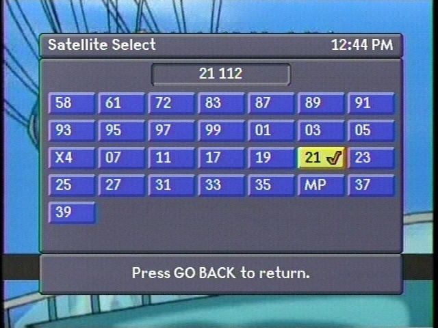

Did the A4 and satellite names the way I outlined in post #17 of this thread. So far I have found one problem and I don't have the slightest ideal of what's going on . I don't know if it's the maps, A4 did not install right or it's normal.
Satellite T7 (21 in my satellite list) channel 111 (Momentum) shows as Please wait a moment we are processing your request. If I do the options 6 4 4 info the channel plays. Authorization shows as MS Missing Service Status.
With the satellites numbered the way I have them you can not use the alphanumeric buttons to call up a satellite. I have to use the sat button and select from the list.
The guide still works

I checked and that is the way it is right now.
Someone at the uplink changed something and it appears as MS even on commercial equipment.
You did everything right.
Hope you enjoy your new set up as I know you spent some time doing it the way you wanted.

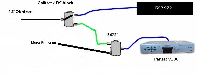

I have KU on the Big dish but use a 1 meter Primestar dish for KU (see attachment)
I think that's right anyway you get the ideal.
I'll sent you the file.

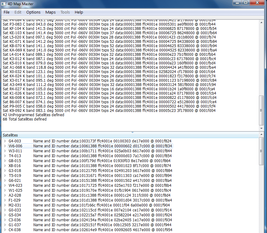

hello all
O.k. first thing on my mind is thank you mapmaster programmers for all the hard work. Now i have done all the battery mods to my dsr920,dsr922 receivers, less the 2 that I send to glentech 1 donated and 1 for update but now has some tuner problem(hmm was working ok with hits) but anyway have decided to try to update my maps myself. i am somewhat confused with the process. I have already backup my nvram(all six bin files with usbjtag program). copied the nvram into the mapmaster program and started the process.... 1. loaded nvram.bin 2. Display Combined Maps(i get a window for output file) do i rename the output file? or do i select the new maps. As you can see on the second photo it shows txt files, 1. the 9_New Motorola Maps and a 2. nvram.txt file i saved. I did previously justed saved the file as nvram.bin and then reloaded the maps command then load the master maps. when i finished i used usbjtag to write the file but the dsr920 had no changes,. loadnvram.pngChooseTXToutput.png
Ifound this else where and is what I used.
1) you should have already downloaded the nvram from the receiver and saved a copy... right????
2) go find that copy and make a new copy of it in a folder.
3) from the web site where the files are located download #9 "New Motorola Maps" to that folder you just created.
3) open the map master restoration program and click on "Maps"
4) then click on load bin file.... find that COPY of the nvram you just made and click on it.
5) Once loaded then click on "MAPS" again but now you want to click on "Load Master Maps"..... then
6) locate the file you downloaded #9 New Motorola Maps and click on it.
7) once you have done this now rename your new file to something like "Test_1" and save it.
8) now go back to the Jtag program and send this new bin file you just created as Test _1 to the 4DTV.
9) follow the Jtag instructions (0_L_4DTV BDM print out instructions.pdf) to send it to the receiver and the proper shutdown procedures.
10) you should be done..........
Hope this helps

o.k. done 1-4 will follow from step 5. so i dont have to rename the new file as nvram.bin?
well guess now i have to wait as my mapmaster program is now crashing in windows 7. I installed usbjtag on a windows xp laptop but couldnt install mapmasters.......back to the drawing board. Mapmasters program is now crashing when i select load master maps.
1) download the nvram from your receiver.
name it whatever you like but keep the (.bin) extension.
You want to keep this saved somewhere so do not overwrite this particular bin file.
You can make a copy of it and move it to another folder.
Personally I start out with creating a folder where I save these bins to. With so many receivers I name them according to their receiver numbers like 6051 which I know is in one of my receiver id numbers.
2) once you are done and have closed out of the jtag program then you want to proceed to the map restoration program. I have it loaded on windows xp and windows 7 machines here both 64 and 32 bit machines and they work fine.
You did remember to follow the instructions and download the dll files you needed to have in your computer right?
once you have the map restoration program set up and if it is not then you do not have something correct on your end as I have tried it on several different computers here and it does work and no one else appears to have a problem so take a step back and make sure you followed all the other installation instructions for where to place the dll files needed.
If you still have a problem then maybe the programmer can give you a bit more advice.
I only noticed a problem when I first started out and I had the only 64 bit machine in the group... I could not get the program to work and it was found to be a dll file I needed. Once I had it no more problems.
So after you get the MM program operating....

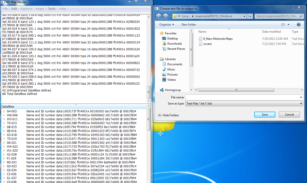

then click on load bin file.... find that COPY of the nvram you just made and click on it."
then go to maps> display combined maps .... and save as a text file with a new name.
so If I download with the jtag program on a receiver I call 6051 I might name my original nvram as >> orig dump 6051.bin
This is the one I look for in the mm program to do a display combined maps and I name that text file 6051 test 1.txt
does not matter what the name is as long as you know what your doing.
always try to keep them in a folder you created so you know where they are all the time and do not forget.
now from here while you are still in the map section of MM program... remember that #9 maps you saved? well while you are still in the mm program with your original nvram in it go to maps>
load master maps>.... then find that #9 file and click on it.
MM restoration with do it's thing and it will ask you to name the new bin it just created so name it something like resend to 922 1st time.bin and save it to your folder.
This is what you will send to your 4d with the jtag program again.
If you dish is a dish mover and connected to the dish remember to take the nvram out and put it back on the same satellite so you do not lose your position of the satellites you were on.
do not rename it exactly as the name you took it out as, since this will make things confusing.
You never want to lose the original nvram.
I hope I answered everything for you, if not just ask.
