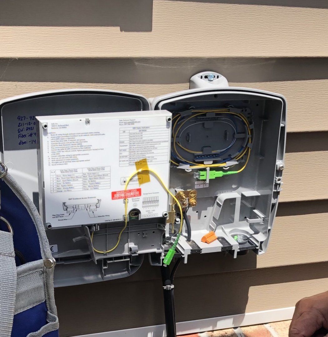

Basically it's a fiber-optic cable drop line from the utility pole to the home where it first connects to a device called a "slack-NID" where the fiber cable is switched from an external type to an internal in home one.
Then from there it's an internal fiber type to an ONT which converts the fiber-optic light signals to ethernet electrical signals. Then from there it's by an ethernet cable to a gateway device, usually either an Arris model BGW-210 or Pace 5268AC. Where in a FTTH installation only functions as a router and WAP (if chosen) since the "modem" function is actually preformed by the ONT which is a physically separate device from the gateway.
And then finally from the gateway is the interface point to the home LAN network.

They'll mount the slack-NID box either somewhere outside or inside the service entrance whereas the ONT must always be inside as it's not weatherproof. And the battery backup for the ONT is only given if you subscribe to AT&T's VoIP phone service as well.
Not sure why AT&T does things in such a backasswards fashion. Pretty much all other fiber providers combine the NID & ONT outside the house, and a cat5 cable running inside carrying ethernet.
Running fiber through the wall of your house makes the installs more difficult and time consuming both for them and the homeowner. I wonder who made that brain dead decision that was how they were going to do things? It makes no sense at all, I can't see a single possible advantage to doing it that way.
IIRC, the scuttlebutt circulating on the AT&T forum a number of years ago was that AT&T wanted to go in a different direction on this. Where current hookup was to be only an interim topology, and to eventually integrate the ONT into the gateway itself.
So it would be fiber all the way to the gateway. ...
But I've yet to see any evidence of this or any other new gateway models available for that matter. Just the same old Arris BGW-210s or Pace 5268ACs ....
