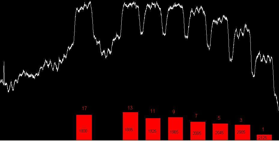

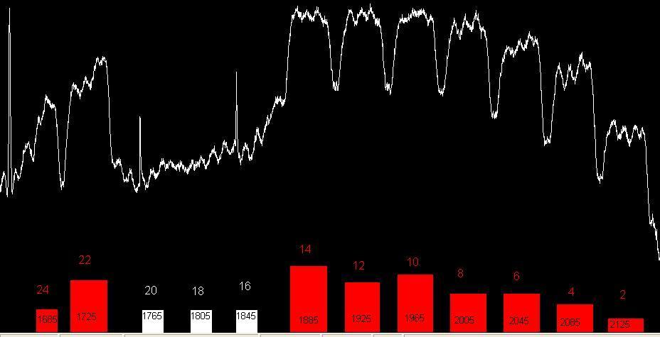

Oops !
It should be BELOW 2150 MHz, ie 1650...2150 MHz with inversion.
Look at my spectrums of IF after BBC.
White bars shows missed tpns, red numbers - tpn##, black numbers - IF [MHz].

Exactly what I said. In fact you quoted me saying that the A-Band and B-Band refer to chunks of the "IF Downlink frequencies". Re-read what you actually quoted! ;) and...
I quoted you so that I could point out what I was taking issue with.
IF (Intermediate Frequency) is not the same thing as the downlink frequency from the satellite. You'll notice that the Zinwell white paper doesn't refer to A-band nor B-band; they refer to Ka-Lo and Ka-Hi which are the terms used for the IF frequencies. A-band and B-band are the satellite downlink frequencies. Zinwell never sees the GHZ frequencies because their equipment is downstream from the Low Noise Block converter (LNB).
My goal was to point out that you incorrectly identified A-band and B-band as IF frequencies. A-band (19.7-20.2GHz) is converted to Ka-Hi (1650-2150MHz) by the LNB and B-band (18.3-18.8GHz) is converted to Ka-Lo (250-750MHz).
