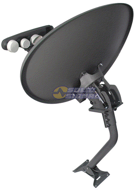

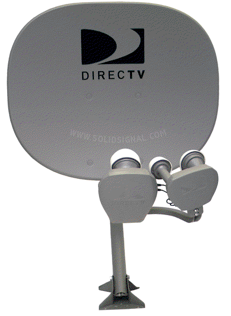

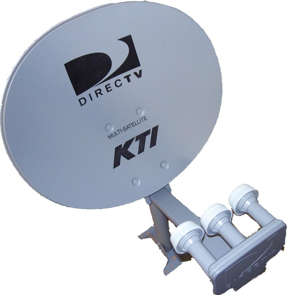

Do you really have a 5 LNB dish or a PhaseIII dish? Can you post a pic or look at these attached?
1 & 2 are both 5 LNB dishes
3 is a PhaseIII (3 LNB)
