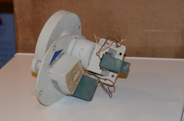

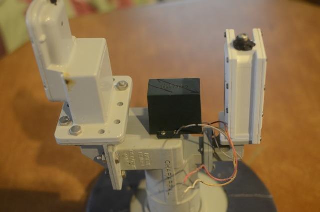

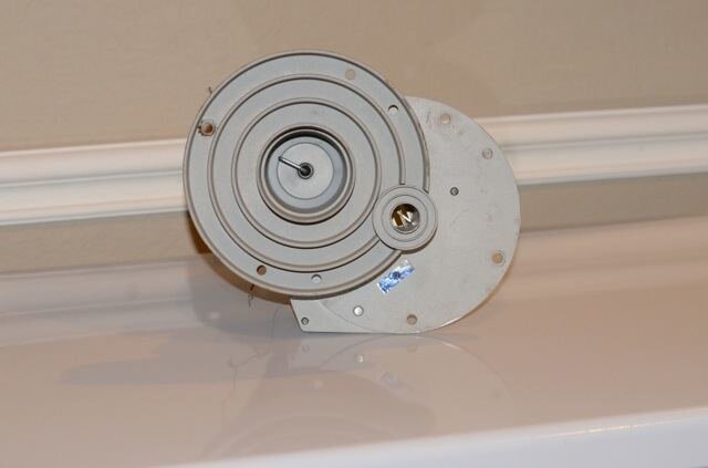

These are two of my old feedhorns that haven't been used in 19 years. They both seem to be in good shape and both made by Chaparral. The first one has the Ku LNB centered on the dish and the c-band LNB on the Polar Axis 3 inches from centered. It uses two polarators. This one is not shown on the Chaparral website. The second one is the Chaparral Corotor II plus and uses a single polarator. (not the wideband version). The c-band is 25 degrees and the Ku band is 0.7db noise figure. This will replace a BSC621-2D LNBF. Any suggestions which is better before I start mounting them on the dish?
The center-fired one for both bands is "better" of the two choices, if you want both bands on a single dish that is. That's why Chaparral no longer sells the other one with off-set feeds.
I'm curious - if you don't mind saying, why are you replacing the BSC621-2D with the older technology? Reason I ask is because I was thinking about doing just the opposite of what you're doing later this year, and the BSC621-2D was actually the one I was leaning toward. Is there some problem with it, or are you just wanting to experiment with the older stuff, or what?
LNBFs are a compromise of performance for convenience. A mechanical polarizer (Corotor) provides superior performance and ability for optimization over a LNBF. This optimization is especially critical on high FEC S2 signals 7/8, 8/9, etc. where even the slightest signal error will degrade the signal and it is unable to be decoded. Easy to pick-up 10 - 20% BER when or on a transponder with adjacent satellite interference or terrestrial interference and rolling off the skew. In the analog days the skew fine-tuning would reduce sparklies. Today it helps avoid the digital cliff.

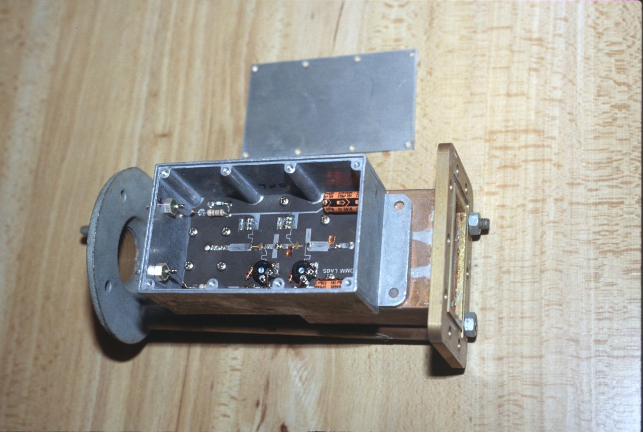

Here is a picture of my first LNA, which was home-made in 1980. At that time the tiny semiconductor devices went for over $1000 each! Note that the probe and waveguide were solid copper with a brass waveguide flange. It worked quite well, but no match for the 25 degree LNB's that were just a few hundred dollars in 1990. Quality LNB's are still in the $120 range for a 15 degree LNB. These have accurate, detailed, and repeatable specifications of what you are paying your money for.
I am sure I will get better and much more consistent performance from the Norsat LNB's and Chaparral Feed-horn's. My BSC621-2D LNBF was not quite as good as my DMS BSC421 on c-band and on Ku, the performance was very inconsistent and could not be adjusted to my satisfaction.

I would recommend the corotor II, for its simplicity and dependability. With good quality norsat lnb's you will be quite satisfied.
I've used bsc621 on a 10ft dish. After squeezing every bit of signal that I could (peaked the dish and the feedhorn), I picked up a used corotor with ancient lnbs (Macom for Cband, Gardiner for Ku) and threw it on the dish for an instant improvement.
I have 3 receivers slaved off of my dsr920 now and get excellent quality on both C and Ku band.
