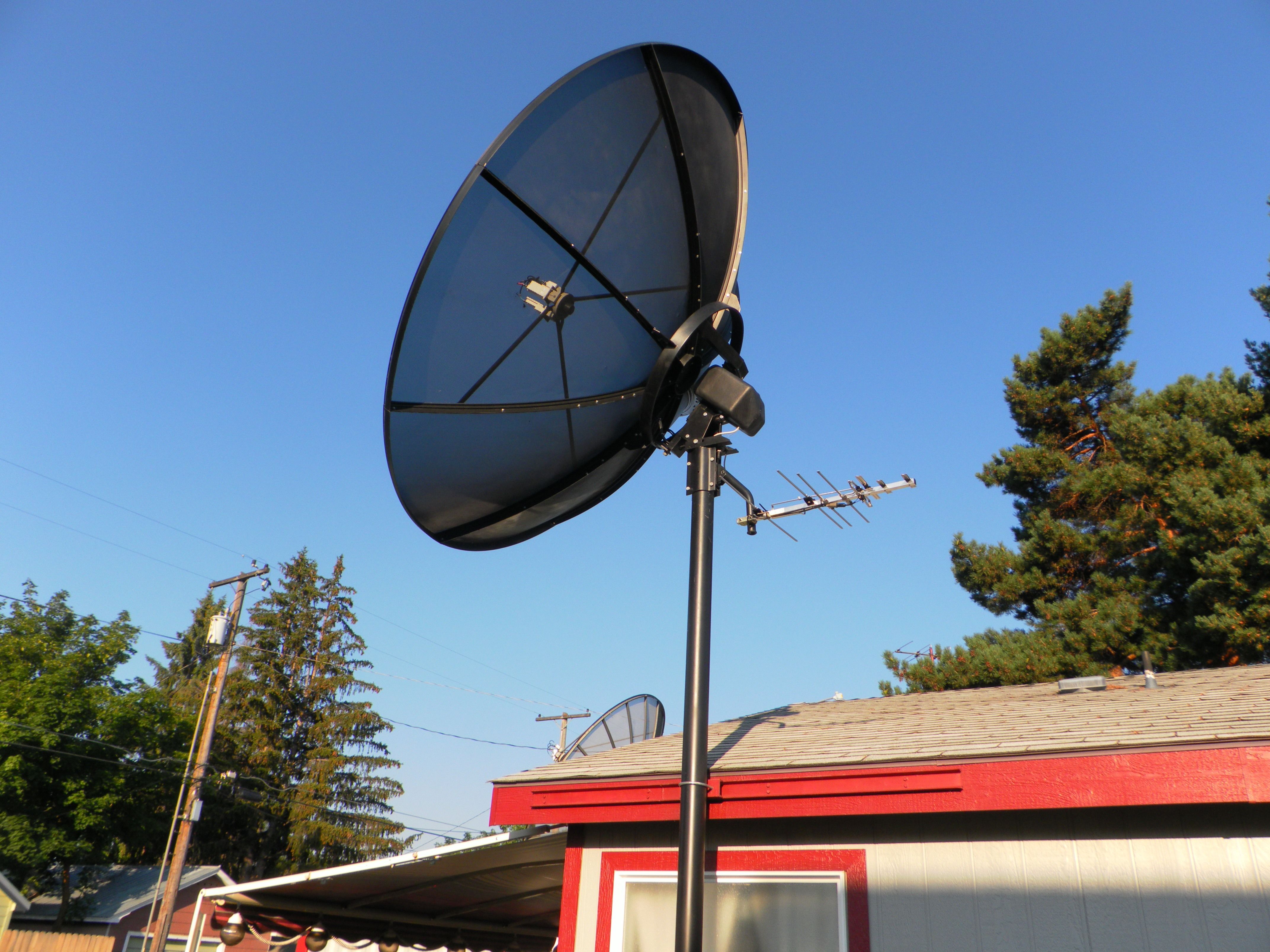

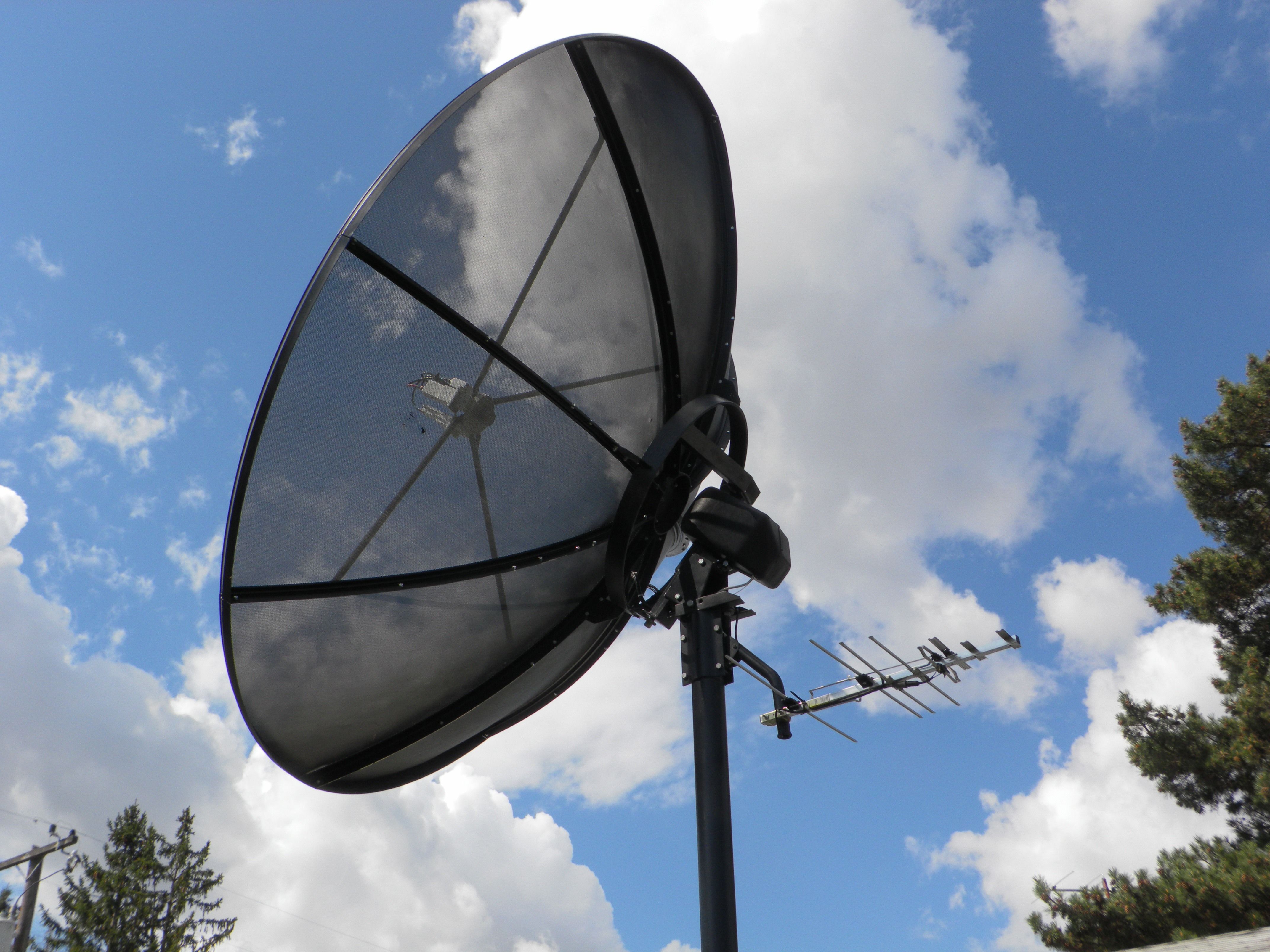

I painted mine with Rustoleum Semi-gloss Black. If I had to do it again I think I would go with Smoke Gray.

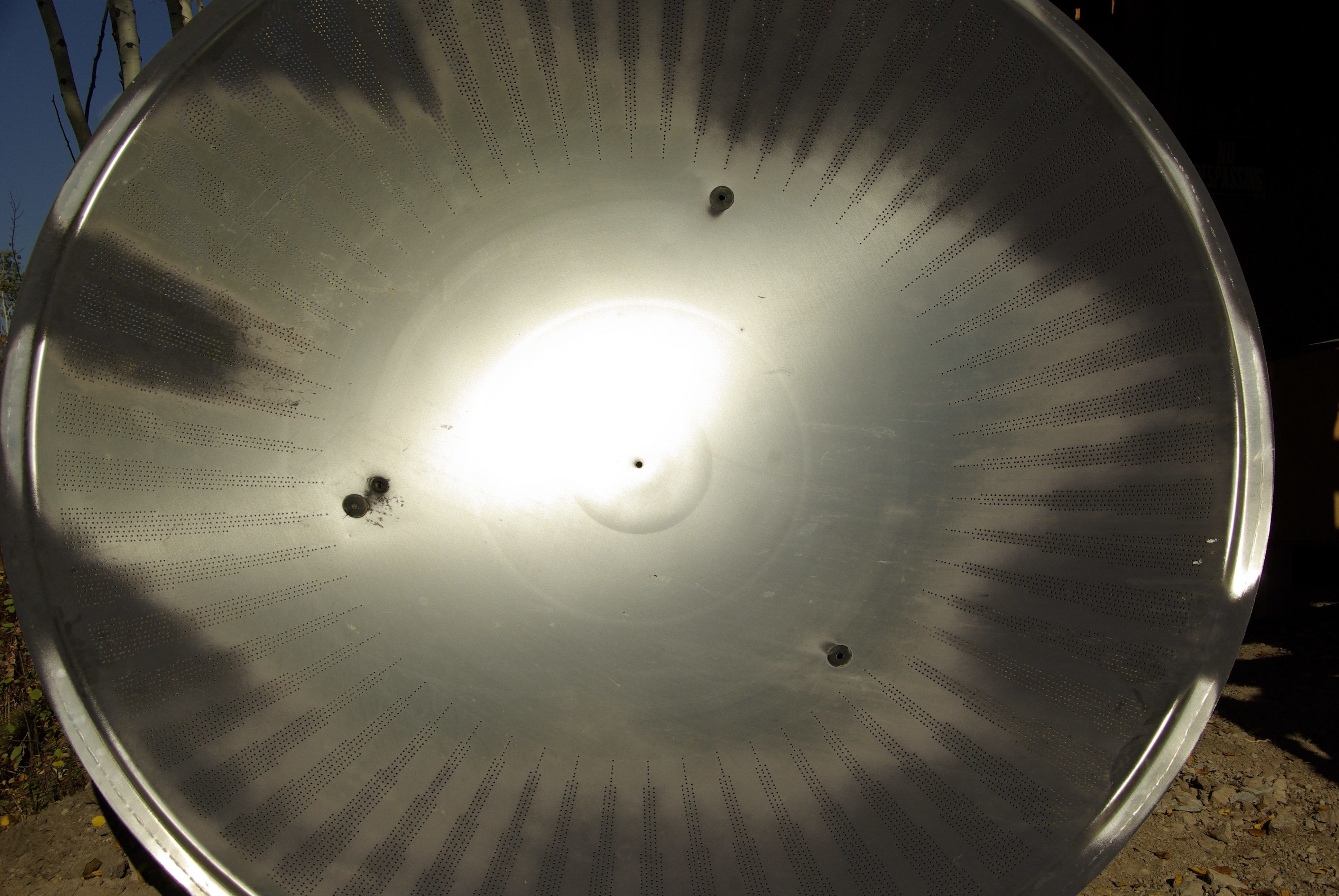

This the Hydro?
Solid one-piece, but with triangular patterns of small holes?
I've never heard of one damaged as you describe.
Was it sandblasted in the desert?
Could you post some pictures?
As for color, I'm very partial to the dark flat gray of the second dish in my signature. (DH perf)

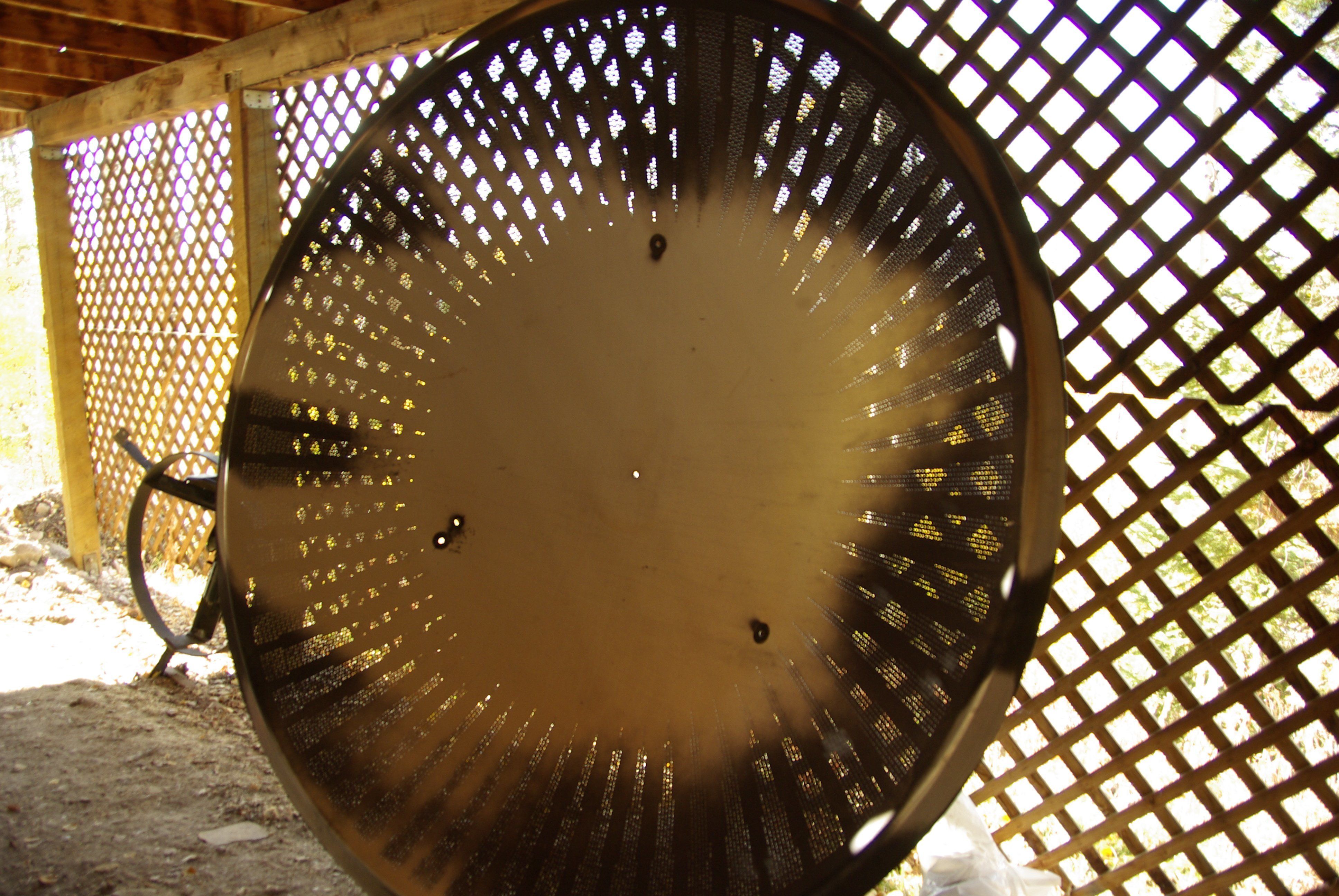

Yep this is the Hydo. I picked it up in Longmont, CO about 3 weeks ago. I'll get some pics of it before it's painted. The guy lived on flat acreage next to a lake. I'm sure it's seen many years of ice, snow, & hard wind. All around the center is bare aluminum and the outer is a very dark gray or even light flat black. I want to be careful painting not to fill the tiny holes. I'm sure they're there for some purpose. Anole that AMCI really does blend in with the sky well. I'll look for a dark flat gray.

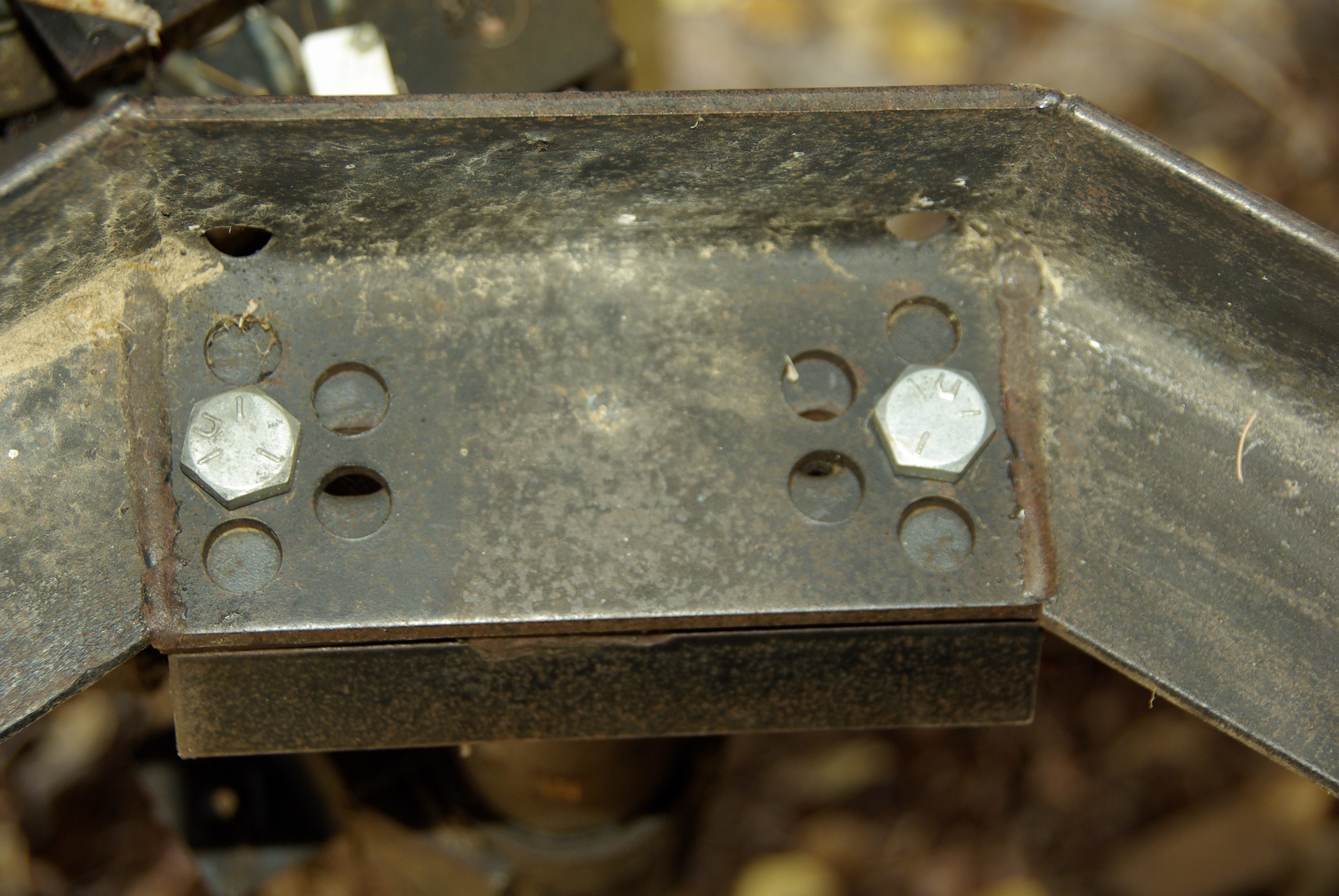

I'm going to town today & I'll pick up some Rustoleum but here are the "before" pics. I'll also include a shot of the Ajak where I think the declination is to be set. It's not real clear to me how it's actually done (I understand the settings but not so much the nuts & bolts for the adjustment on this mount) but it has not been disassembled and was mounted at less than 1/2 degree difference from my lat. so maybe will be right on. Lots of cleanup and painting and lubing to do. My 18" post hole gets augered out Wednesday so I should be aiming by next weekend. _IGP7350.JPG _IGP7354.JPG _IGP7355.JPG

I removed the elevation rod but havn't touched the declination setting. Like I say, I'm not certain how to correct it (the declination) if it's off. The dish was mounted a couple of hundred miles away but the lat. difference is only .6150 so maybe I'll be lucky. I'm curious though so I'll probably play with it. I'll be spraying that dish. Too late now, it's a long drive to town & I already picked up the paint.

Thanks for the manual link phlatwound (bass player?) but I already have that manual. It tells you ABOUT setting the declination and how to figure it but really doesn't explain HOW to set it. EX: loosen bolts A and B and slide crossmember to degree mark Z. I read a post where someone said that there is even a fine adjustment. Still a mystery. Very frustrating. That's a terrible manual especially for one that didn't come from China but here in my own state. I've gleaned enough from it to probably get by though. It doesn't help much that the photos are dark in the download I guess. But like you say, I probably won't have to touch the declination setting.

You can get a good idea of your declination amount by measuring the difference in angle between the main elevation bar, and a straightedge placed "vertically" from top to bottom of the ring the reflector attaches to. It would be pretty easy to measure and change your setting before the reflector is installed, if need be.
I am using the "middle" set of holes on both of my AJAK 180s, and that setting is giving me approximately 5 1/2 degrees of declination.
