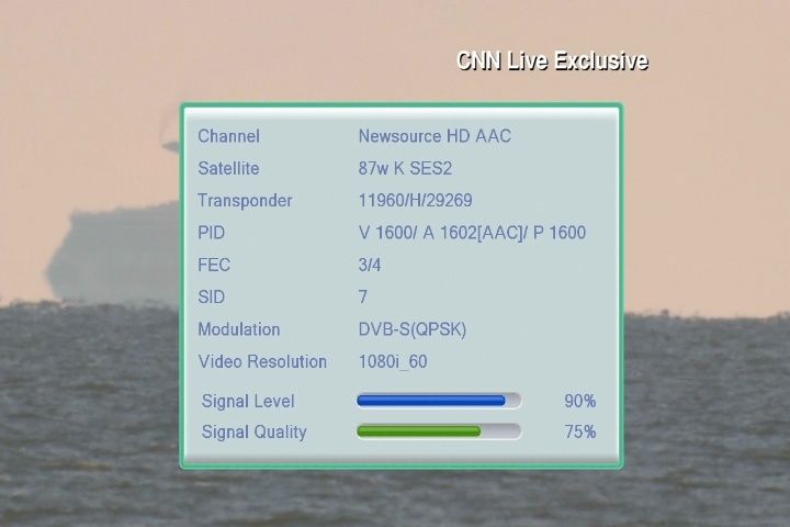

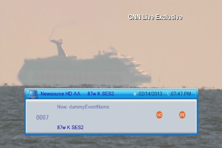

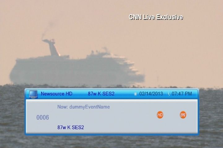

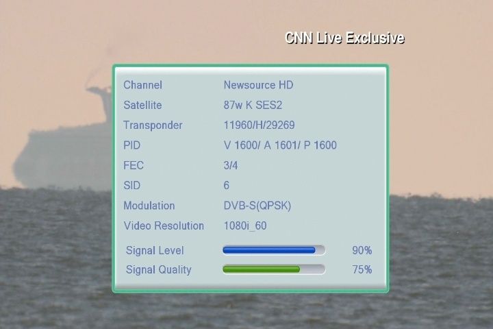

Working fine here. See attached.

SID 6 and SID 7 share the same VPID of 1600, but the APIDs are mapped to separate PIDs.
