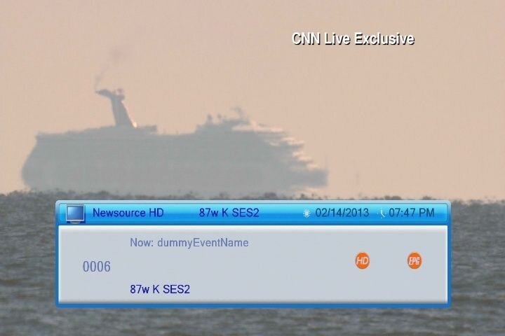

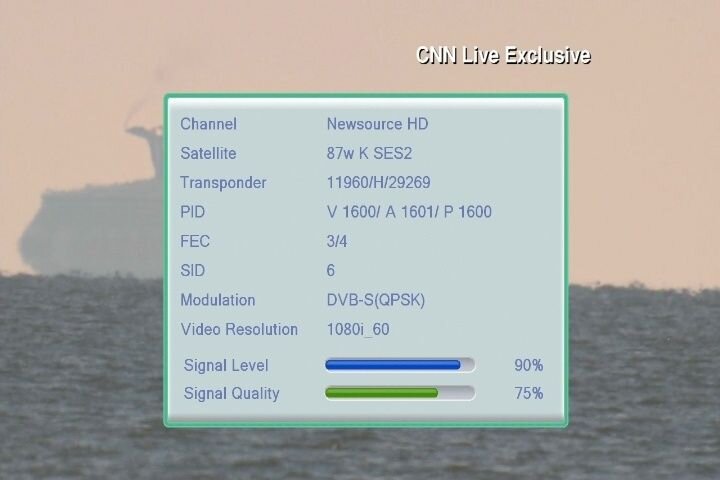

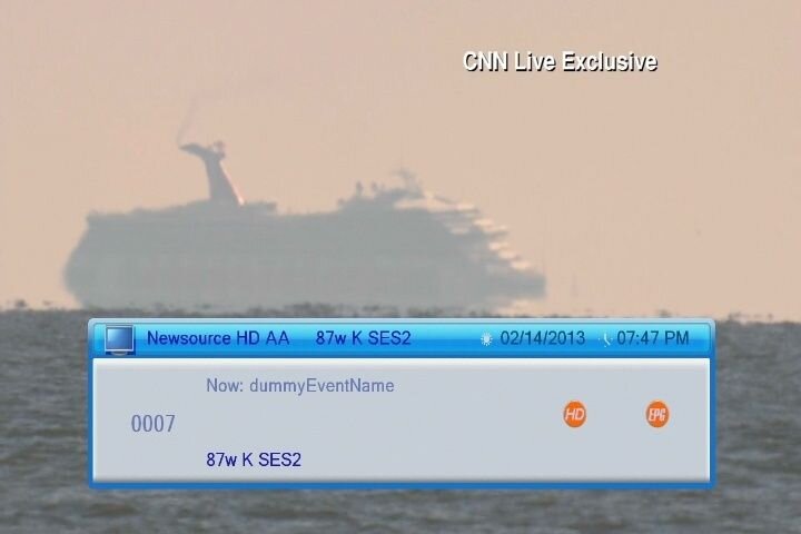

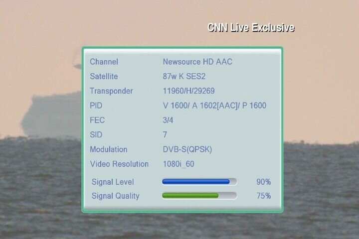

Working fine here. See attached.
Glad I didn't go on that cruise! :eek:
SID 6 and SID 7 share the same VPID of 1600, but the APIDs are mapped to separate PIDs.
