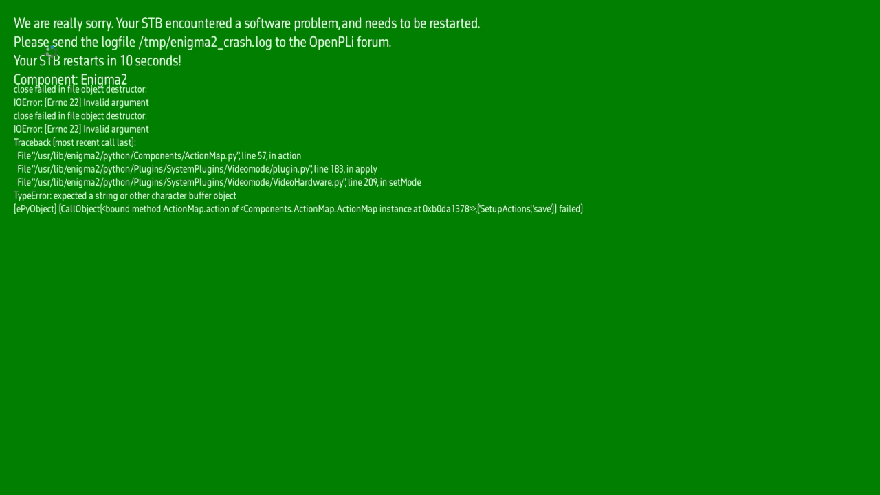

Thanks for the response. The Blackmagic recorder will accept a multitude of resolutions/frame rates. The only one that it "likes" from the Edision is 480i, which obviously is not something I'd want to use. Curiously, I found that if I try to switch the Edision to 1080p, the receiver immediately crashes and reboots. This happens regardless of whether I am connected to the Blackmagic recorder, or a TV. Pic of the crash screen below.

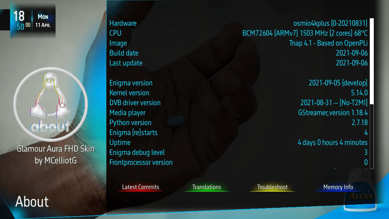

TNAP 4.1. Here's a screenshot of the "About" menu:

The Edision works fine when connected to a couple of different TVs, but still crashes if I try to select 1080p. Refresh rate is set to 60Hz. That said, I had no plan to use 1080p -- selecting that mode was strictly for testing purposes. 1080i/59.94 is my preferred setting.

I would post this question on the LegitFTA forum. LegitFTA
El bandido is the developer of the TNAP image and he will likely want to view a copy of the crash log.
You indicated by email that you disabled the HDMI-CEC, this would have been my first suggestion. Am not aware of any issue that could cause a 1080p crash. Might benefit from reloading TNAP 4.1 or testing with another image.

OK, I have to take some responsibility here. In attempting to re-create the crash, I didn't notice that when toggling the resolution to 1080p, the refresh rate was changing to 50Hz. When I set it to 1080p/60, there's no crash. So, my fault for not noticing that.
