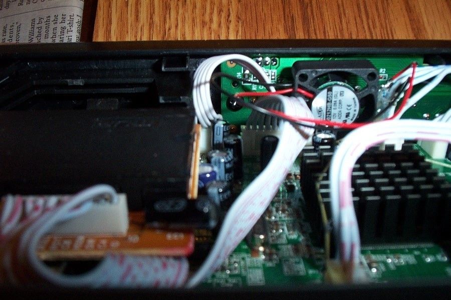

which may be a heat problem.
When I killed mine I popped the cover off and the cover has been off ever since.

Added a 12V, 25mm fan and it is running cool.....Ed
