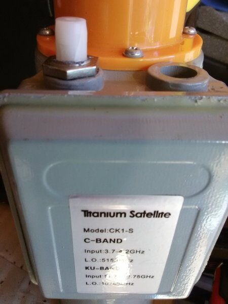

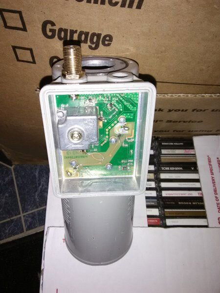

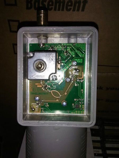

I repaired a Titanium Satellite CK1-S C/ku band LNBF that was damaged because of a bad terminal.
The C-band side terminal was die-cast and very thin, which broke off easily. I was about to toss it out, but decided to try and repair instead.
I had a KU-band LNBF that was no good, but had a gold plated connection,
so I carefully unsoldered the terminal, and transplanted it to the CK1-S.

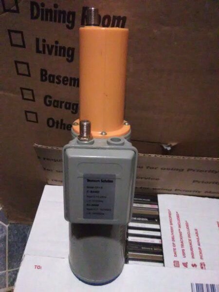

BAM! perfect fit, a stronger terminal, and is working perfectly again.
The LNBF itself always worked great for me, but the terminals could use an upgrade.

Thanks! I just hated the idea of tossing it when it was practically new. I bought it over a year ago but had only recently started using it, and had to take my dishes down for hurricane Irma. And this is what happened when I went to reinstall. I had another c-band that the terminal wasn't soldered good on the inside that I repaired a while back too. I posted it quite some time ago, somewhere on here, it was a cheap Young YY-CD008 C-band LNBF. I also had repaired a Titanium Satellite C1W-PLL lite C-band LNBF that the terminal came loose on the inside as well.

When I removed the old one, it appeared to have been cross-threaded on the inside, so it may have been a manufacturing defect, but don't know for sure. I'm thinking there was a hairline crack, and it just finished breaking when I re-installed after hurricane Irma. I never wrench them (anymore at least, :coco, that always turns out bad on RF connectors it seems. I learned that lesson from the 1st one I had to repair a few years ago. That is why it broke, instead of separating from the LNBF, it unscrewed the RF terminal with it. At least it's been a fairly easy fix so far.

Some LNBFs have thin walled F-connectors, add to the fact I had to take my dishes down in a hurry for hurricane Irma, probably didn't help either.
What surprised me was the Ku-band side seems to have a better connector than the C-band side. But probably assembled in 2 different locations, thus different parts available.
