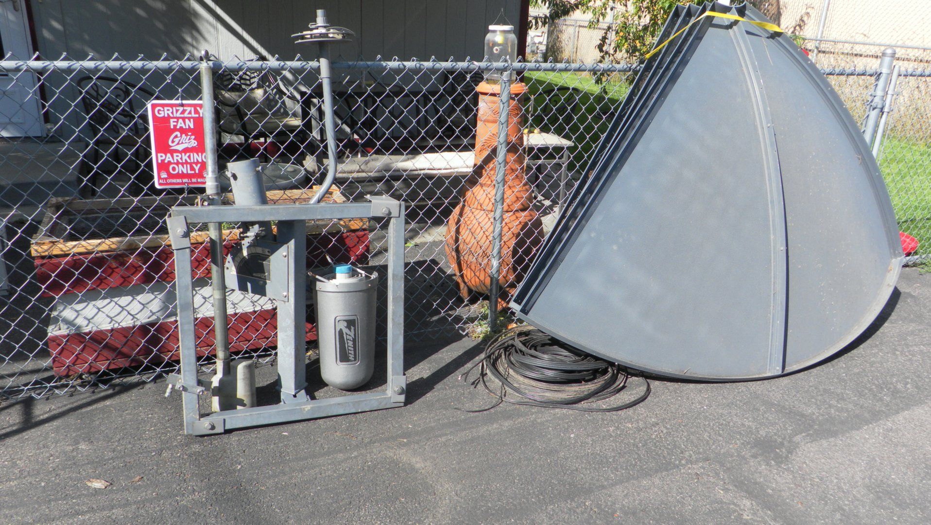

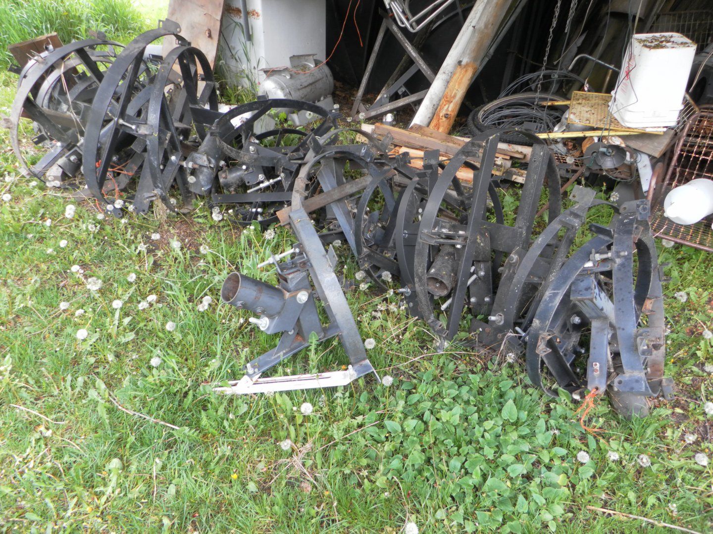

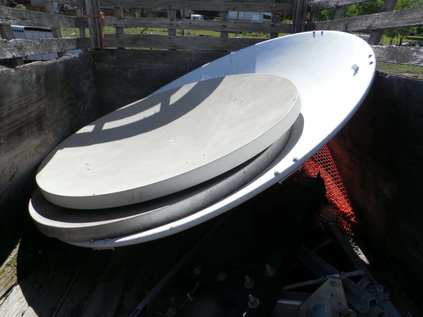

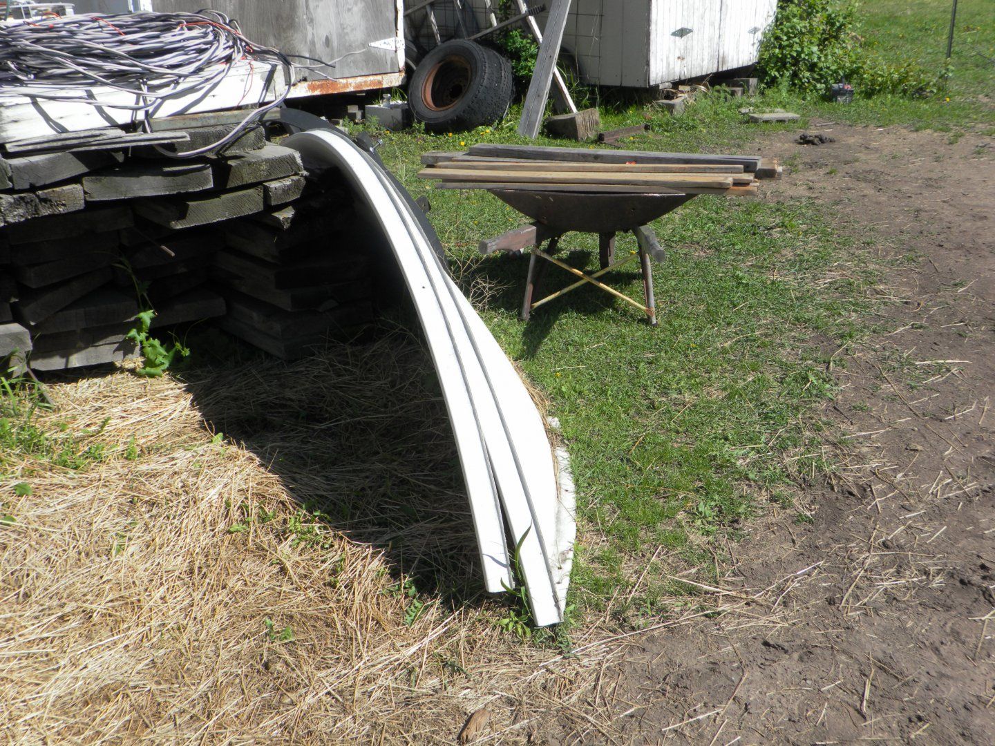

I've been seriously considering fixing up one of the two 1.8M Ku dishes out in the dish graveyard. I had fun doing up the 1.2 M and this would make a good project.

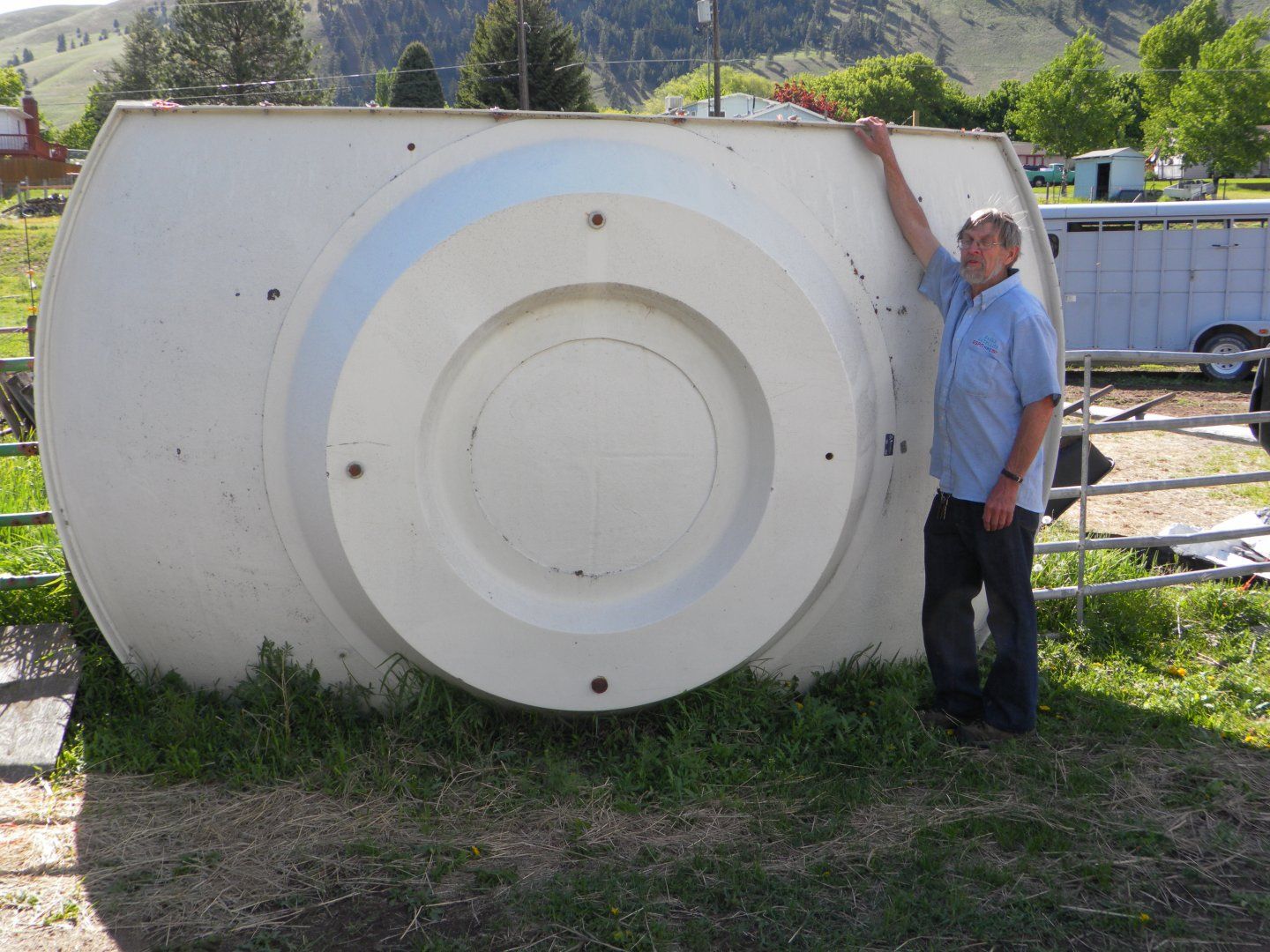

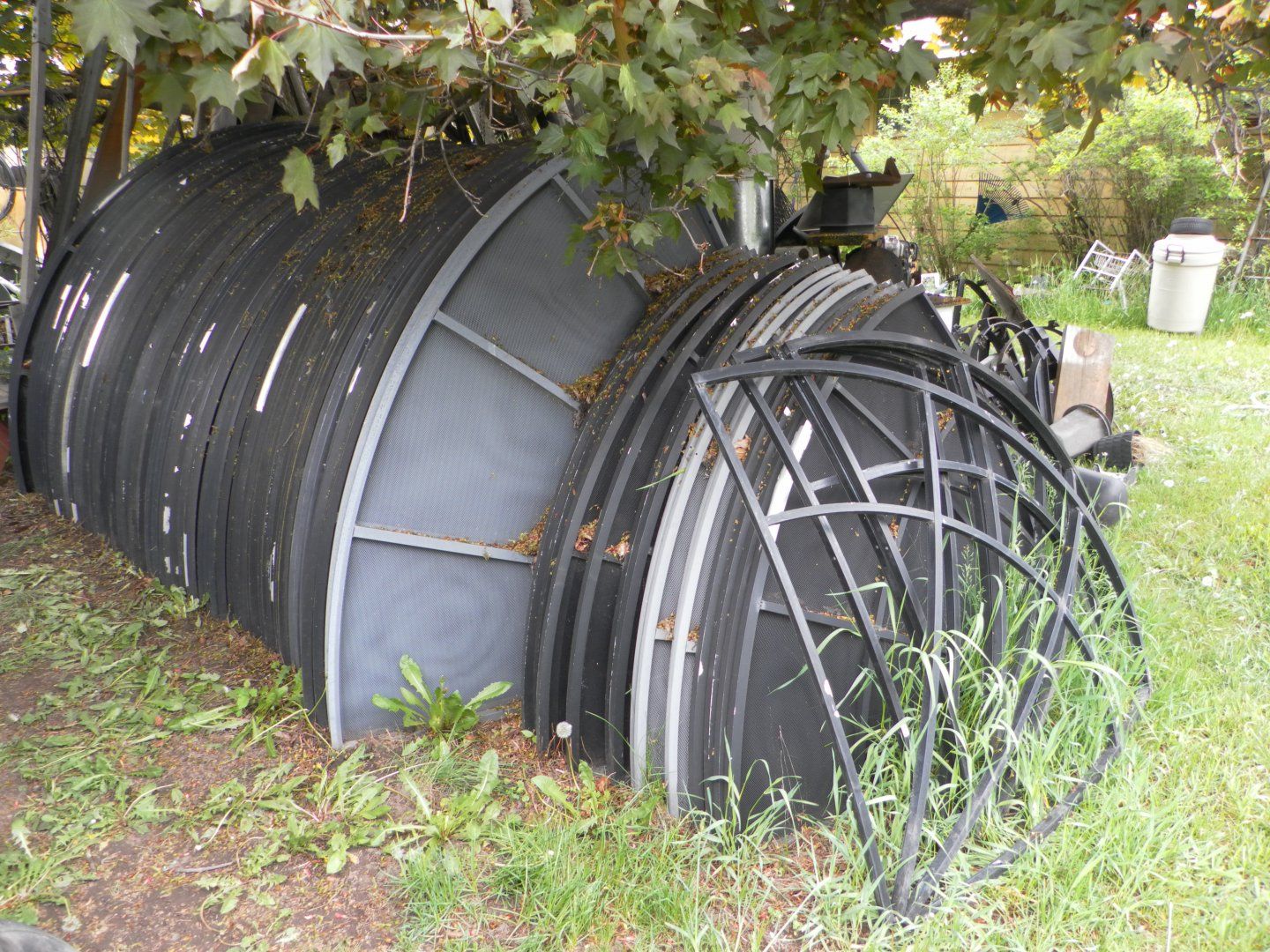

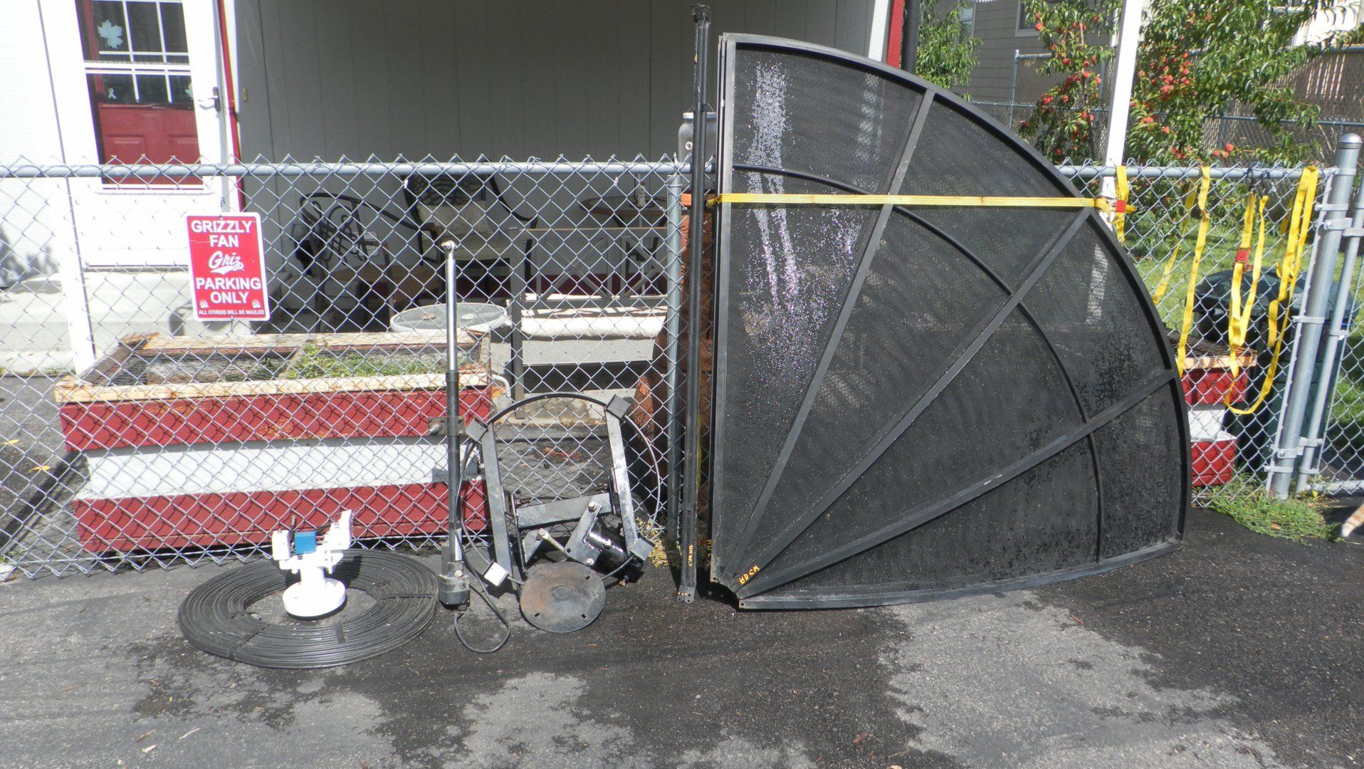

If you want to drive to Missoula, MT I got 10' Mesh dishes in your budget, like free.
Reactions: Titanium
Do you still have a large mesh dish you would like to give away? If so, I'd be interested in taking one off your hands.
As you can see in the pics there are a few 10 footers. :) There is another location where the solid dishes are stored. :) How far do you have to travel?

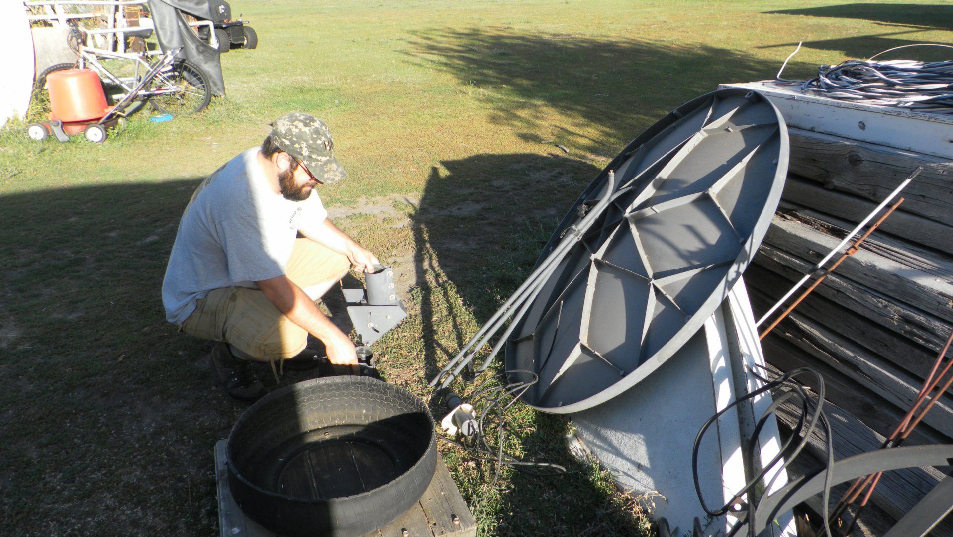

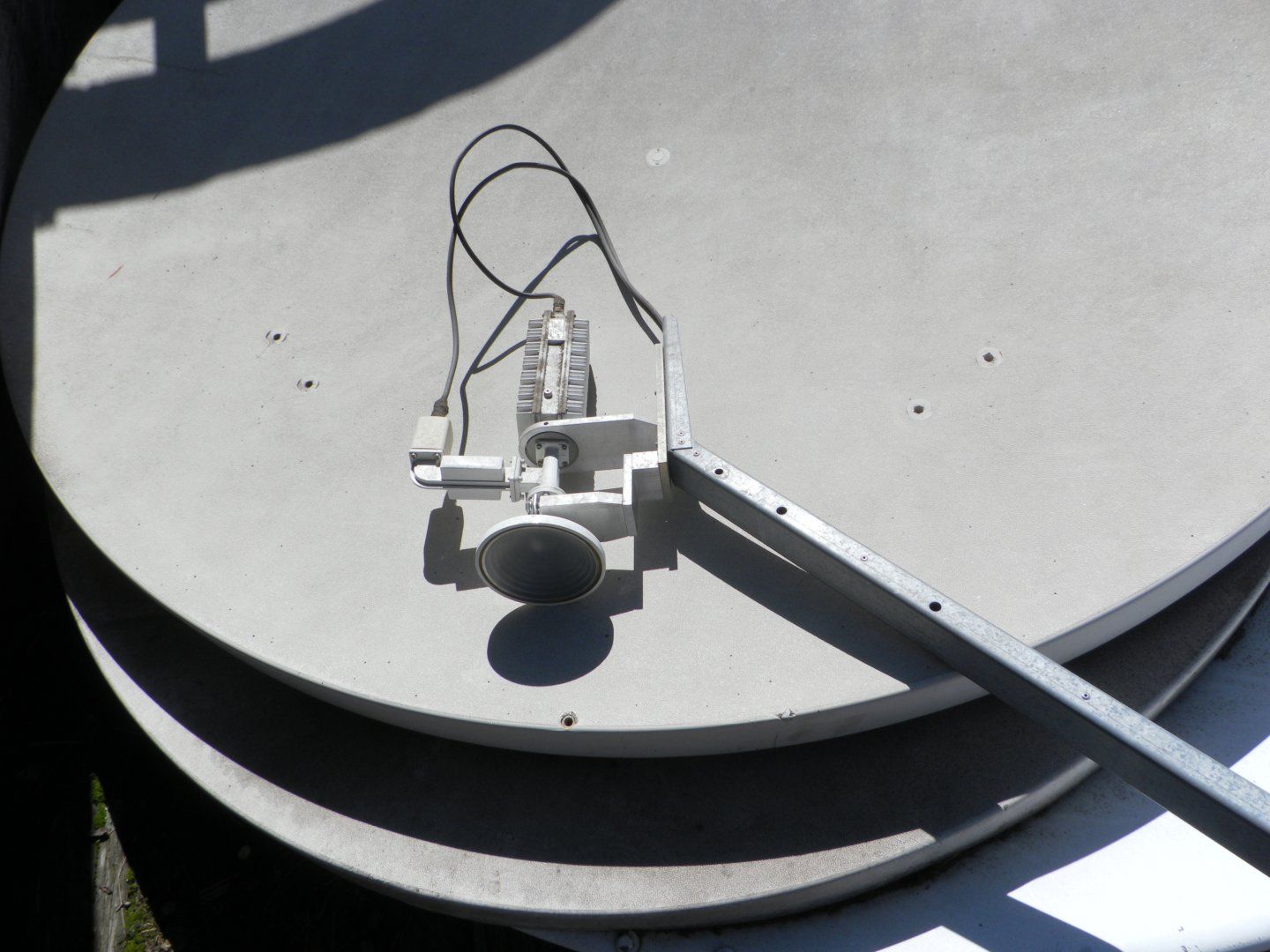

What better way to compliment a free C-Band dish than to get a free Ku dish too. EmCommSat and I ran out the horse pasture where many dishes are hidden away and picked out a nice 1.2M PrimeStar. He was happy to see the horses too. Selfie Time :)
Nice Dish!
All loaded up and ready for the trip home :)
