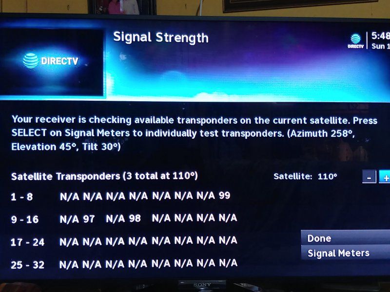

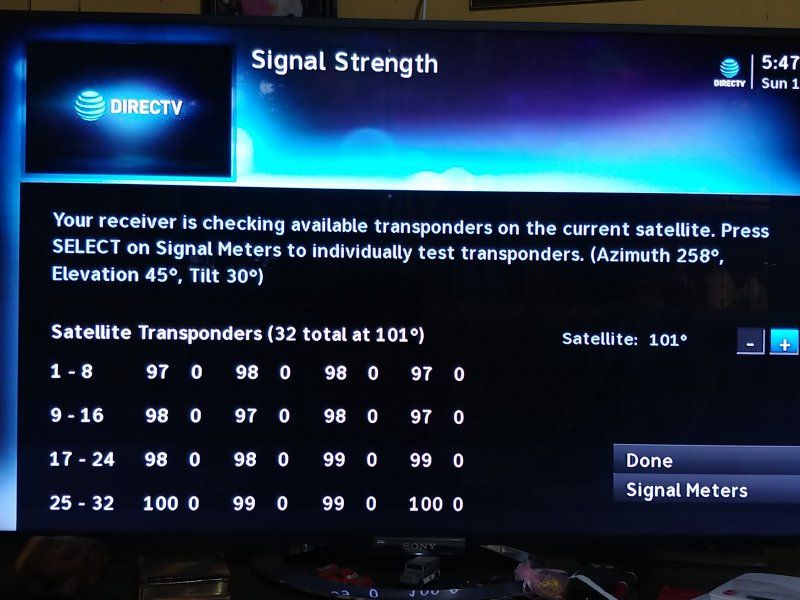

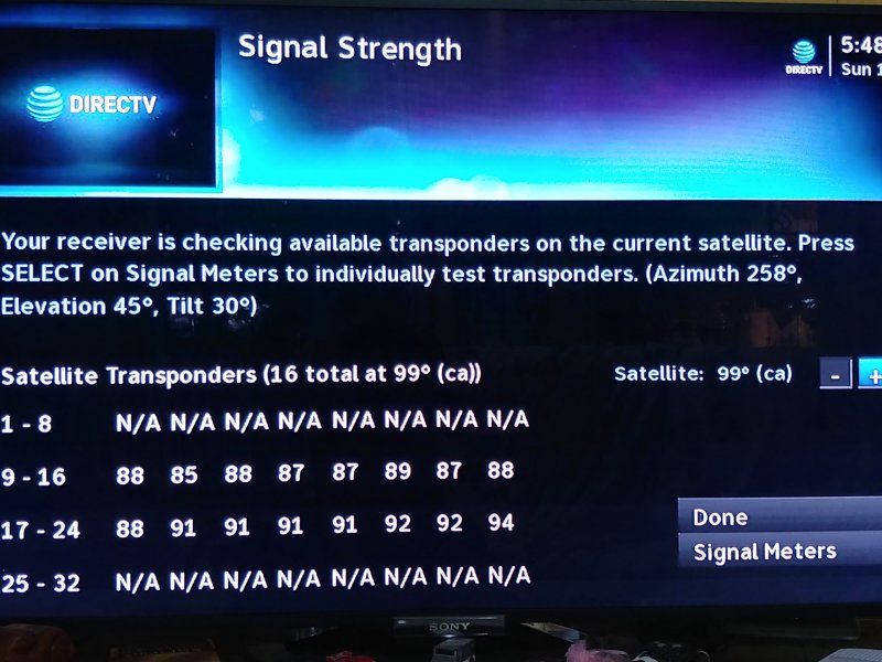

This is my setup in Puerto Rico
Hey, great to finally hear from a sub. in PR post-Maria ...
Yep, those numbers clearly shows that all traffic from T8 (odd numbered tps.) have been moved to T15 and nothing yet from T9S/T4S (even numbered tps.).
But can you post all your signal levels there in PR for us?
Since Maria, for obvious reasons it's a rarity today to have a DIRECTV subscriber here on the forum on the ground there in PR to report what's happening.
Thanks ...
Sent from my LG-H932 using Tapatalk

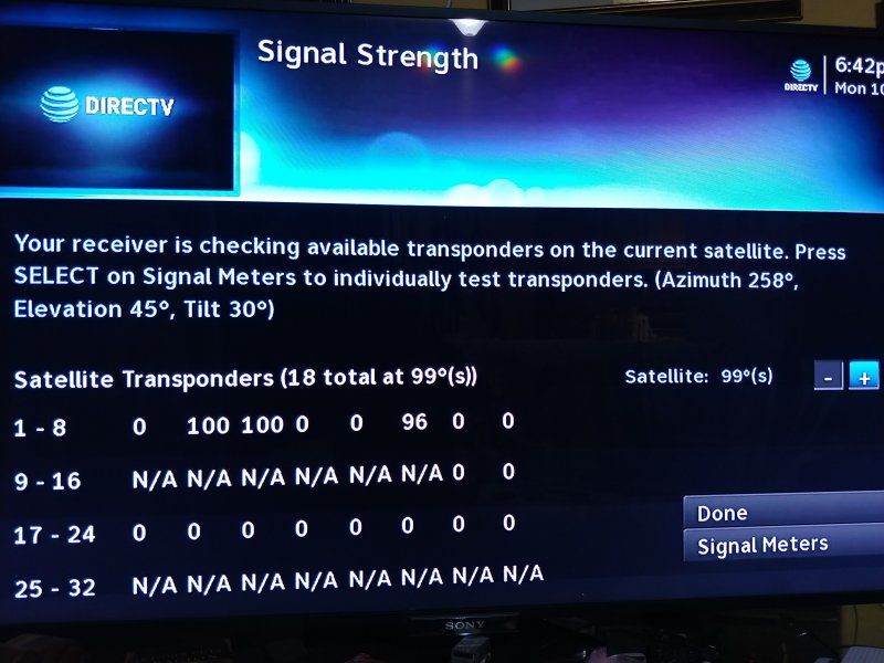

Thanks ...
Do you show anything on "99(s)?"
Ok great ...

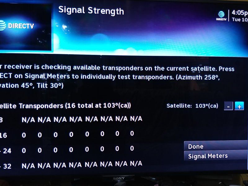

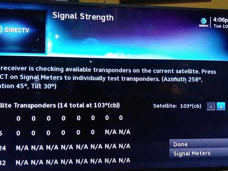

Now, could you do one more favor for us and I'll be done bothering you. [emoji6]
While I realize they're all zeros right now, can you show us anyway what the "103(ca)," "103(cb)," and "103(s)" screens look like?
Need the info. to update the weekly TPN map Excel spreadsheets posted for download on the "iamanedgecutter.com" site.
Many thanks again ...
103
