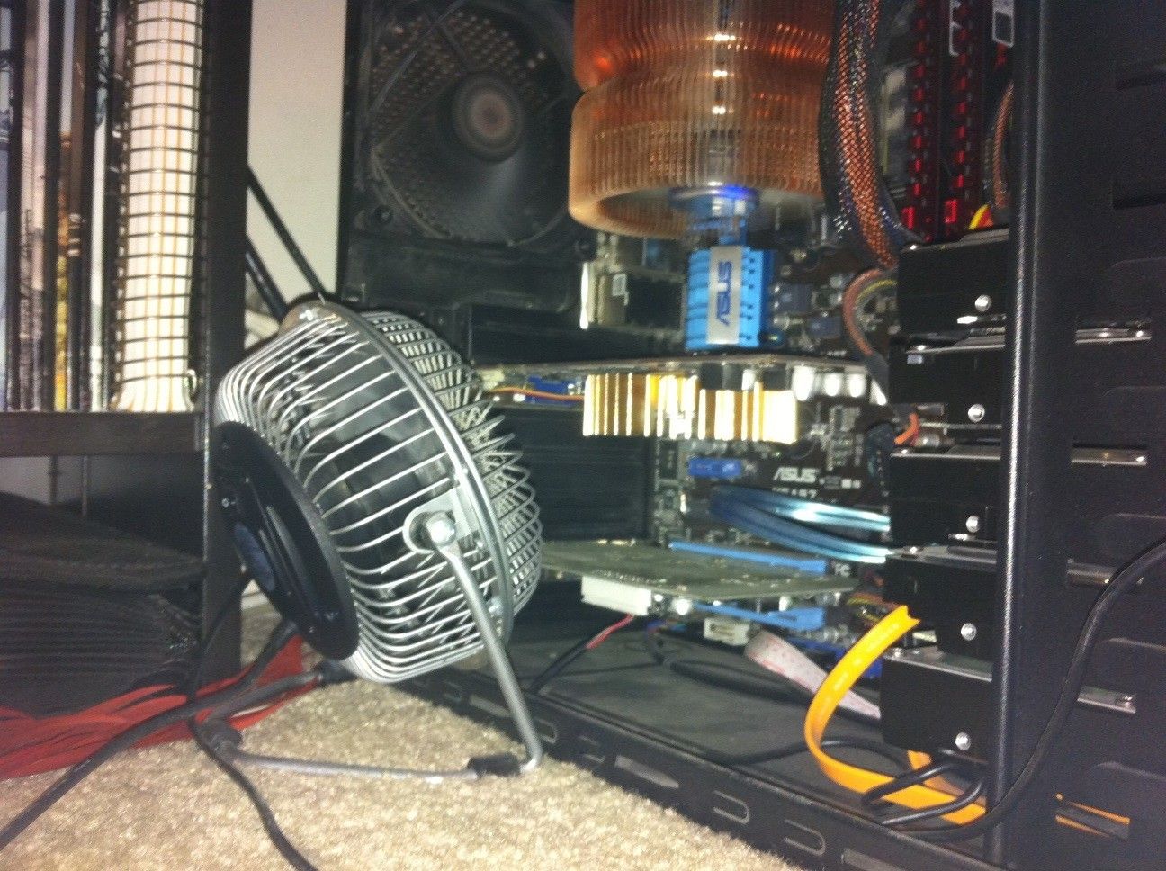

It's a good thing I thought about computer temps. I checked mine and saw the video card was at 73C :eek:. Turns out the fan on it died. Here's my temporary fix:
