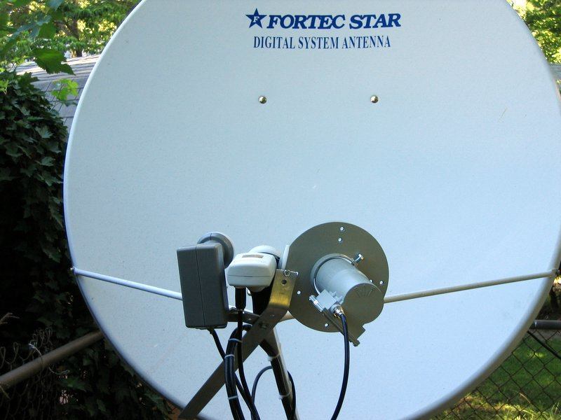

I also have the Winegard 1m dish on an SG2100 motor. Can you take a picture of your setup so i can see how you mounted the ASC421? I'm also trying to do the same thing like you, trying to get C-Band with a 1 meter dish.

What I did is I used 1.5" X 8" angle aluminun and drilled holes into it to match with the holes on the dish LNB arm. I mount the KU LNB to be mounted exactly where it would be normally and mounted the ASC421 to the left of it. I mounted the AS421 ring so that the AS421 would be at the same hieght as the KU lnb and I angled it to point to the same spot as the KU LNB using a wedge that I made and with washers.
I tried using a signal meter and holding the ASC421 (keep my self away from the dish focal point) with my hand and moving it in various direction and positions but got no results. My dish is 17' above ground on a pole and makes it difficult to do these experiments on a ladder.

Take a look at the following picture, althought it's a 1.2m dish.. maybe you should mount the C-Band LNB on the right side (facing the dish)
It might just work for you better then on the left side.
