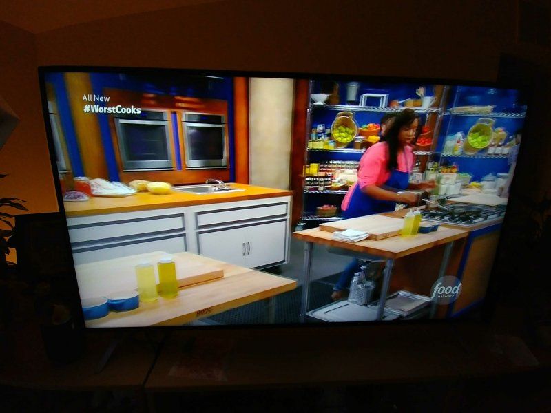

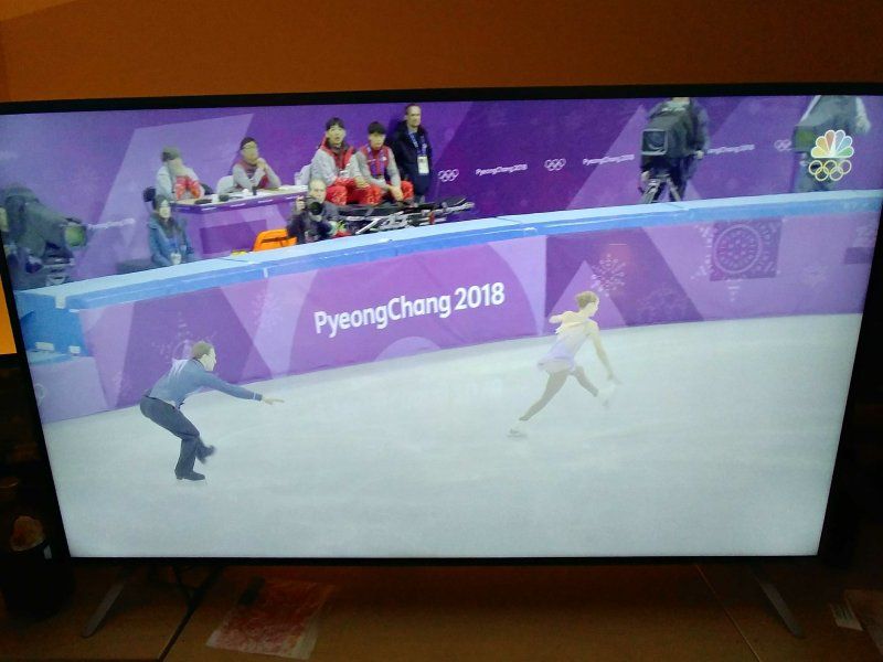

I'm getting the 4k channel, but the picture doesn't look great. Other 4k programming has looked amazing. Here's a comparison between the 4k and a regular HD.

I'm getting the 4k channel, but the picture doesn't look great. Other 4k programming has looked amazing. Here's a comparison between the 4k and a regular HD.View attachment 131283View attachment 131284
I happened to tune in to that exact same 4K picture you did. Something was wrong with the camera or something as when I returned to the channel later it showed a different skater performing, the HDR kicked on and the picture looked great.
