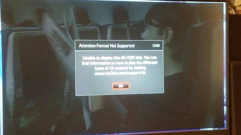

The H3 recorded the open ceremonies from the 4k channel.
Reiterating, our H3 is connected to a 1080 tv.
The 4k program is in the dvr listings.
I press play.
The program starts.
With a superimposed shading and the incompatible tv message.
Why?
This is clearly a software forced block by Dish.
The program is clearly downscaled and is the fullscreen picture being mostly covered by the shaded window and incompatible hardware box.

I have the same issue.
I was also able to record a show, start it and see it in the background but with the error message and shadow box turned on. The video played fine, audio coming through no problem, just that alert is unable to be removed. When you click OK and the alert goes away, the content continues to play for a second or two without the error message or shadow and looks like what you'd expect. So it seems that non-HDR sets should be capable of viewing the channel but without the enhancements of HDR.
Looking around online in some other AV focused sites, other people have mentioned being able to play HDR content but not getting the HDR effect on their older non-HDR sets.
Definitely seems like a software block, especially if a tech was able to remove it for AKGolf temporarily. Really sucks that Dish just tossed all their early 4K users to the side. Not like we get a ton of events worthy of 4K that have an actual 4K feed, and now one of the few times they're restricting the feed to a small section of users.
