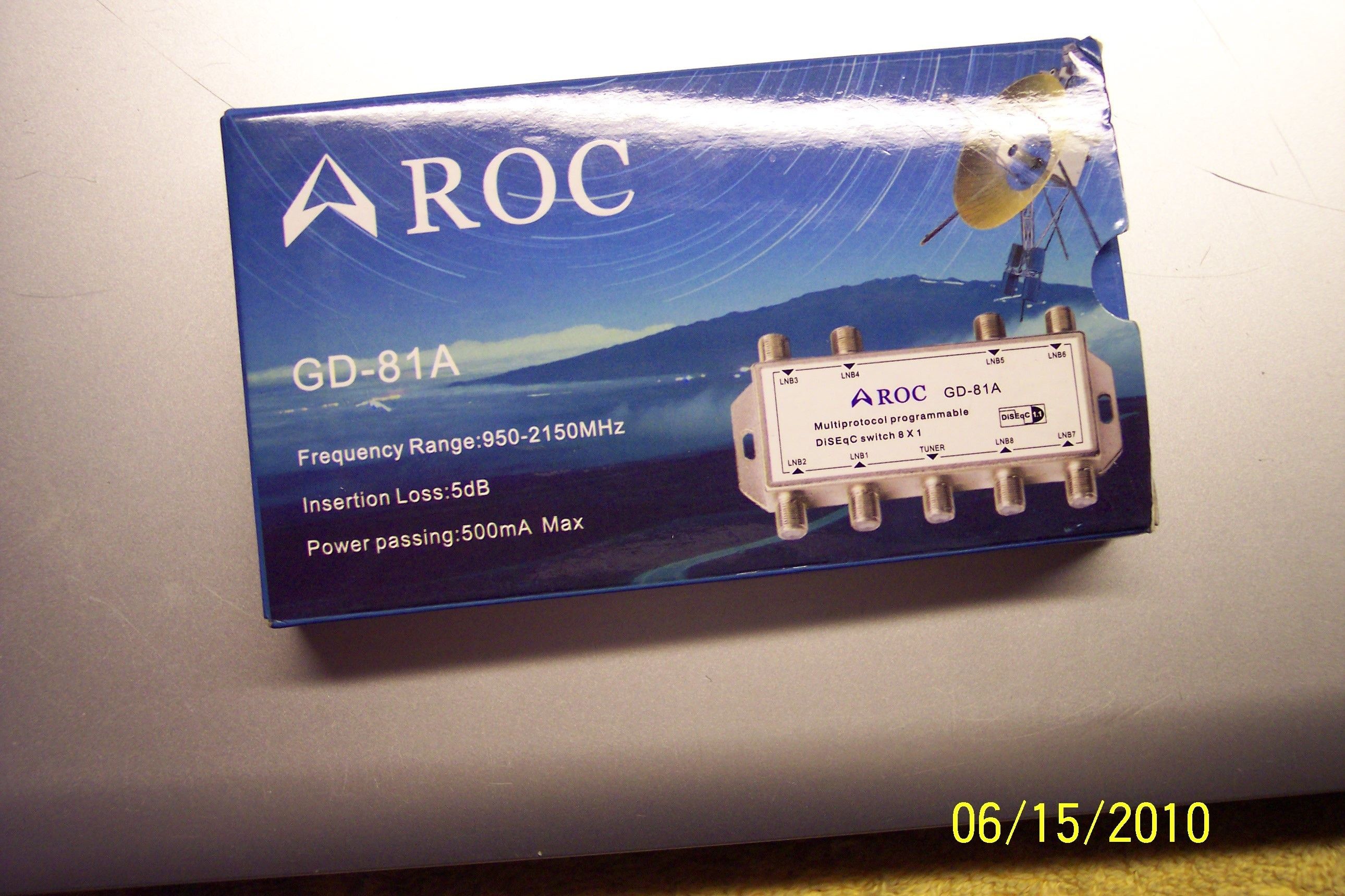

My 8x1 has happen to be GD-81A DiSEcqC 1.1 by ROC
Unfortunately my FLU (Fortec Star Ultra) does NOT support 1.1 so I had to changed for Coolsat 7000 wich is good for 1.1 and gives me a chance to connect up to 16 satellites
So as for now I can remove motor and set up entire farm of sats just to improve switching time from a sat to another one in NO TIME.Works like a champ.
No need for 22kHz at all
Here is the picture of my switch

looks just like my Digiwave switch but different name
But Unfortunately does not pas DVB-S2 signals.
Thank to yours link I finde out that in the past someone already has tested the same thing.So For now is OK but when I am ready for AZ Box then I have to thing about something better.

Reading old post about the switch disecq 8x1 I have brought this post from 2010 because the answer was keeping in the air about How works the switch disecq 8x1 with the DVB-S2 signals..
So, is true Or False!!!!..8X1 disecqs works fine with DVB-S2 signals (like disecq 4x1) ? and is recommended if my receiver supports 1.1 and my set up has 8 LNBS?T
thanks in advance
Yes these switches pass S2 signals just fine, the poster that said that must have had another problem.
Yes I recommend this for more than 4. I have used these for a long time and love them. Seems I always had problems with 4x1 switches, getting bad ports. Once I switched to using Digiwave 8x1 switches I haven't looked back. :)
Just to reenforce Mike's post, I use an 8 port switch on one of my rigs and it passes S2 signals fine. Not sure how it wouldn't... rf is rf, the switch can't distinguish between psk modes to filter one out...
