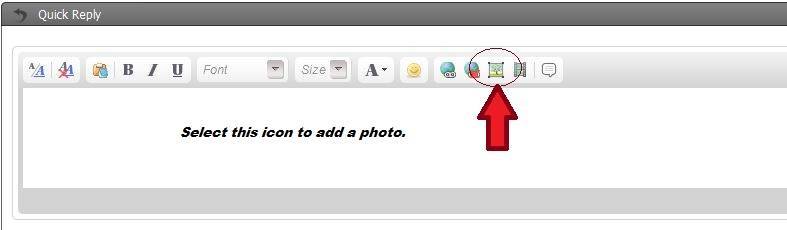

No need to start a new thread...we're still standing by :) Could you please post a photo of your dish set-up? We might be able to spot a problem just by looking at the photo...
