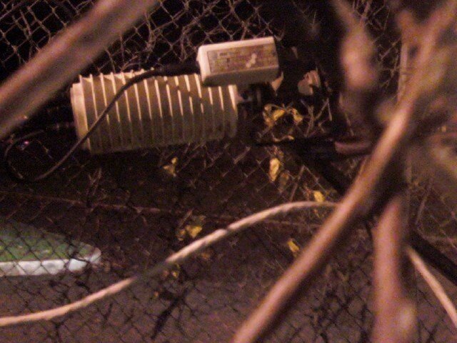

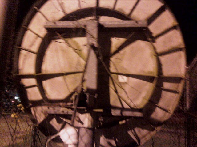

I found this big old dish at an old bank. I just wonder if its worth the trouble for FTA. It was late at night so forgive the bad pictures. I know its fiberglass and its at least 36inchs across, like I said it was late.
What is it and can it take a motor.

Yes, well worth the trouble.
I think it is a 1.2 meter and yes, it can be motorized but the weight is probably close to (or above) the limit for the typical little H-H DiSEqC motor.
With some fabrication you can put it on a BUD polar (linear or H-H) mount.
That looks to be a Prodelin dish.
There's plenty of discussion on the forum of the 6' model.
But the 4' version (1.2meter) looks identical. (not really: see my post below)

It does look like a lot of the Prodelin dishes I used to put up when I did commercial installs. If it is the 1.8 m (6 ft) then you could make a mini bud for C/KU. You will need to put a "C-band" type of polar or H 2 H mount on the unit. They are heavy duty and heavy built systems.
Thanks guys. It does look like a Prodelin dish, I think it may be a 6 footer.

On second look I think you may be right, it's looking more like a 6 footer to me.
Either way, fantastic dish, get it if you can. The 6 footer would definitely require a BUD mount of some sort if you wanted to motorize, if it's 6', the reflector alone is probably around 50 pounds.
oops:
What I meant to say above, was the the Prodelin 4' and 6' mounts often looked pretty much alike from the back side.
The dishes themselves look a little different.
Here's a pic from Phlatwound's thread showing the back side of a Prodelin 1.2m (4') dish.
So. . . a 6'er it must be! - :rolleyes:
And I think the 6' reflector plus LNB support arms come in closer to 100 lbs.
