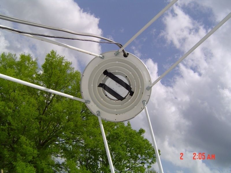

I finally finished tuning the Tennessee Solid Birdview this week-end.
Suffice it to say that I am really really happy! :cool:
It is doing an outstanding job on both C-Band and Ku-Band.
I posted a couple of pictures in another thread about NSS-806 the other day. After tuning everything up, I don't know whether I will be able to pull it in with the tree blocking half the dish.
I can get IS-3 at 43W with 30% SQ with the tree in the pic below blocking, and can still get watchable C-Band signals. NSS-806 is at 40W, so that means the dish will be 3 degrees deeper into the tree blockage, so I don't know.
When I get everything hooked back up inside, I'll find a transponder and give it a shot to see what happens.
Here is the tree at 43W:
Ok!!
Now I am just blown away.
I actually pulled in 5 unique transponders along with some duplicates of course. It is a little hard to set the skew.
I am actually watching a News Channel with 30% SQ with the tree blocking 1/2 to 2/3 of the dish.
A well tuned dish out in the open should be able to pull in a lot of channels off this satellite even without the dialectric plate. :)
