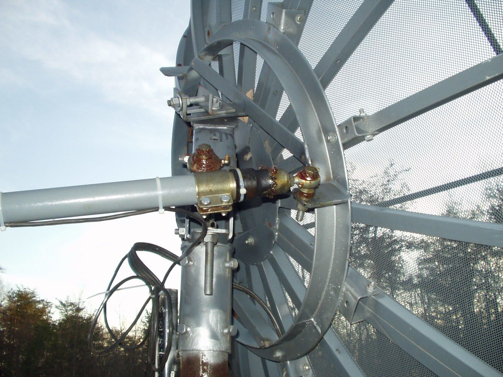

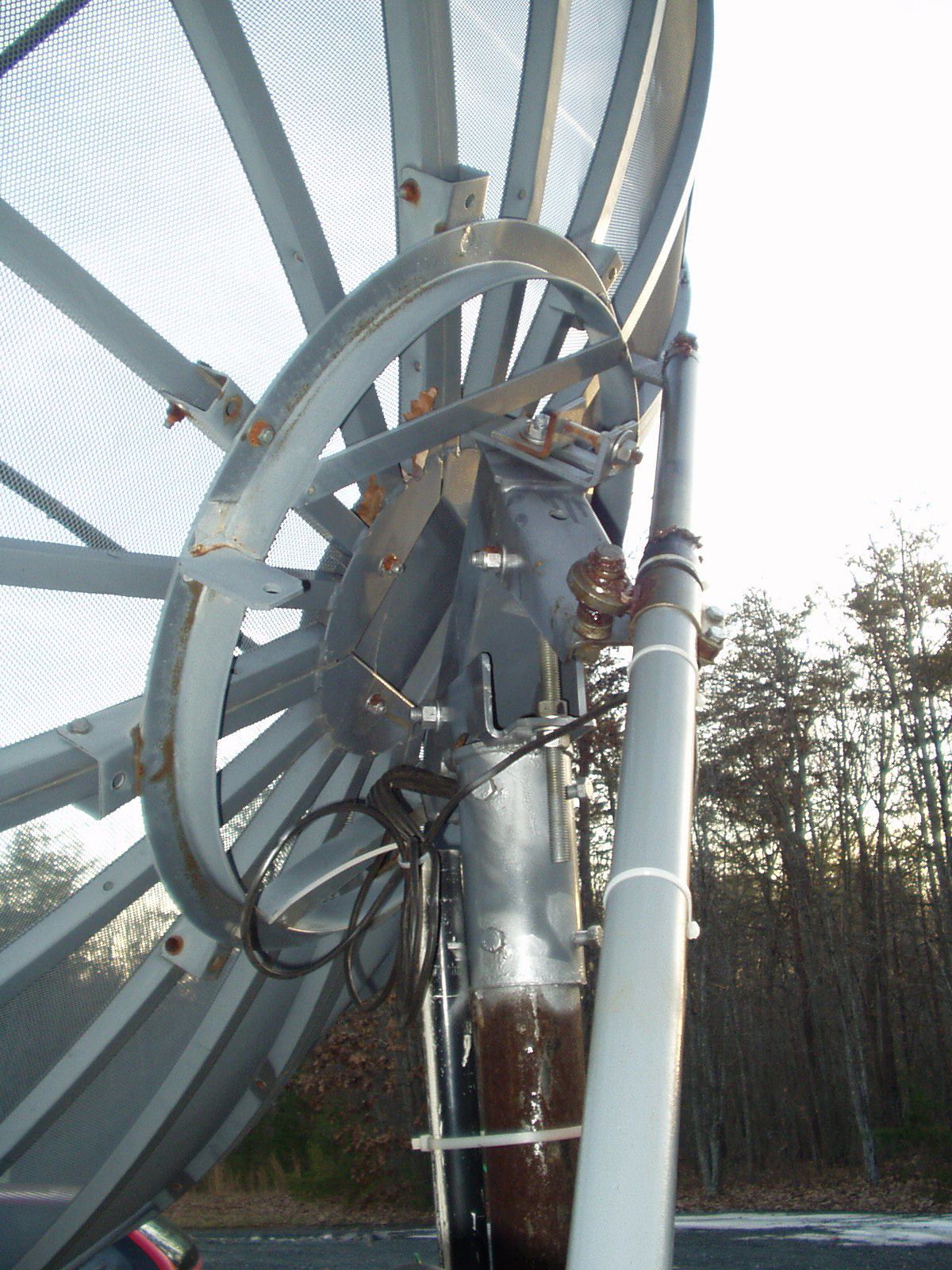

Don't know if a longer actuator would help or not as my 24" VonWeise isn't out of stroke when it hits mechanical limits of the polar mount. Here's a couple of pics of my dish at both ends of travel. The one looking left is on 37W and the other looking right is on 139W. If I go much further East with it the stud on the declination adjustment, which I already cut off BTW, will hit the actuator.
