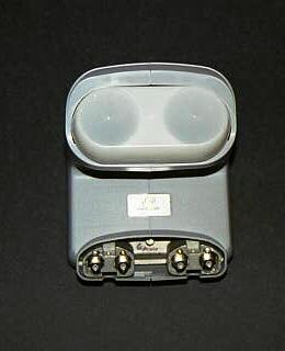

Thanks Iceberg, this helps a lot. I was using the wrong terminology and it was confusing me. I have a Dish 500 Twin LNB. When I was saying 'dual' I meant it had 2 LNB's in one assembly, but forgot about 'dual lnb' meant something else.
Below is the Twin...the dual is 1/2 the size
The Twin has a diseqc (sort of...dish's proprietary switching) switch in it. You **Might** be able to use it for 119 if you hook the left (if looking at the LNB coax connections) coax to a diseqc...but with those Twins it can screw up

Yeah, the Twin is definately what I have. For some reason I thought there was only 2 outputs on it, not 4, but I haven't been able to get up on my roof and check it out. I will tomorrow, though. I also, have another old D. Network dish that has a dual LNB, so maybe I'll swap the two if the twin doesn't work. Tomorrow I should be able to get all this figured out! Now.....if only I could somehow make today go by a little faster....

Those two-satellite Dish LNBs come in a number of versions.
And, they may have two, three, or four coax connectors.
More importantly, they may come in regular, dishPro, or dishProPlus versions
Without knowing which you have, it's hard to give advice on how to use it.
But, if you can find the connector that puts out the 119° signal by default...
... withOUT any switch commands, you might be good to go.

You can tell by looking at the D-500 dish:
- two independent one-bird LNBs
(very old, useful, what's called Legacy)
- double bird LNB, no apparent markings (ignore the molding on the front side)
(old, useful, legacy switch you probably cannot control. 2 or 4 coax connectors)
- double bird LNB, with big "dp" sticker on front side (Dish Pro)
(newish, useful, bandstacked. 2 or 4 coax connectors)
- double bird LNB, with "dpp" sticker on front side (Dish Pro Plus)
(newest, maybe useful, draws lots of current, THREE connectors - one is input for expansion)
All the Dish Pro or Dish Pro Plus respond to diseqc commands.
If you plug into the correct connector, and do NOT command the units, you can probably get by just fine.
