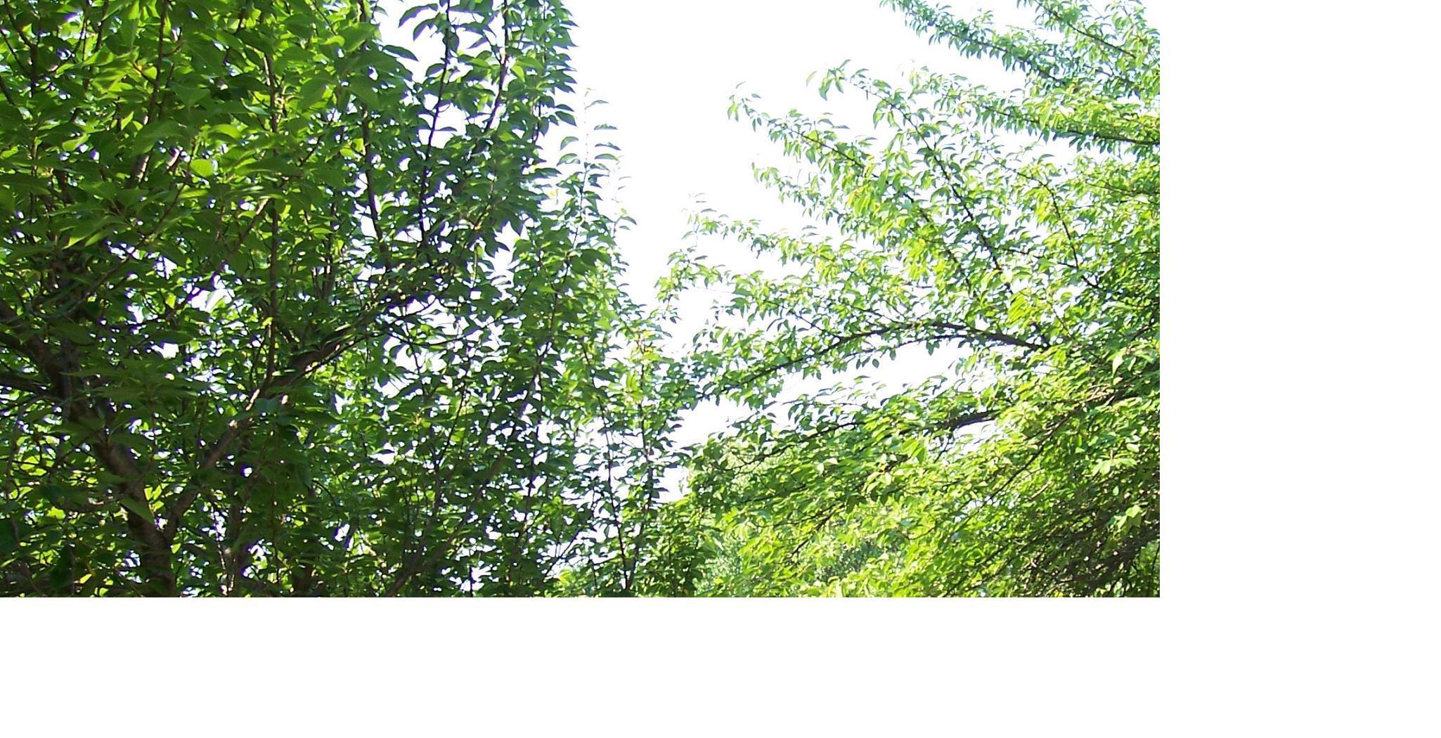

Ihave since trimmed some of the branches since this photo, but I get signals on all 5 sats in the 90's, with a couple 100's. I assume the signal is probably from much higher up than it looks, or I'm very lucky!

I have two H20's and they are both correctly set. To reinforce that point I get the 499 message searching for sat. signal. The point is that when I do a SS check I only get readings from 101(97%), 110(95%) and 119(98%) sat.'s respectively. The other sat.'s read zero. I don't understand WHY are you getting those readings on the inactive sat.'s...
