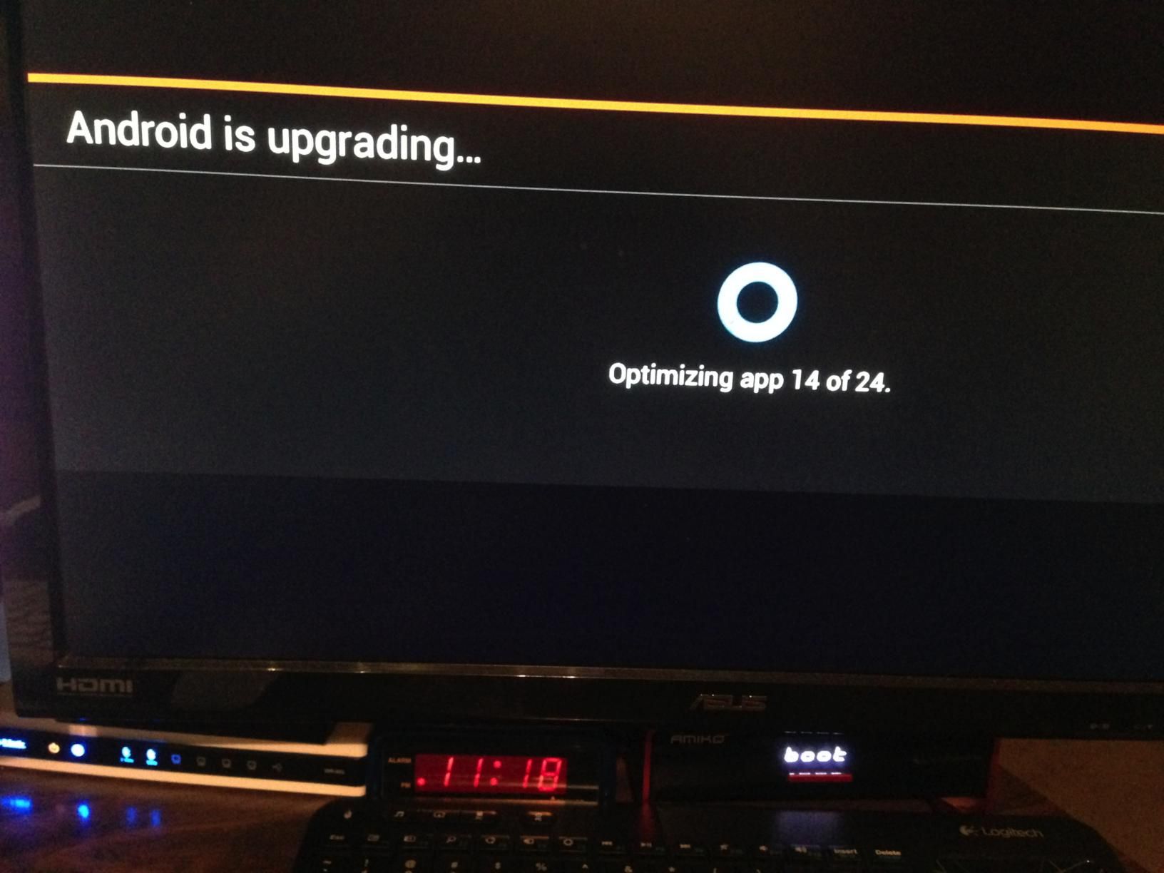

I was copying recordings from my A3 into my Mac and I got a popup on my Mac that the connection had been broken. I looked at the A3 noticed it was completely locked up and unresponsive.
There was nothing I could do except pull the power cord.
When I plugged it back in it began to boot and then it came up with the screen below, saying that "Android is upgrading".
It has been stuck on "Optimizing app 14 of 24" for half an hour and is again unresponsive BUT the little animated activity circle is still animated.
I do not want this thing (or anything) to automatically "upgrade" anything at all without my approval first. I was not signed in to any google accounts or the play store, I thought that by being signed out it wouldn't update anything.
But I guess the operating system does whatever it wants.
Is there a way to block this thing from accessing the internet completely but still be available to my Macs on my home network?

The easiest way to block access to a domain name it is to blank out the DNS 0.0.0.0 in the nework settings, or put a fake internal IP for the DNS - like 192.168.1.99, assuming your router/gateway is something else than that. You likely have to change the A3 IP address to static IP to change the DNS, but not always.
Reactions: Titanium
It would actually be more effective to just set the gateway address to the IP of the box. Turning off DNS will still allow access by IP Address, whereas setting the gateway address to the local IP will allow it to access everything on the local network but not access the internet. Also, in this case the DNS should be set to the address of the router.
So in the network settings:
IP: static IP on the local network, such as 192.168.1.127
Gateway: same as static IP
DNS: Address of router

Thank you for the ideas on how to restrict this thing.
I continue to have many problems with it and I have to pull the power cord 2-3 times a week, sometimes 5-10 times a day.
It seems to do whatever it wants to do or not do what it should do. I'm not going to complain about the problems because I'll just be called an idiot, again.

DeeAnn, No one has ever called you stupid. EVER!!! EVER!!! EVER!!!
Yes, we suggest that you read/follow instructions.... but that is addressing being stubborn, not stupid!
Once again I am going to suggest (and this time even beg of you) to PLEASE set-up a RMA to get this resolved once and for all! You spend soooooo much energy and time talking about what is happening and what you hate than the few minutes that would take fill out a RMA and send it in to Amiko Americas. :(
I have an A3 on 24/7 and DVR about 6 hours each day and media center music and Kodi. The only times that it gets power cycled is after I manually update to latest firmware. It does not force an update or lock-up. I am not the only one that has this positive, rosy experience! Maybe some members will back me up on this!
Would you PLEASE RMA your A3? PLEASE???
Reactions: primestar31
I have never had my A3 auto-update itself, or force ads on me for that matter. I thought I had it lockup once, but I found out later all I needed to do was wait a little longer, as it was actually doing something, but taking much longer than normal.
I did have the epg stop working properly when I was playing with it trying to add a channel, but I got that resolved by downloading the latest US sat list, and rescanning.

DeeAnn just get it replaced, even the best swimmers drown, looks like you have gotten one with some issue.
BTW, mine is one of the first batch the same yours came out of. :)
I've got two A3s. The oldest one is from the original shipment and I received it on August 18th of last year. Neither of them has ever performed an automatic firmware update. I've had to specifically select the menu options to upgrade each time. They are both used every day but don't usually stay on all the time. They are by no means perfect and there are many things they may not do but I'm very satisfied with them.
