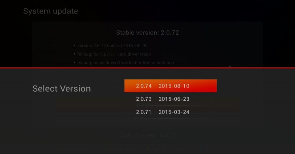

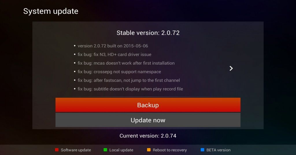

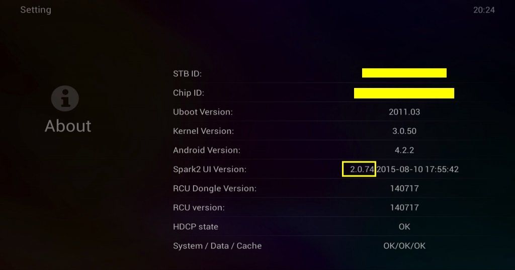

After many months of pure grief, this thing has finally decided to behave.
In a last ditch effort I updated it to the beta software 2.0.74 version then ran the Eurotrash fix on it.
It's been working perfectly for almost a week without any problems at all. Not a one. No flakey video wigging out, no lock ups, no freezing.
I haven't had to reboot it once. It's been recording every day, several times a day.

Mine worked fine on 2.0.73 for two weeks, then when it inevitably crashed, upon rebooting (twice, as usual!) it would only last a few days just like the old version. I upgraded to 2.0.74 and it locked up within an hour and a half, after that it went about a week before locking up again.
