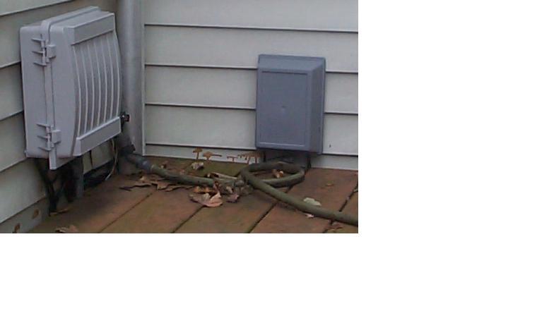

Amusing D* upgrade
V, I and a number of others have joked in the past about D* doing stuff on purpose to "mess with your mind" because of your generally negative attitude(s) about them but (if this picture is real), I'm now convinced that they really are messing with you.
Call them and have them come back out and do the job right.
Its real. Its no bg deal really, I will fix it. Funny how it seems to happen to me though. You know what is eve stranger? Last year I got my HR20-100 and they day D* showed up the AC broke the night before.... The other day when I got the HR21 installed, again the AC broke the night before. I guess if I want air conditioning I need to keep D* away.
Maybe you should try not to call them in the summer :D

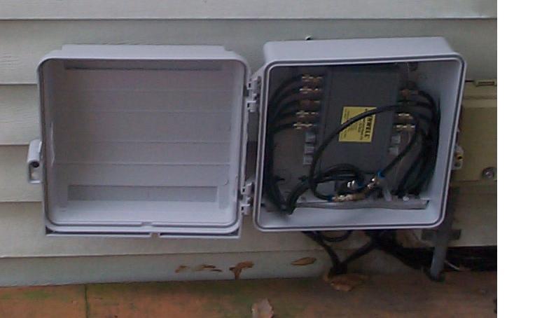

anyone have a source for a box for this thing. Plenty of metal and PVC type electrical boxes around but I have yet to find a plastic one with a quickly removeable cover like the cable box. Say 10x 10 x 4 or 12 x 12 x 4 ??
Yeah that 10x 10 one looks like it will work. They had 10 x 10 at HomeDepot and Lowes but they were electrial JB's grey PVC and you needed to remove 4 screws with a driver to open them. Thanks charper.
PS 12 x 12 would be better, then I think I could fit in the internet cable connection too and eliminate the cable co's box.

LMAO. Its a small 10 dollar plastic box. I found it on the net, the exact same one. The cable co. was the one that started using a zip tie as a lock on the bottom.
correct instalation practice for an exposed multiswitch include correct drip loops, ports pointing horizontally, ports fitted with weather bootgs and/or dielectric grease , open ports terminated, and all fittins torqued to 30 inch pounds.
The proper practice for installing an exposed ground block or multiswitch include correct drip loops, ports aligned horizontally, weather boots or dielectric grease used for weatherproof connections, open ports terminated, and all fittings torqued to 30 inch pounds. Your upgrade would fail a QC without even looking inside that box, sadly to say...
Here the one I installed, actually two including a relocated/replaced cable box for internet service.
all open ports where capped.
