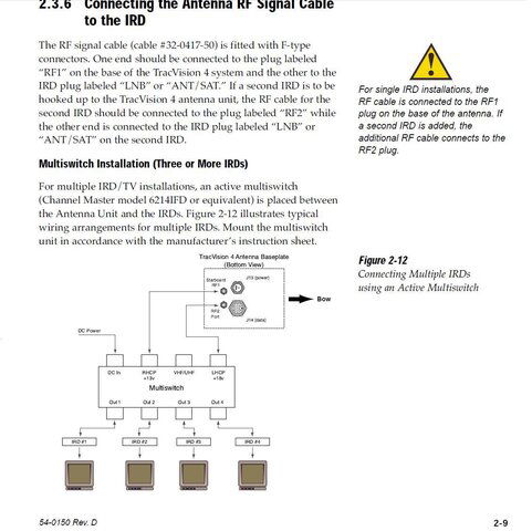

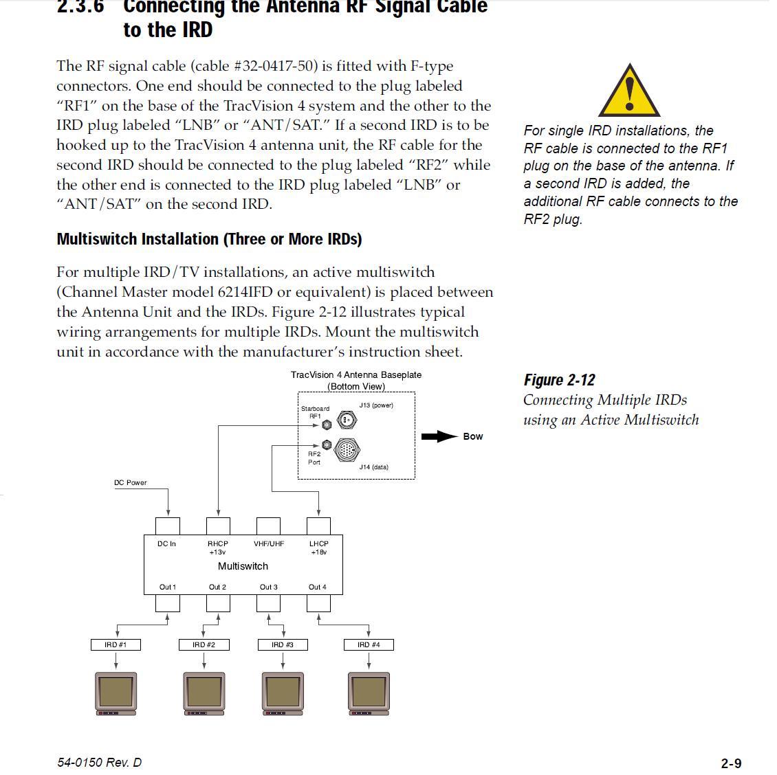

So I am at a loss. I have attached a diagram from the KVH manual and the cable boxes in the house are model H25-700. I hooked one of the H25s up to an output port on the CableMaster multi-switch as shown in the attached diagram. I played with it all day yesterday to no avail. Had the multi-meter out testing voltage on the antenna and multi-switch trying to the forum here for advice.

I'm of little help here but the H25 is SWM only. I'd advice getting just standard receiver and using it. Converting that to SWM sounds kind of a PINA
:welcome to Satelliteguys mrdeepseafisher!
Like Hutch said, the H25s are swm only, so you either have to get boxes that work with a non swm setup or convert what you have to swm. You would need to connect two cables from the KVH to a swm8 multiswitch and power that switch with a 29 volt power inserter.

Just my opinion, but, I would NOT go the SWM route, not even sure if the KVH can be adapted to work with a SWM.
I would try using any boxes you may have already that are NOT SWM's and see how that set up works.
Jimbo, if he doesn't go the swm route he would have to get five new boxes since all he has are swm only. That's a big expense, more than getting a swm8 and a PI29.

Just a little update and more help needed. I have been working with the KVH company (great technical support) and Direct TV (they suck). I found out that the model KVH dish I have can be convert to work with a SWM. KVH sells a kit for $450.00 to do this. The KVH guy was very helpful and offered to send me the install manual and tech specs so I could order from a local KVH distributor. Got the document and by reading all your helpful comments here figured out that I could buy one off Ebay. Bought one from Ebay for 29.00 with 29V power injector. Made all cables and have been testing it today.
Crap still doesn't work! After talking to Direct TV today, it seems that the customer support person that helped me a few weeks ago saying that my H25-700 boxes would work with a non-HD antenna. Apparently this is not the case. After talking with the KVH person today and on the phone again a few minutes ago with Direct TV person I cannot use the H25 boxes with a non-HD antenna.

First off, we told you that an H25 is a swm only box and won't work in a non swm setup. Second, how are you converting the non swm dish to a swm setup? It shouldn't cost you anywhere near $450.
As I read the post the OP has bought an SWM8 multiswitch and a power inserter so the dish is effectively converted to SWM. The H25 will work fine with this setup, but will only get SD channels (because the dish will only get SD)

The documentation I have says that the external SWiM switchgear is not compatible with old school (pre-legacy) DIRECTV technology.
Bear in mind that we're not talking about a Phase III dish with four outputs but a hardware and software simulated Phase III dish with only two outputs.
True, but $450 for a swm8 setup is WAY too much. Since it SHOULD work, I was asking how he was converting the sd setup to swm.
You're ignoring the fact that the OP is talking about an in-motion antenna that emulates a Phase III dish and has only two outputs. Conversion to SWiM is absolutely NOT trivial when you're not using a Ka/Ku LNB and surely can't be done with off-the-shelf hardware.
The obvious (and cheapest) answer lies in using anything other than an H25 or a Genie with the existing antenna. This includes DIRECTV receivers from waaaaay back when they were all owned (if the boat is the only place it will be used).
The SWM8 works fine with two connections to an 18in round dish....
Your documentation is wrong.
