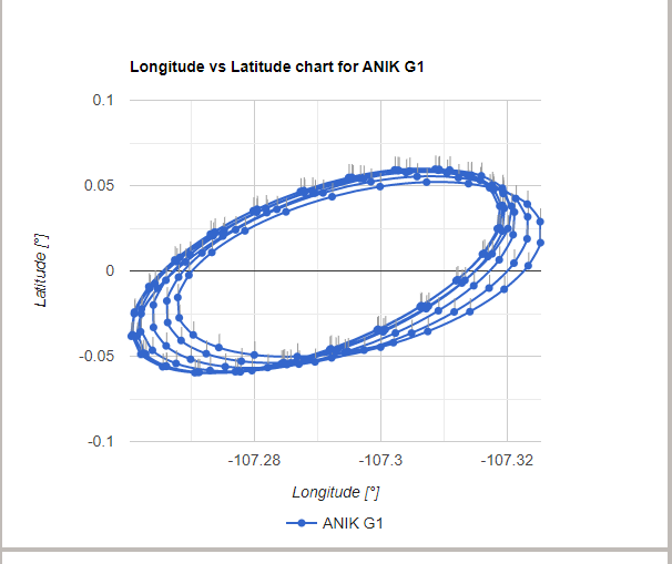

Anik F2 is definitely operating in an inclined orbit.
Source: satellite-calculations.com
Reactions: c-spand
From the graphs you provided, it looks like the current cuboid is +/- 0.25 degrees in latitude. Am I reading this wrong?
East/West does not increase much so it becomes more of north/south ellipsoid.
Been reading up on inclined and the North/ South deviation can get quite large as in multiple degrees, if the operator chooses to not control it..
The article says uncontrolled latitude increases 0.8 degree per year.
