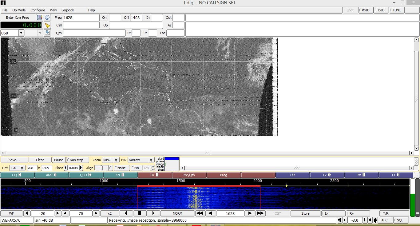

To my knowledge there's nothing on FTA for direct weather imagery via FTA satellites, but a good article by Ken Reitz was just published in this month's The Spectrum Monitor Magazine in his column "Radio 101" which discusses WXSAT imagery using NOAA LEO satellites. With a modest station you can pick up these images as the satellite is overhead. Currently there are three NOAA WXSATS to choose from. (In the interest of full disclosure I sometimes write for this magazine).
There are other ways to get satellite weather images, not directly from the satellite, but they are updated continuously via US Coast Guard stations that are available 24/7 on the HF (shortwave) band. All you need is an HF antenna, shortwave receiver, and a decoding program (free download) like MultiPSK or FLDigi. If you Google "Worldwide Marine Radio Facsimile Broadcast Schedules" it'll direct you to the NOAA site with all the schedules on HF. The transmissions of interest to you would be those described as "GOES IR Satellite Image." The nice thing about these is that depending on the station you tune to (e.g. New Orleans, Kodiak, Boston, Pt. Reyes, Honolulu) you'll get different images covering different areas. Attached is a partial GOES IR tropical satellite image from NMG, New Orleans, on 8.502 MHz at 1405Z gotten this morning. Band conditions dictate how well an image will be decoded.
This is an excellent post with great comments from forum members.

Wow this is great, so how expensive of a HF antenna do I need? I'm going to look into this option for sure, thanks so much for sharing.
