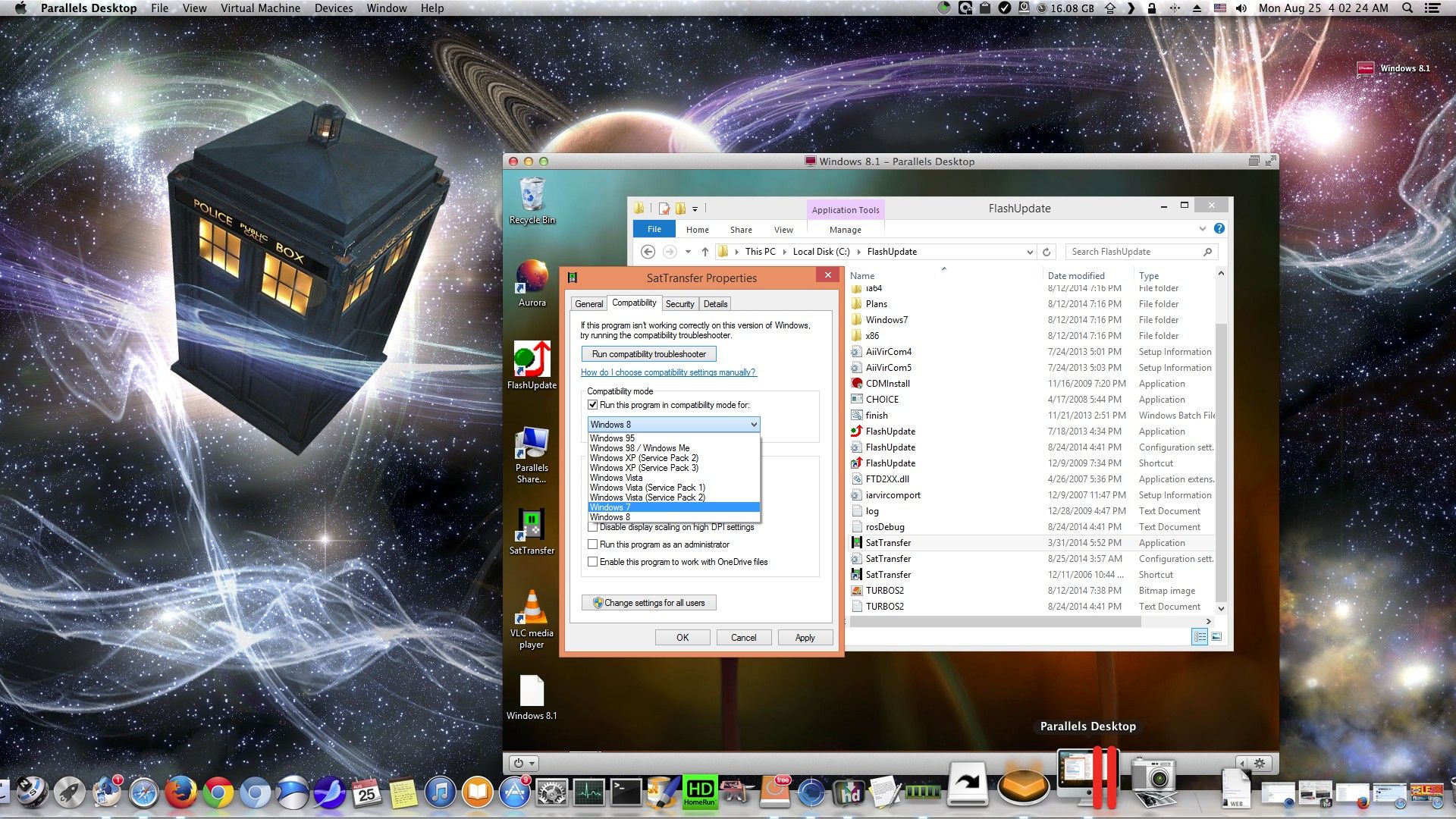

What about this? In the windows 8 explorer you can right click on an app and tell it to run as if it were on a windows 7 computer.
One thing that occurred to me, I still have the windows 7 disk that was used to setup my Home Theater PC. I could also install it under Parallels on my Mac. Then I could boot into which ever version I need.
If the ASC1 stuff can't be made to work on Windows 8 I can always install it under windows 7.

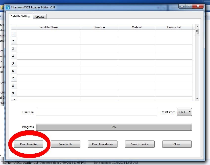

But, when I tried to use it for my ASC1, that's when things didn't go so great. At first when I plugged in the included USB to serial adapter it made the bonk-boink noise and it said it was installing drivers.
I loaded the ASC1 app and it saw the adapter as com4. There was a firmware update so I downloaded that and installed it to the ASC1. It completed without error.
I powered it off for like 2 minutes then back on. I told it to read the satellite list from the box into the laptop and it did, I saved it to disk but it was all pretty much blank except for two entries I had made manually on the box.

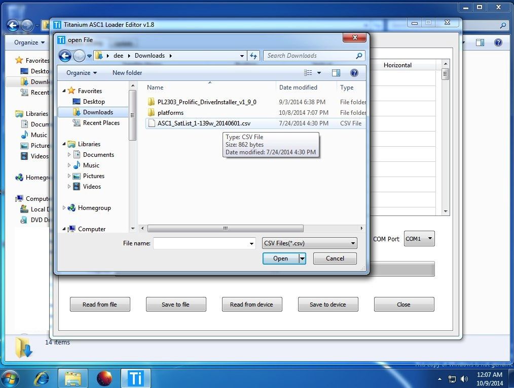

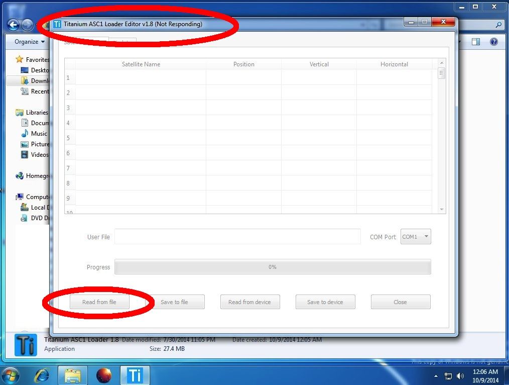

So then I tried to load from disk the "ASC1 North American Satellite List 1w-139w Zip File (.csv)" but then the app just locks up cold and stays locked up and dead to the world indefinitely. I let it sit for like 30 minutes to see if it would ever recover but it would not so I would have to kill the app and restart it. I can not, under any conditions, load the satellite list from disk into the app.
I tried doing the same thing on my HTPC which is also windows 7. I also tried it on windows 7 running as a virtual machine under Parallels on my Mac (OS X) and it behaves exactly the same way.
The laptop is brand new and has nothing on it except a new, clean copy of windows 7, there's nothing there that could or should be interfering with the laptop.
Just a note, ALL copies I've been using are 64 bit, if that makes any difference.
Anyway, after several failed attempts to load a file, then it began to tell me it couldn't find the com port when I would restart. I unplugged the adapter then plugged it back in and it made the bonk-boink noise then it started with boink-bonk and back and forth. The noises it makes when you plug and unplug stuff. And I wasn't even touching it. Finally it just quit completely.
