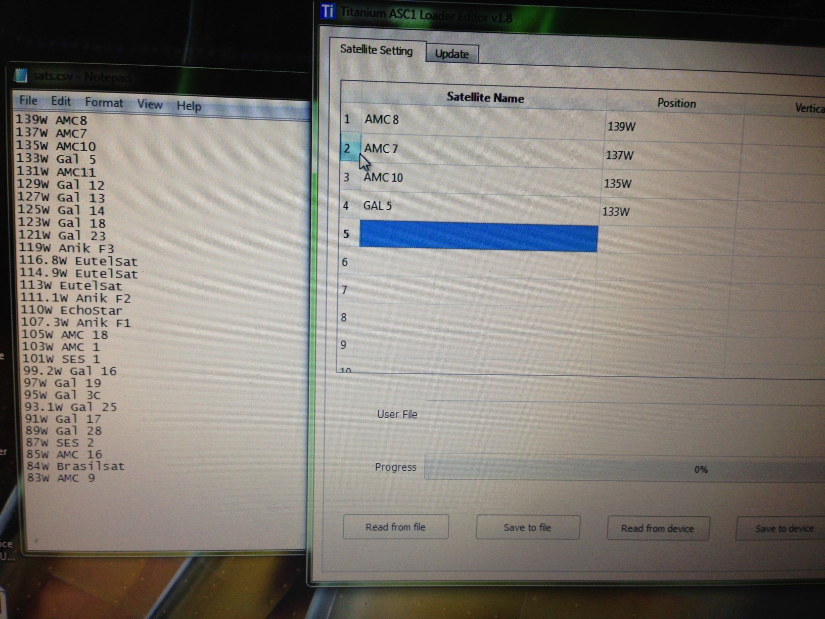

As to the file, I have downloaded a fresh copy and unzipped it to it's native format. When I try to open the file with the app the app locks up and I have to kill it, it will not recover on it's own.

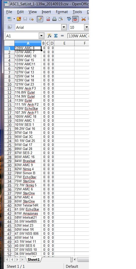

I used Apache Openoffice to view the file and I can see the satellite names and some other information.
I also opened the file with my text editor just to see that it doesn't have any foreign gibberish in it and it looks clean.
I can not see anything in the file, anything wrong with it that would make an app lock up.

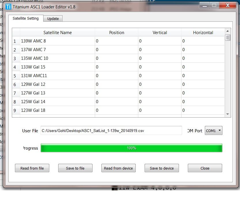

Oh and I also tried the older app, 1.6 version and same thing, totally locks up when I try to load the .csv file into it. On any computer, even a totally clean version of windows 7 running as a VM under Parallels on my Mac. Same exact behavior. I am completely baffled.
I give up. It will NOT load a file, period, at all. So I just opened the file in notepad and I'm duplicating it in the app by hand.

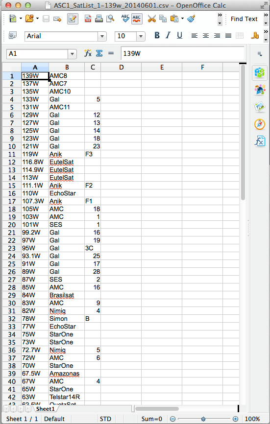

For giggles, I just downloaded and installed Loader/Editor version 1.8 and read the 1w-139w Satellite list file into the Loader/Editor on my home computer. Installs and loads fine. The Loader/Editor does not require a serial connection to run/load/edit/save. Just click OK when the window message states that no serial port found.

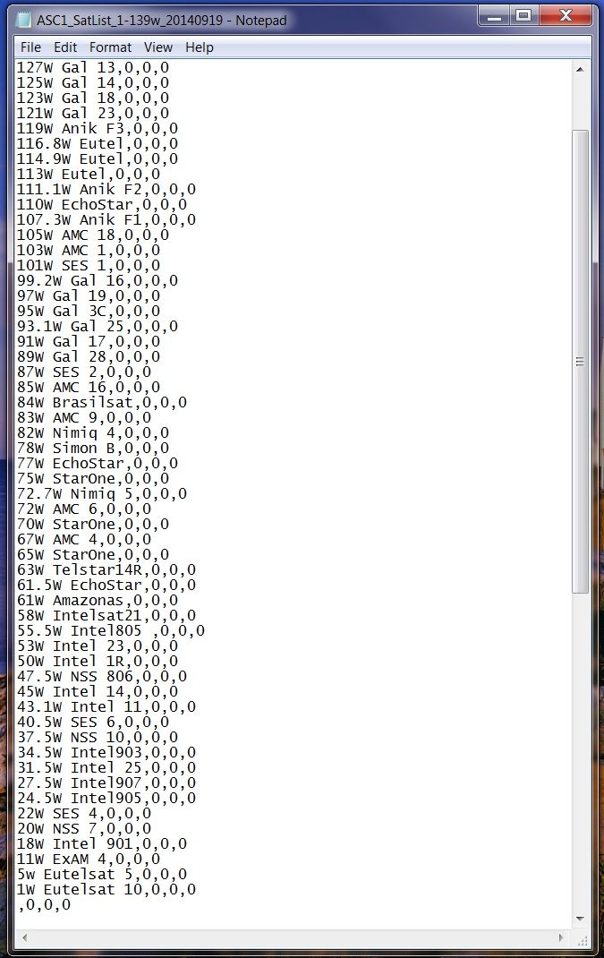

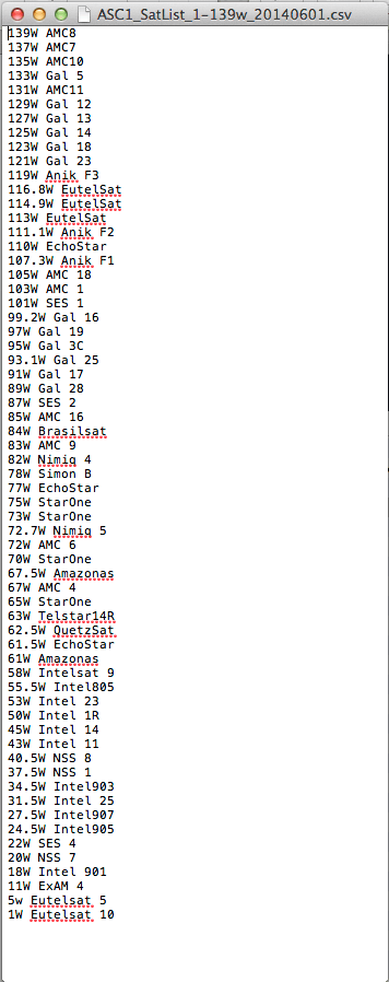

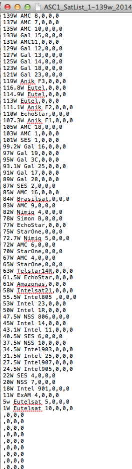

Remember that the Satellite List is a Comma Separated Value file. If you are opening the file like shown in your photos then saving it to be read by Loader/Editor 1.8, it isn't configured as .csv text anymore. See your photos compared to how the file actually looks and loads when downloaded. Your file is not loaded as comma separated values.
Here is what the Satellite List file looks like in OpenOffice, Notepad and Loader/Editor 1.8

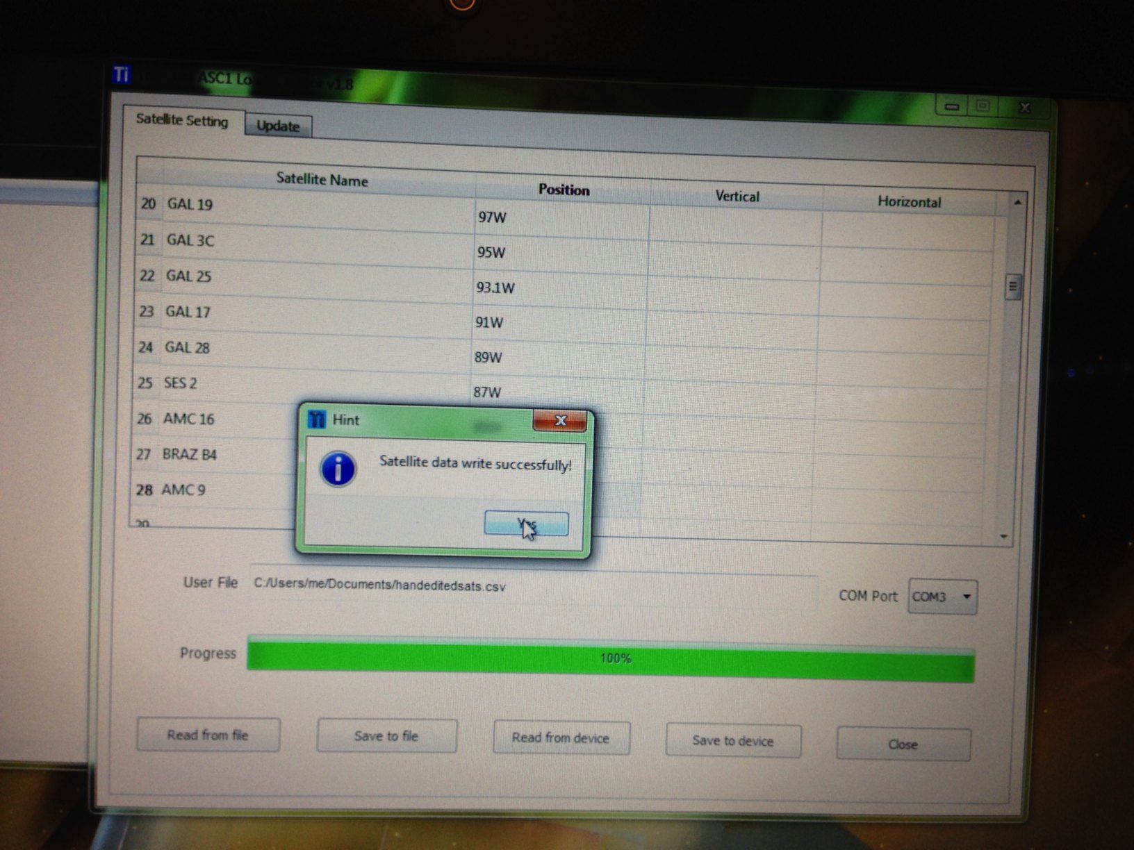

And here we go !!
I created a file within the app by hand and it uploaded into the ASC1 without error!
I saved it to disk, quit the app, restarted the app and loaded MY hand edited file into the app without error or locking up.
NOW it works perfectly !!
I would say that there is something wrong with the downloaded file that the app does not like.
Problem solved, I am happy !! :D
OH OH... I see what you are saying, that the file you are opening looks totally different than what I am seeing. SOMEHOW, the file is getting mangled when I extract it on my computers.
I can not explain how it's mangling the file, I have no clue at all but I can now see that there is something really messed up on my end.
Anyway, for now I've worked my way around it. I'll try a few different ways to extract the file and see if I can get it extracted properly.
Thanks! :)
EDIT: I just downloaded the file again and unzipped it on my Mac. I immediately opened it in my Mac text editor and this it what I see now.
This is the first time I've seen it with all the commas and zeros in it. Previously it only showed the positions and names, everything else was missing.
I'm baffled but now that I have this good version I'm going to upload it into the box and see if it will take.

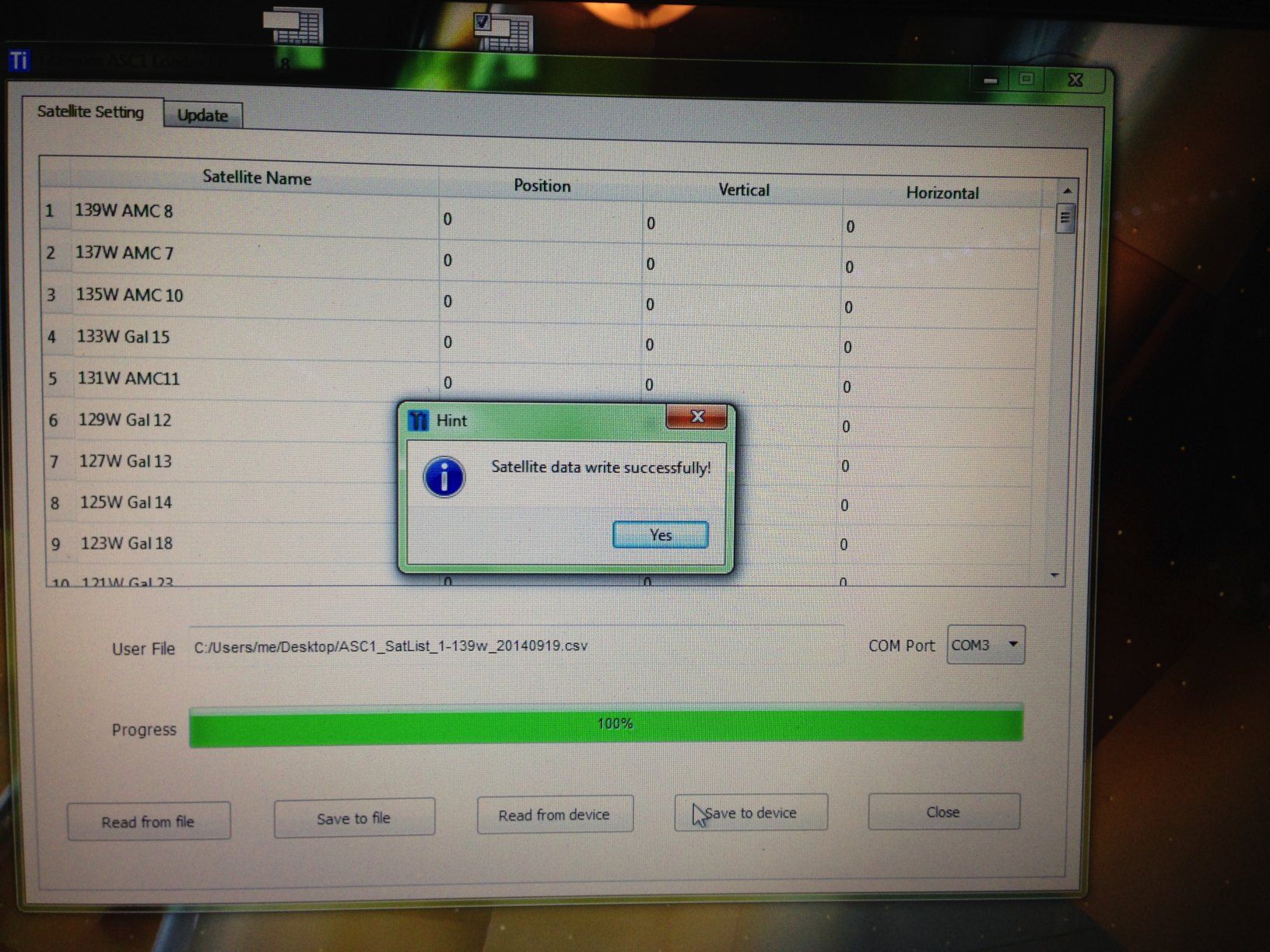

BINGO! 100% success !! :D
Ok, got to take the dogs out, back soon.. I'm in business now !
And there we go! 100% spot on, perfect performance exactly as advertised !

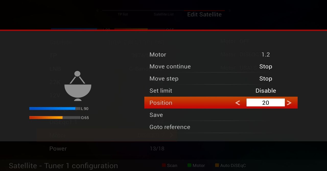

HOLY SMOKES! It was just toooooooooo stinkin easy to get my ASC1 to sync the position with the names! CRAZY EASY!!
I had previously found SES 1 and locked on it. After I uploaded the NA satellite list into it it then had all the proper names of all the satellites.

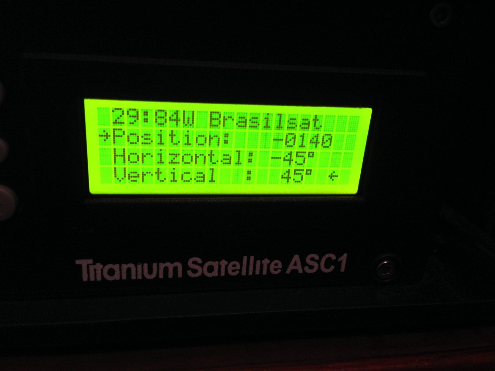

But it was showing that it was on position 28, Brasilsat or something to that effect, on the ASC1 display. Angst, gnashing of teeth, wringing of hands. What to do?!!
I went into my A3 and then under the advanced satellite setup I went to the diseqc menu for SES 1 then just changed the position from 28, I think that's what it had been on to a few different things then hit SAVE and it would change satellite names in the display of the ASC1. Trial and a few errors landed me on position 20 which brought it to reading SES 1 which is where it truly is aimed. I hit save and it's all done !
I was dreading a long, hard battle because I wasn't real clear on how to do this. Sometimes reading instructions just makes my brain turn to pudding. This was one of those times.
I am very smug and pleased that this thing is now 100% operational as it should be and that I have run my KU USALS ---> THROUGH the ASC1 and both motorized systems work perfectly without interfering with one another.
All on a single wire. And with an 8x1 switch out on the far end past the USALS motor, I can add more fixed dishes. Tomorrow I'm going to add a fixed dish for 103, since SES3 will happen the day Doctor Who lands the TARDIS in my backyard.
