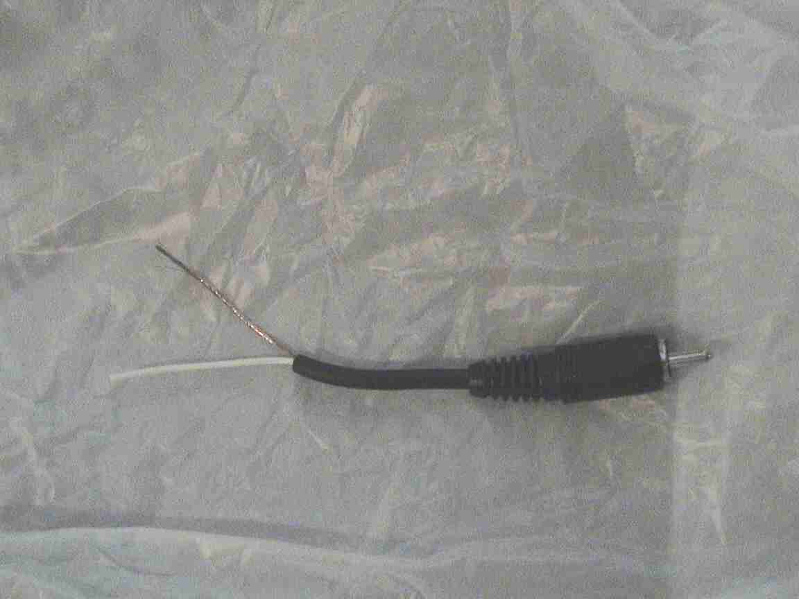

The Fan
my fan install
parts used
fan 80 x80x 25cm
RCA cable
Good 3M black electrical tape
velcro
peanuts shipping foam
dremel tool
_____________________
strip the RCA cable carefully(a first for me).
note one wire is bare inside.in pic 1 i have already rolled it up.
wire it to the fan(center red)
________________________________________________
cut a small slice out of the back of the unit with the dremel tool smooth as you can then add a piece of tape over it to keep wire from getting cut/sliced.
_________________________________________________________
used 2 peanuts shipping foam for the front feet with velcro to the fan. back of fan another piece of velcro to that rubber post (make sure to stay below this rubber post or the lid won't fit)and a very small piece on the heat sink.this keeps the fan from hitting the heat sink. i had to cut the one pictured in half or less . it was hitting the fan. forgot to get a pic of that.
to get power to the fan
setting>tv channels>dvbs>antenna setup>0/12v switch>to the RIGHT 12v
it works to the left did not test but guess it reverse the polarity.
now this power to the fan must be done on every sat or it will not work.
nice of the AZ people to have this power plug good idea.
that fan moves some air now my AZ is chillin.
