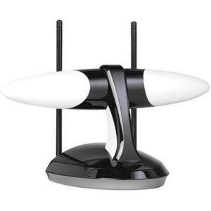

I live on the southwest corner of the building. My balcony faces west. Most of my signals are coming from the southeast.
I tried moving my antenna from my living room (the balcony is off the living room) to the corner bedroom, which has a windows facing south and west. The south window gives me a straight shot southeast. Unfortunately, my signal for PBS, channel 25 (11.0 miles away, but has a notoriously weak signal), was about the same as it was in my living room. I suspect that whatever increase in signal strength I acheived from antenna placement was offset by having a 100 foot wire from the Terk TV20 to the HDTV.

I just put an Antennas Direct DB2 on my balcony. It's a huge improvement over my Terk TV20. I now get additional channels, the channels I already got come in better, and I don't have to turn the antenna when I change channels. Also, their customer service people are superb. Thanks.
I use a small Silver Sensor antenna that sits right on the box and I get amazing results.
