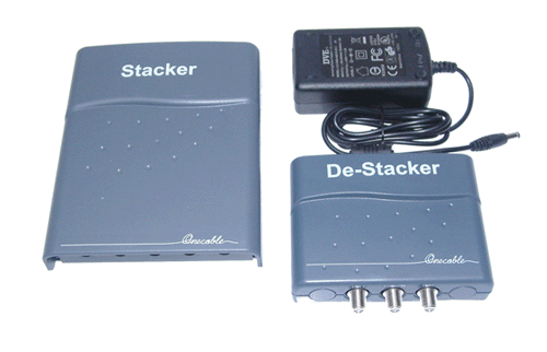

The best solution is to use a "STACKER" & "De-STACKER" set.
Dual LNBF 1
[4x2 Multi-Switch] == Dual LNBF 2
STACKER
De-STACKER ----- Rec 2
Rec 1
Both receivers in this case will have access to both dishes (and both polarities) independently.
