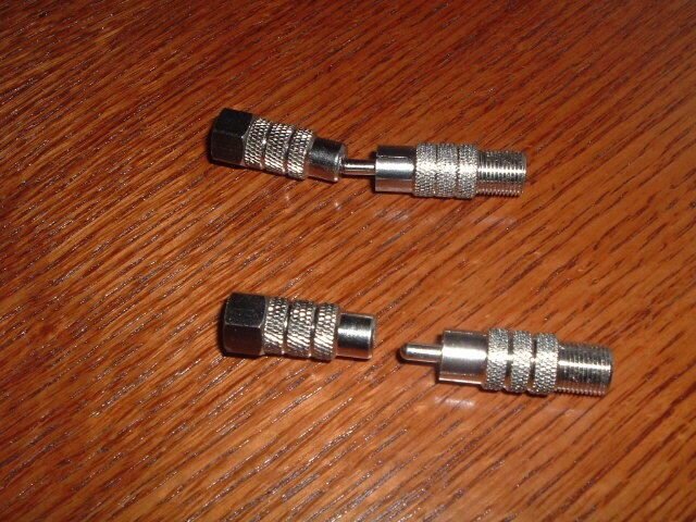

Another Solution
Here is another solution, it is a male F connector with a female RCA connector to go on the birdog and a female F connector with a male RCA connector that goes on the cable. Then you just push and pull the cable connection on and off. See photo. If you would like the pair of connector PM me with your name and address I will mail it out to you.
