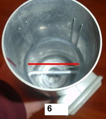

Your Skew is probably off.
Put your Dish at True South, take the cap off the Feedhorn, stand behind the Dish and look into the Feed.
You should see a 1/4" metal bar running Horizontal.
Also, the "box" on the side of the Feed should be "pointing" to 6 o'clock.
moved the dish to 95*, rotated the LNB
if the skew bar is horizontal the "box" does not point to 6'oclock, it points to either 3 o'clock or 9 o'clock, I am guess that it is more important that the skew bar is horizontal?
Here is what mine looks like if I was looking from behind the Dish.
adjusted so that the 'skew bar' is horizontal and the box is pointed as shown...
scanning the digital skies again...:)
thanks for the help!!
