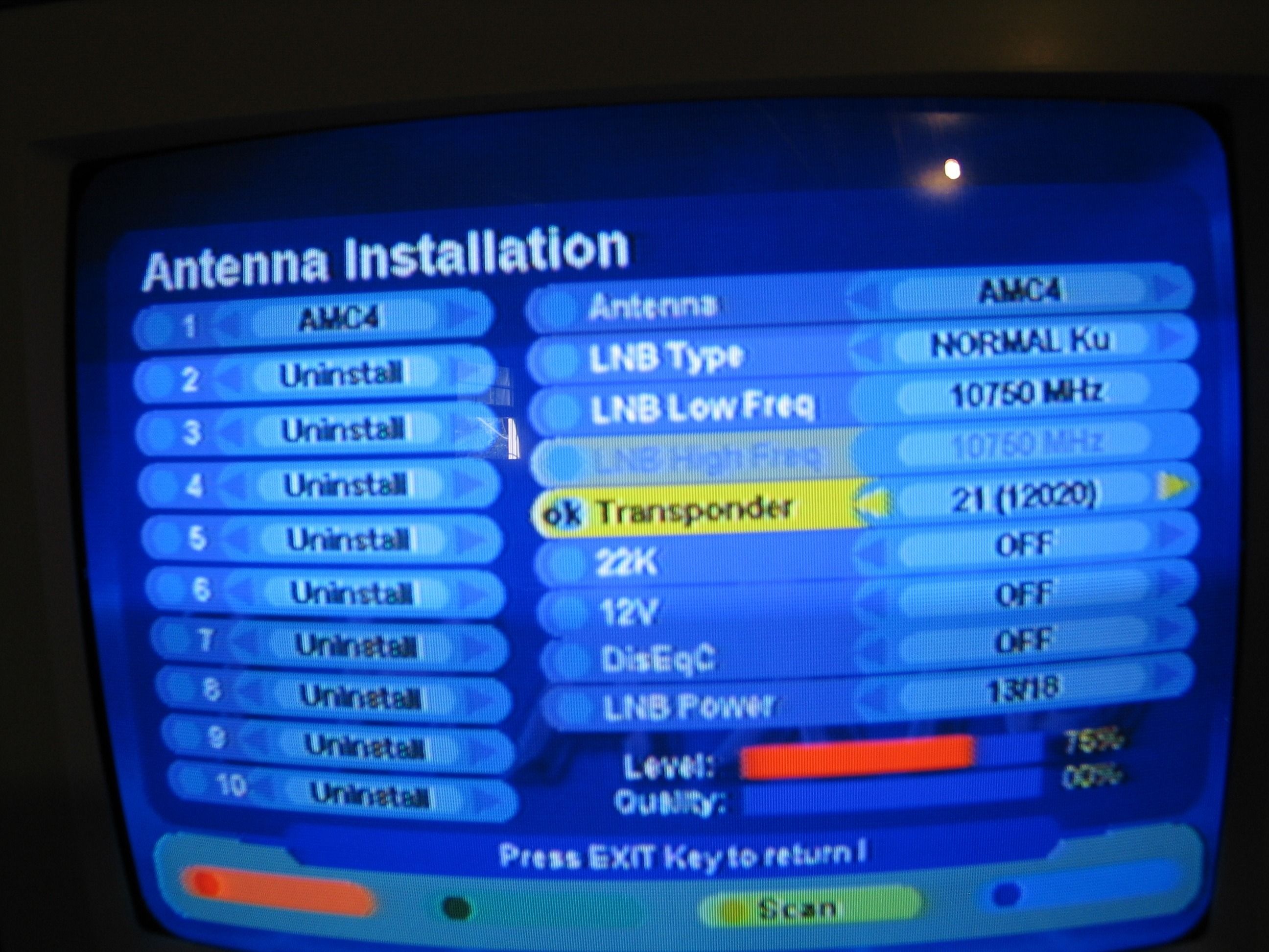

My better half just sent me a picture of the television screen and here are the numbers:
LBN Type: Normal KU
LBN Low frequency: 10750 Mhz
Transponder: 21 (12020)
22k: Off
12V: Off
DisEqC: Off
LBN Power: 13/18
The Transponder 21 comes from the Lynsat website and BVN Website. However I did notice that it says 12120 instead of 12020 so I tryed to change but I still did not get any quality. The funny thing is that transponder 24 has the correct value 12120. Not sure what how to approach that. I attached the screen picture.

other than the transponder being wrong the rest of the screen looks fine
turbosat posted the correct transponder info :)

The thing I don’t understand is the transponder manager on the receiver. What ever I do I can’t get transponder 21 on the correct settings. I change it, I save it, it even gives me a warning that I changed it but when I go back to the antenna set up it lost it.
21 is set to 12020 and should be 12120 for AMC4. So back in the antenna menu I choose transponder 24 as that has the correct settings. Is that an issue?

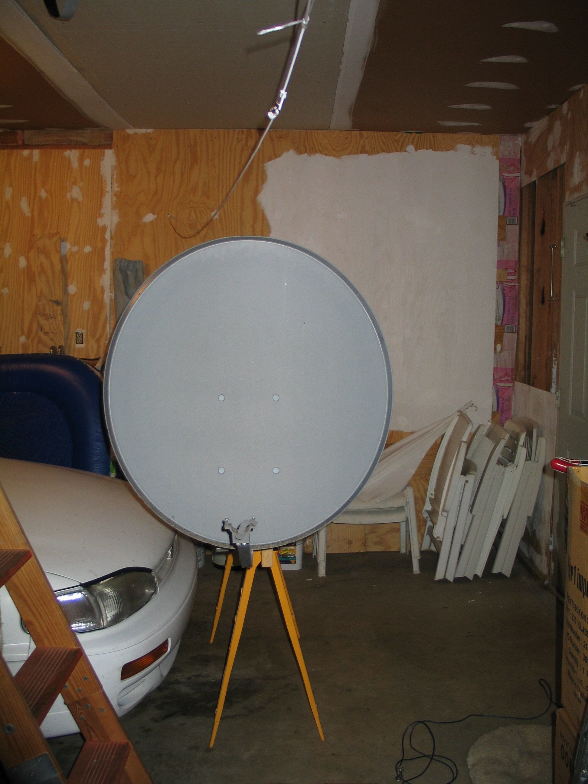

Why not try another sat or two, on each side of AMC4, see if you get anything. Surely that tree wouldnt' have you blocked very far unless you're right under it. 30yards or so worth of cable is not going to hurt your signal, most of mine are 125' from the house. Post a pic of your dish from the front , if you can, we'll figure out then what kind of lnb you got, or need maybe.

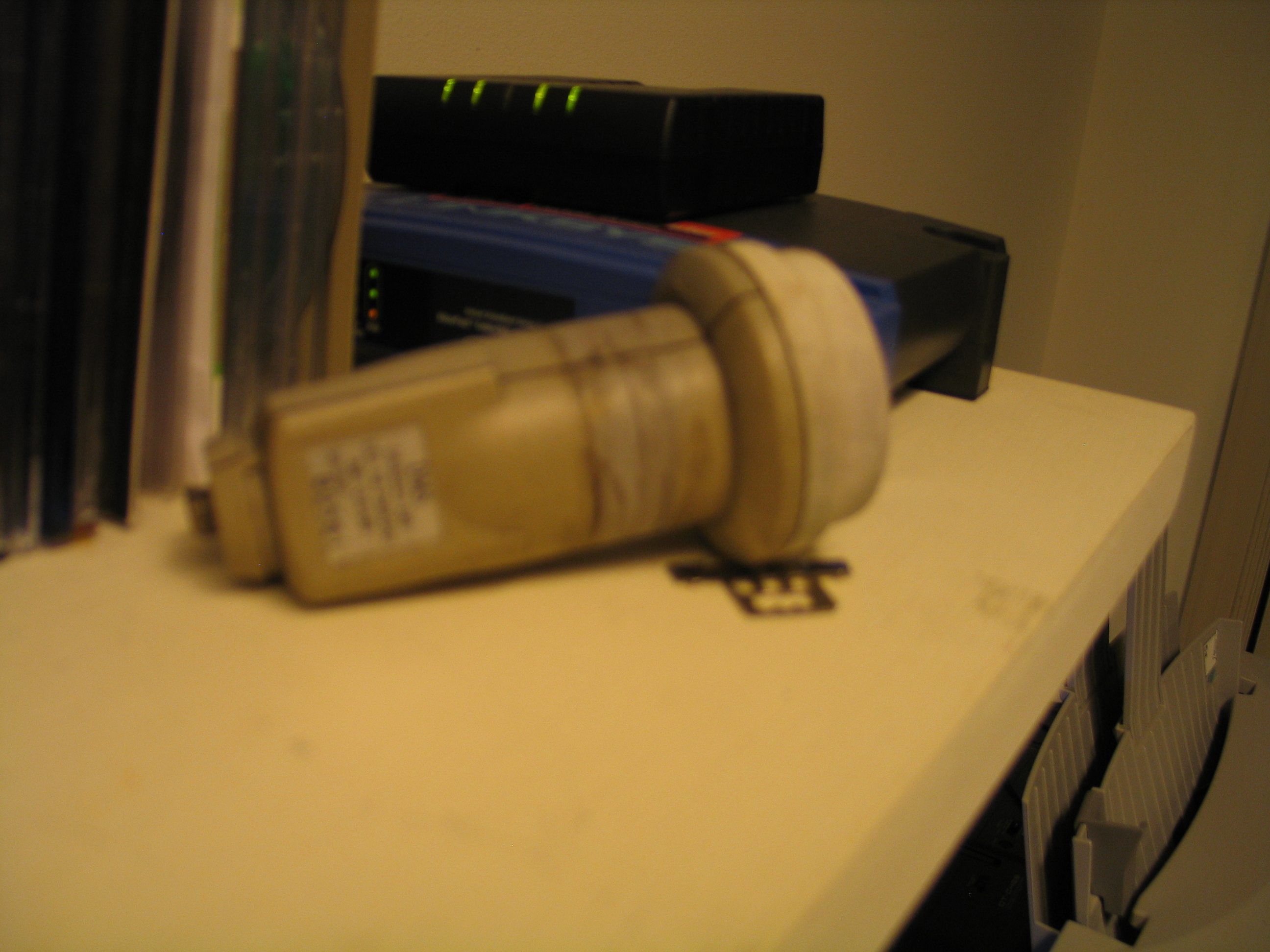

The Dish itself does not have a brand name or something its 84 x 77 cm. I believe its off-set as it does not look 30 degrees when you put it in 30 degrees. Almost looks like its 5 to 10 degrees up. The LNB has a label this is what it says.
DMS
DVB321-SB
LO: 10.750 GHz
NF: 0.6 dB
S/N: 3B20
00581
I attached a picture as it is mounted now in a saw-horse to make it mobile.

Looks like a winegard dish
its offset so it will look like its aimed really low but will work just fine. The signal comes in 22-25 degrees higher than what the dish looks like
Those are pretty good little lnbfs, I have 2-3 of them for spares, one in use on a 1m. Once you find the right spot that gives you the clear line of sight, you should get great video from AMC4.
I would enter all the active TPs in your 2500, from The List, or at least one V and one H transponder, then keep at it.
