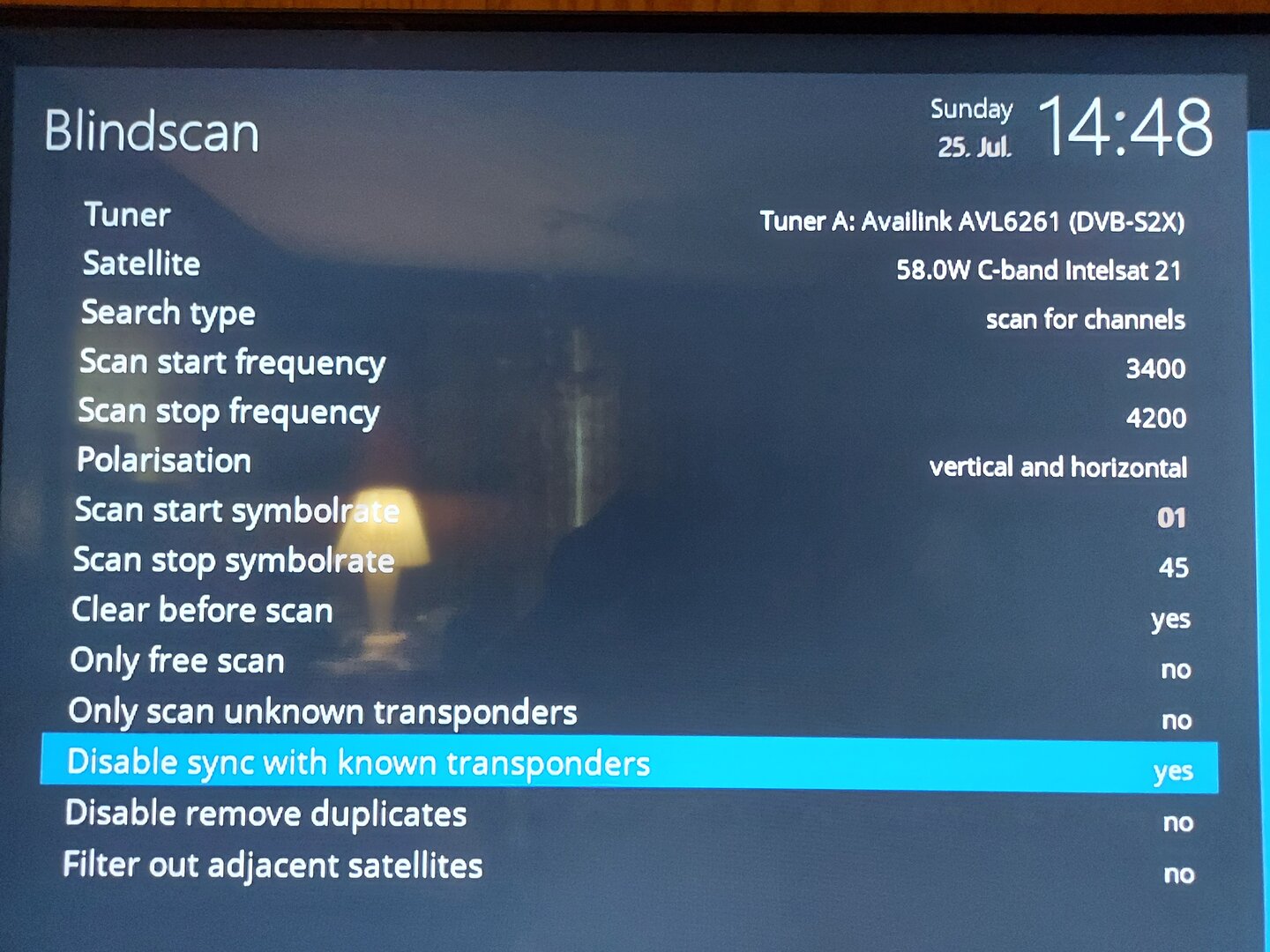

A little later on slot 2 with my new openATV 7.0 install. Yeah. I know. It's a beta. But what the hay, bells and whistles running after a little trial and error...and coffee!
Okay. So I have 58 zeroed in as strong as it gets. ASC-1 position stored.
Bump the dish West until I get signal loss on the banner. 10 clicks did it.
Go to blind scan. Look at photo a. Note: I did change 3400 to 3000 because I have a wideband LNBF.
Scan1. Still picking up 58 W channels/transponders. Bump 10 clicks West. Blindscan for channels again. Channels! Not tp's.
Nothing. Nada. Dead.

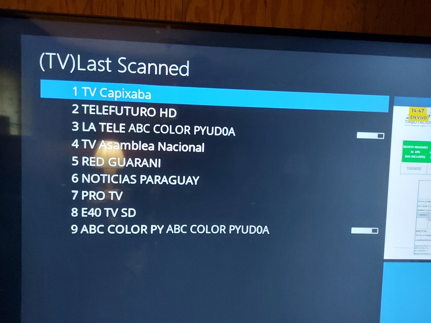

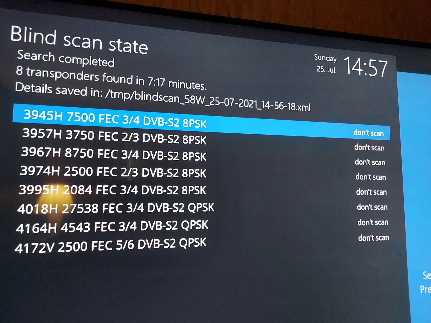

Another 10 clicks West on the ASC1. Blindscan channels again. Look at pic B.
In my Last Scanned boo-kay I click on a channel and peak for signal on my beloved transformer varnish stinky boat anchor the ASC-1. So. Who is this guy?
TVROSAT...search for channels. Nope. Lyngsat, Satbeams? Nope not really up front.
Google? Search <insert channel here + "satellite">.
Bang. A couple of results show 61 West Amazonas 2/Amazonas 3. Must be it.
